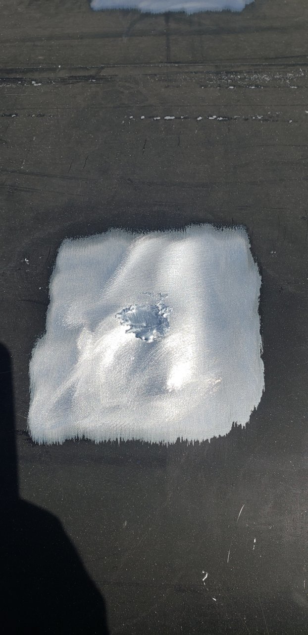

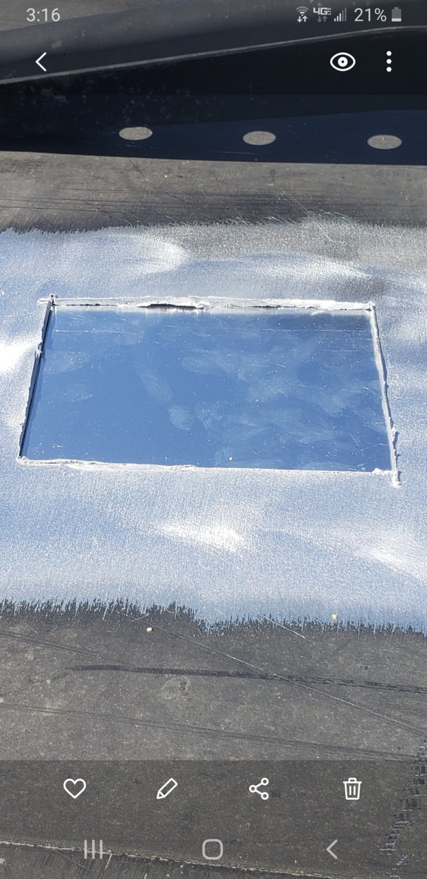

    I bought a torch and some alumiweld. I plan to get the six drill holes on the roof of the shell filled in next week when I start my 6 off.

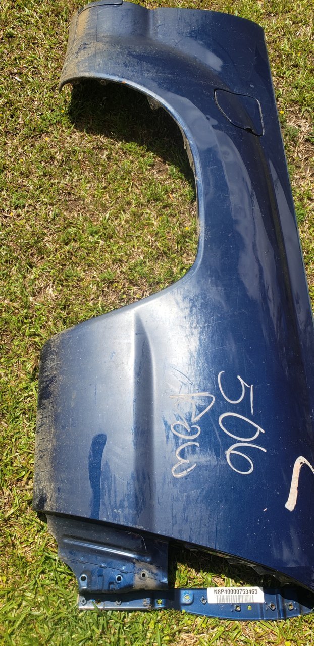

    Got the cab side header rail from @HAVOC today. I put it on when I woke up. Tomorrow's goal is to get the 6 holes in the roof grazed in. No pic since it's dark....and everyone knows what it looks like anyway :rofl:

  15. Apr 10, 2020 at 5:52 AM
    #95
    gixxerphil
    gixxerphil [OP] @concretelander
    Mar 31, 2018
    #249012
    23,250
    Phillip
    Auburn, Alabama
    2013 DCLB

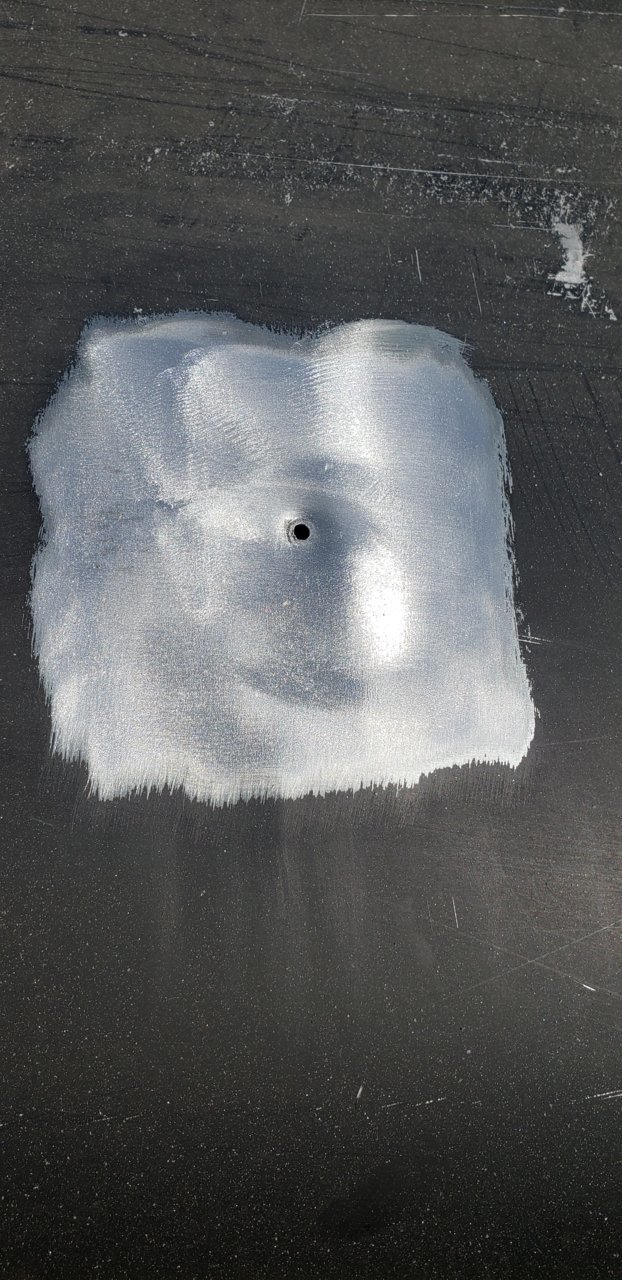

    Getting the holes prepped.

  16. Apr 10, 2020 at 9:28 AM
    #96
    gixxerphil
    Mar 31, 2018
    #249012
    23,250
    Phillip
    Auburn, Alabama
    2013 DCLB
    It ain't pretty, but it's working :D

    Buff the weld off a little

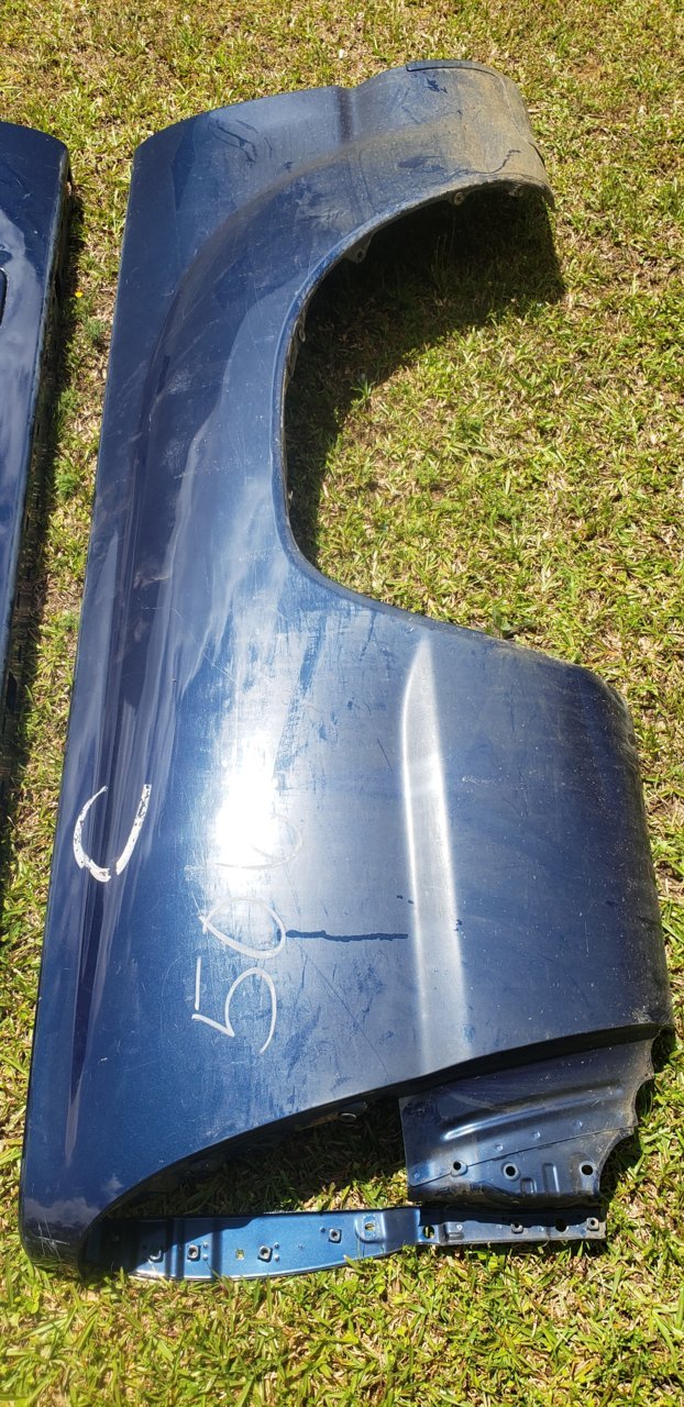

  18. Apr 24, 2020 at 10:10 AM
    #98
    gixxerphil
    Mar 31, 2018
    #249012
    23,250
    Phillip
    Auburn, Alabama
    2013 DCLB
    I got the bedsides pulled. I've decide to do the tintable Raptor liner. I beat the bigger dents out. It's not SEMA straight, but after the liner it should look fine.

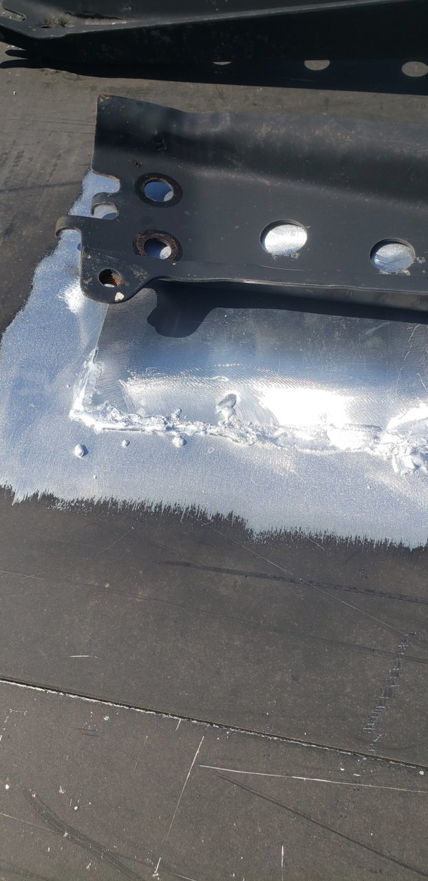

  19. Apr 27, 2020 at 1:29 PM
    #99
    gixxerphil
    Mar 31, 2018
    #249012
    23,250
    Phillip
    Auburn, Alabama
    2013 DCLB

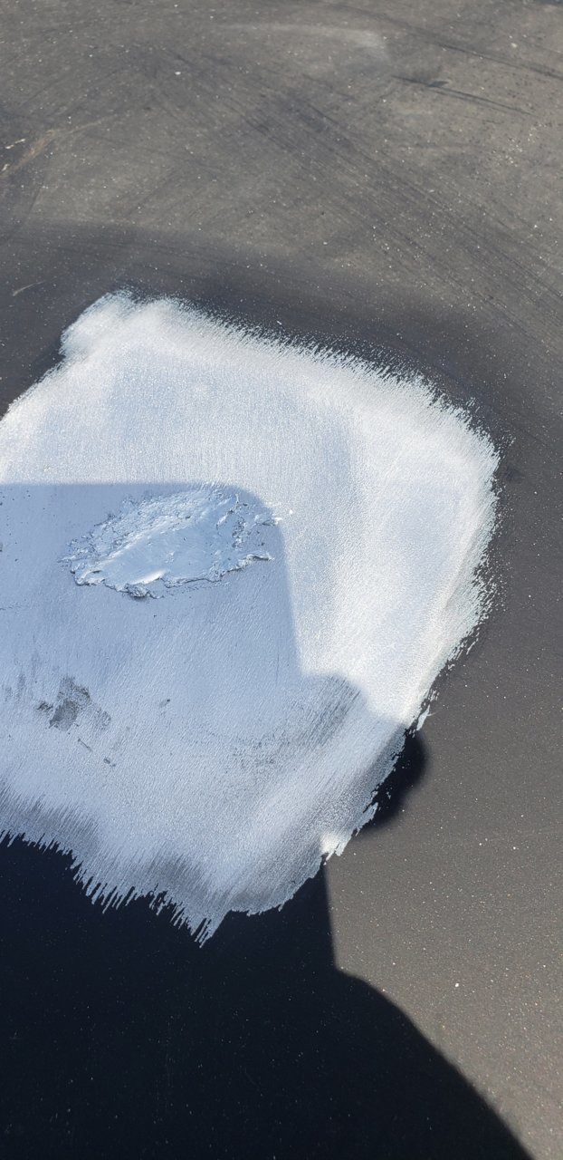

    One of the holes in the roof had a good sized crack. I kept burning through, so I cut out a hole. I got a piece of aluminum to lay over and braze in. It's ugly as hell, but it's working :D
    I also laid a piece under it so I could brace it from the bottom.

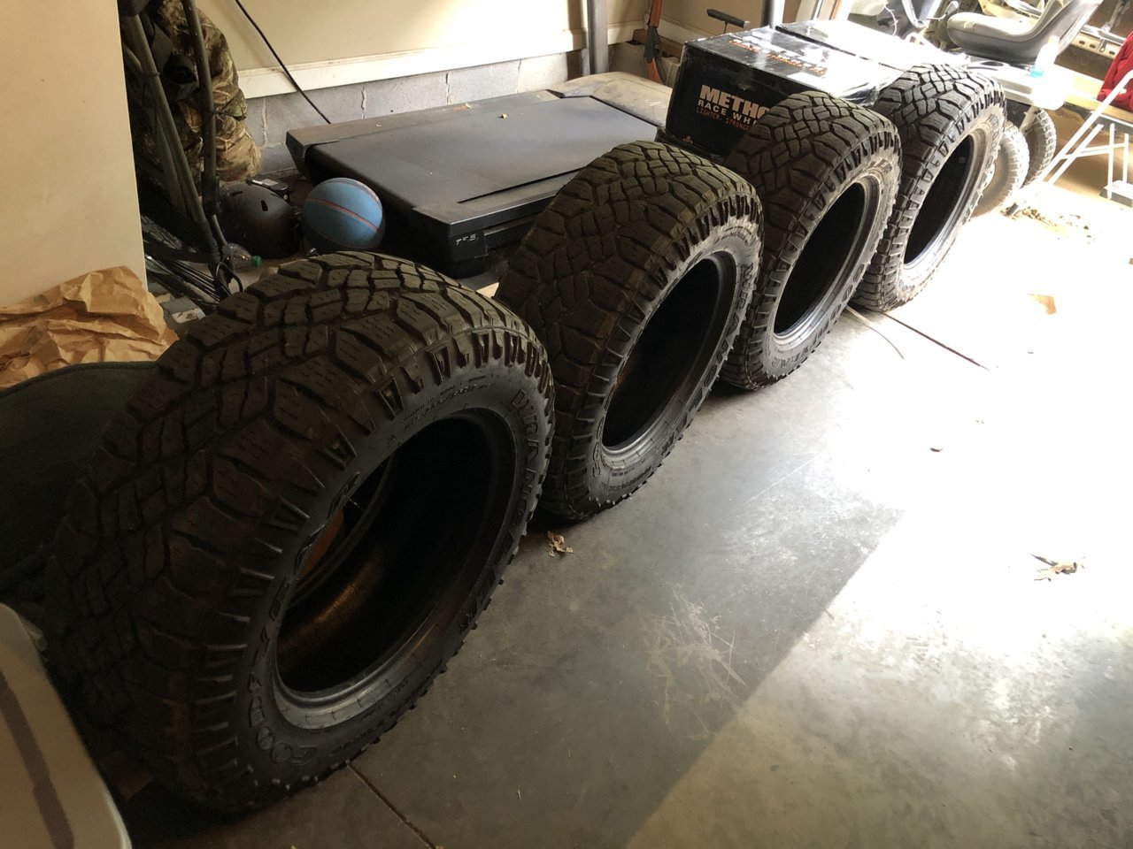

  20. May 11, 2020 at 4:27 PM
    #100
    gixxerphil
    Mar 31, 2018
    #249012
    23,250
    Phillip
    Auburn, Alabama
    2013 DCLB
    Got some tires for the trailer. @cubie was kind enough to hold them for me until we can put the lift on my truck.
