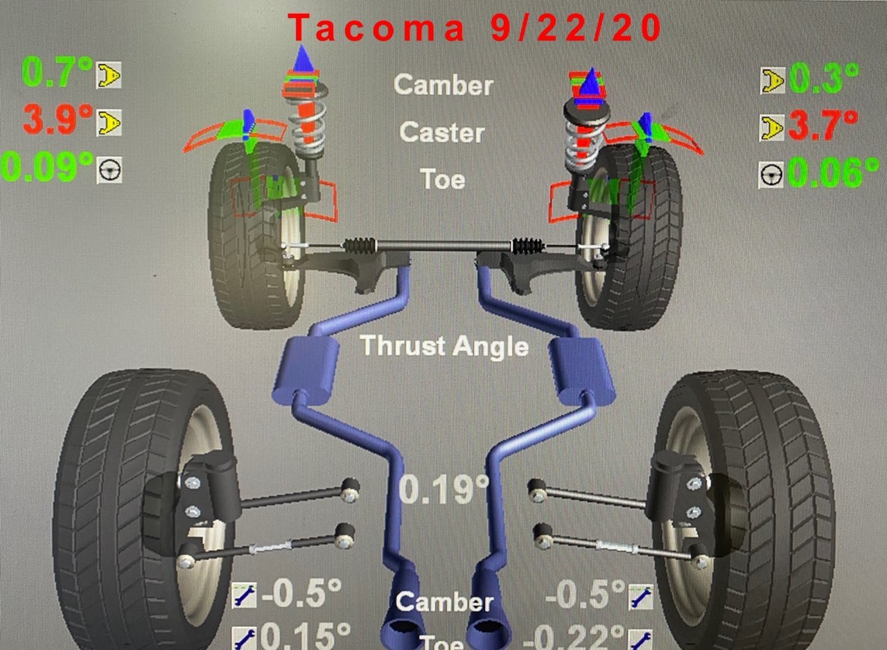

    Thats great! Do you remember what your alignment specs were? Here are mine. I had it done at ‘Rock Your 4x4’ here in Knoxville. It was only $70 and he knew exactly how a lifted toyota should be which really helped the rub.. i have a cmc and hammered down pinch weld, but i was still was rubbing occasionally with 34s. Now if i cut the wheel hard and am backing up a hill and accelerate while reversing which compresses the front enough i can make it rub but i just know to go slow in that situation lol.
    My UCAs are at +2 degrees caster, and the rest is done with the cam bolts on LCAs.

    The first alignment at a corner shop after doing the lca swap was not very good, so when i had my lca frame gussets welded in is when i had it redone to above specs by Rock Your 4x4... definitely not going anywhere else after seeing the difference.

    Y’all need more caster. My last alignment on the Tacoma was at 4.2 dr and 4.3 pass. And that was with 35’s

    I think I am in the sweet spot. Last two wheeling trips were perfect.. I guess when I go with the new MT/Rs LT275 /80 R17 I will see how it looks..

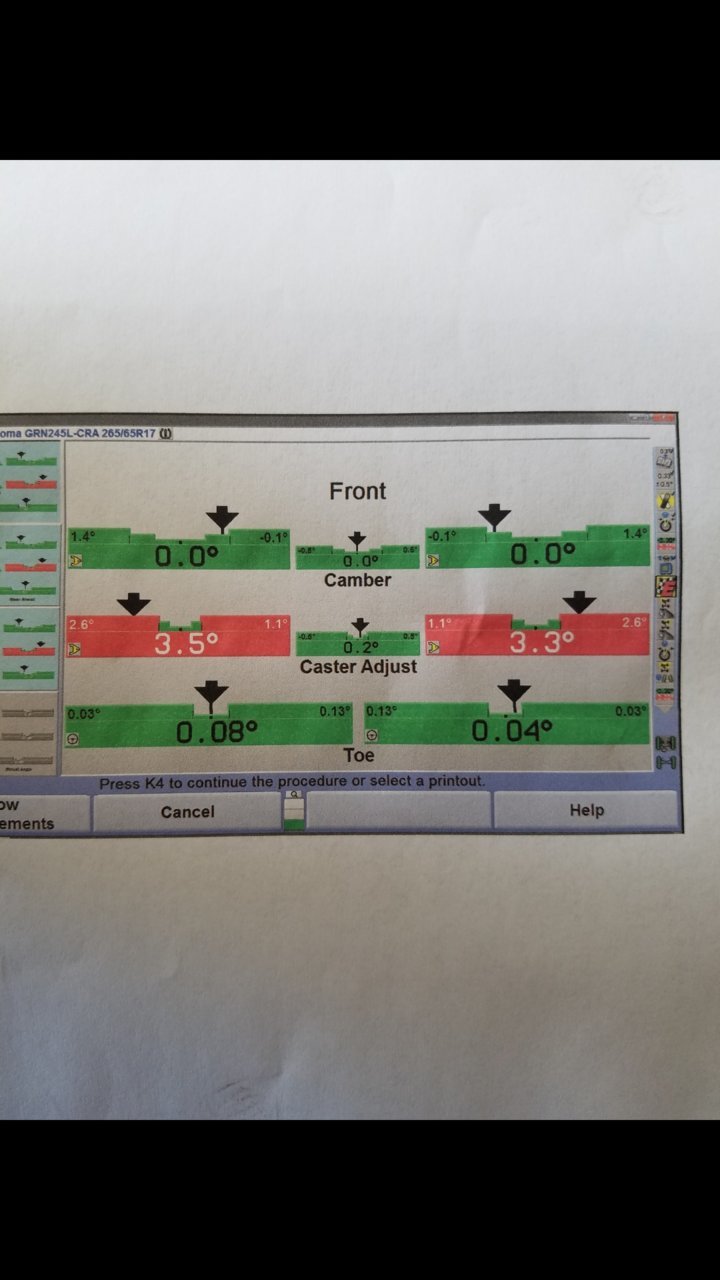

    I feel like thats pretty solid. I know alot of people like the 3.2-3.5 range. I hit two alignment shops in my area and neither were impressing me. The first, a dedicated alignment shop didn't know what thrust angle was when I was trying to get my FJ aligned, and the second shop smashed down my alignment tab...:notsure:
    I dig the 255/80s, I have a set of KM2s I put on my FJ for Wheeling and they fit great with no chop or trimming..
