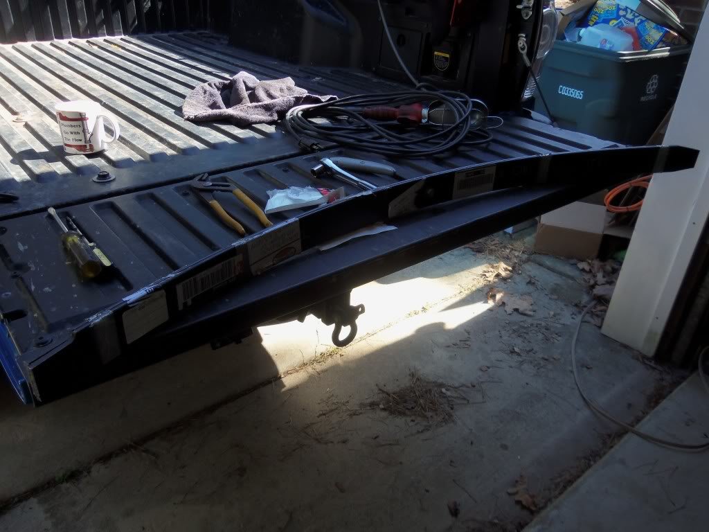

    Why wouldn't you just buy a regular AAL ?
    What measurement are you wanting ? I have a pair of d29xl in my shop

    Whats the length and width of em (letting the tape measure follow the curve of the leaf)? also is the center pin hole centered on the length of the leaf?
    I have been wanting to get an extra leaf that spans more of the main leaf pack vs a typical AAL.

    Hang on

    Total length 54 1/2"
    Width 2 5/16"
    Pin hole is not centred , it's offset by about 2"

    oooo thats a long sumbitch! so one side is 26.25in and the other is 28.25. I shall have to get my measuring tape out on the stock leaf!
    And on the "longer side" is that the angled tapered side, or the side that has the squared skinnier section.
    pictured here
