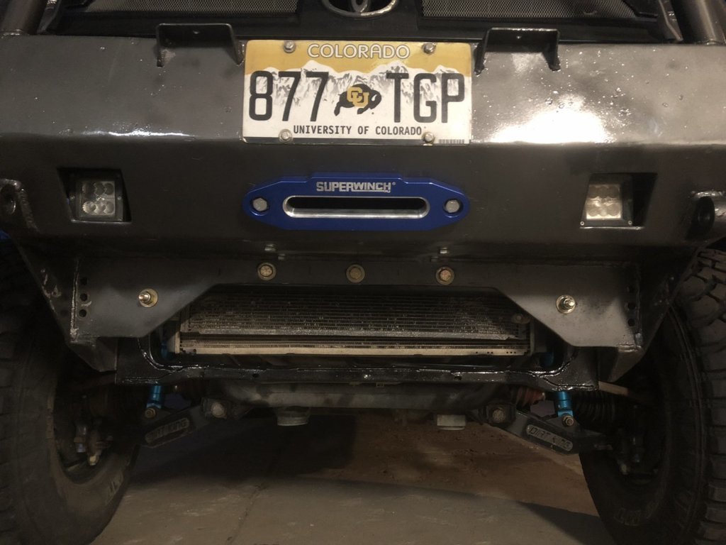

    I forget the thread but another member did this for the front support:
    And @Wishbone Runner has a nice square tube core support if I remember right.
    I need to finish the front section some day. Re hanging all the front fascia and coolers/radiator seems like it will be a b*tch though.

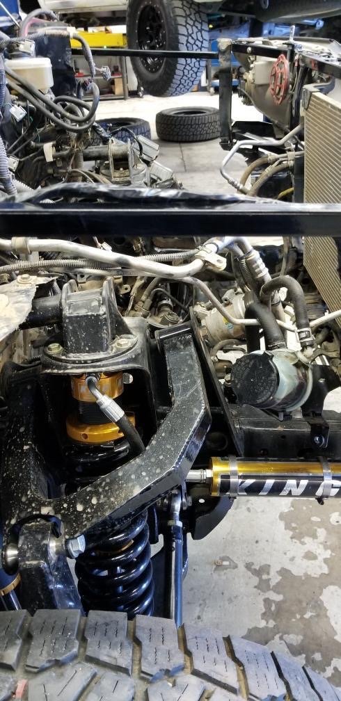

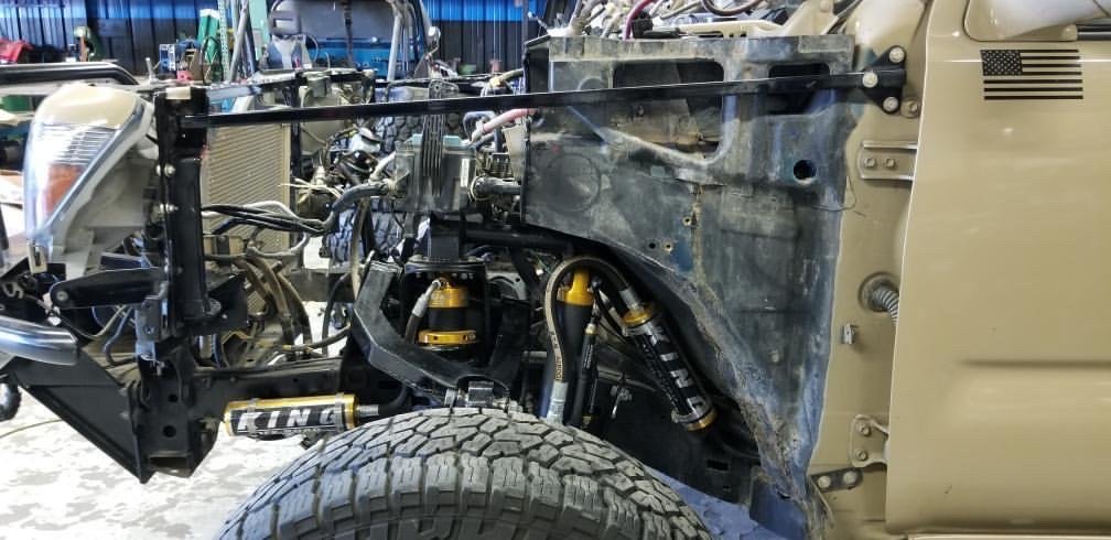

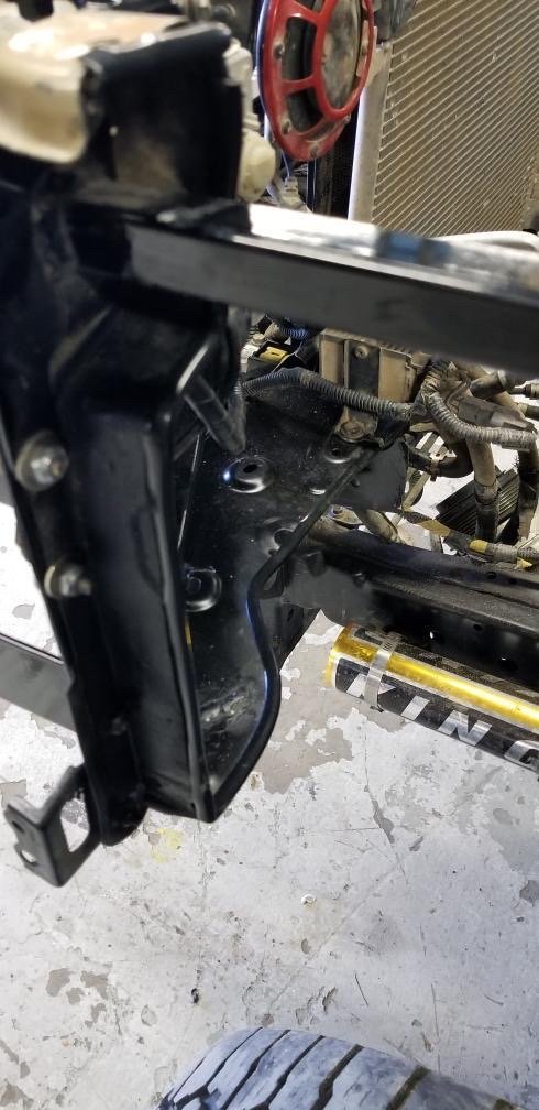

    Yep, that's fuckered.
    Bolt on would be interesting. Been beating on this setup for 3 years and no new weak points that I have found, yet.
    Not that hard, just time consuming.
    Also ran a beam across the horns to reduce twisting.

    I like the frame horn cross support. I’ll definitely be stealing ideas from ya in the future!

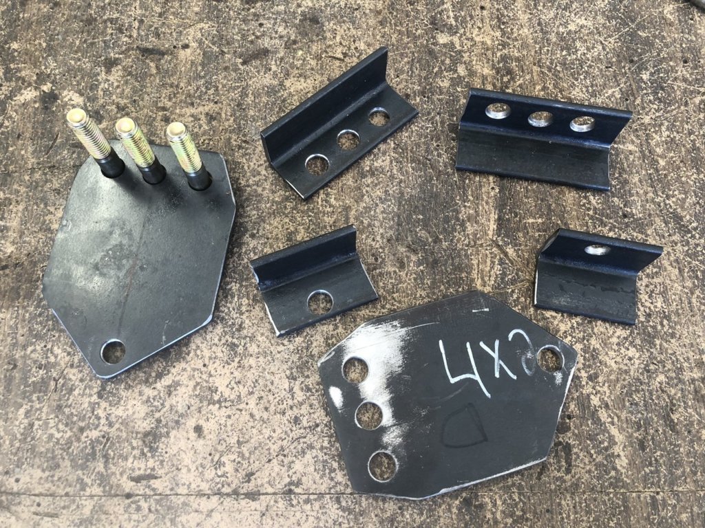

    Beefed up the horns while I was in there too with 3/16 and 1/4”.
    Bumper bolts through the whole concoction.

    :thumbsup: 1/2” grade 8

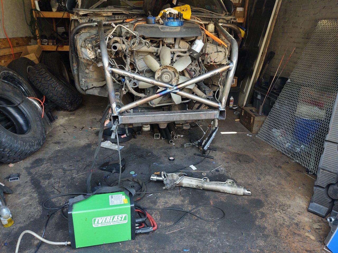

    I took a more aggressive approach to the problem.
    Slashaar, Torspd, Jwithers and 4 others like this.

    I really wanted to replace the cab mounted fender/hood supports. But every time I started looking at how/where to attach it to the cab I came back to the idea that I was either going to do a massive amount of plating on the firewall, or rip a hole in the firewall with whatever I did.
    So my hood, fenders, headlights, rad and grill will all attach to the frame, and the articulation point will be at the A pillar between the front clip and the cab.
