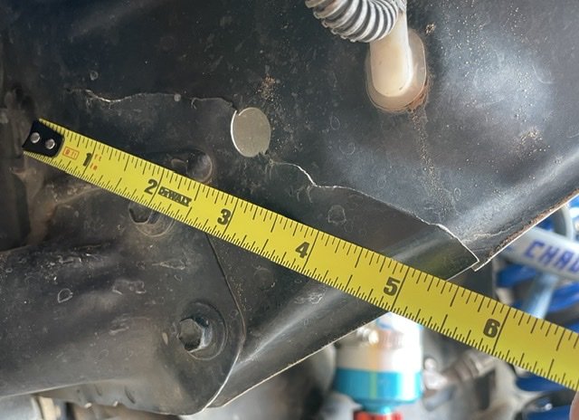

  9. Jan 26, 2021 at 12:26 PM
    #69
    deekyn
    deekyn Well-Known Member
    Dec 23, 2015
    #172953
    1,762
    Dustin
    Yellowstone
    2015 Black Tacoma TRD Off Road
    Well I’m not a go fast desert guy, maybe a medium to hard wheeler I suppose. And just found this today. :angrygirl:
    unfortunately I’m not a welder or fabricator... so I will try to find someone local to patch it up I guess. Hassle.
  10. Jan 26, 2021 at 12:31 PM
    #70
    Brian422
    Brian422 I fell into the pit that is TW
    Jun 8, 2011
    #57958
    15,607
    Brian
    Birmingham, AL
    2012 DBCSB F/R Locked, 35's ,Long travel, 23 Tundra 4x4 limited
    Not Stock
    Its going to be an ongoing problem unfortunately. I plan on fabbing up a new front end at some point down the road.
  11. Jan 26, 2021 at 12:37 PM
    #71
    deekyn
    Dec 23, 2015
    #172953
    1,762
    Dustin
    Yellowstone
    Yeah I sort of what I figured
  12. Jan 26, 2021 at 5:28 PM
    #72
    deekyn
    Dec 23, 2015
    #172953
    1,762
    Dustin
    Yellowstone
    Yep. Same. Mine went right through that hole too.

  14. Feb 12, 2021 at 10:13 AM
    #74
    littlefish
    littlefish Buzz, your girlfriend...
    Sep 13, 2018
    #266147
    2,020
    Hudson Valley NY
    2016 TRD Off-Road DCSB
    The one who dies with the most stuff wins.
    Man, seeing what lengths you guys have gone through really makes me think the repair I did on mine isn't going to last until the end of my next wheeling weekend.

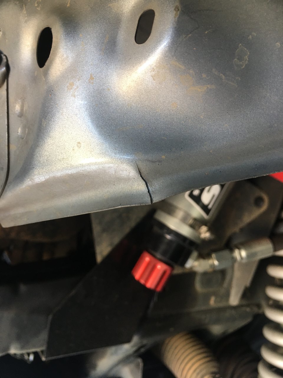

  15. Feb 12, 2021 at 10:43 AM
    #75
    deekyn
    Dec 23, 2015
    #172953
    1,762
    Dustin
    Yellowstone
    I had a six inch crack on the drivers side. It got welded with a plate welded over it. It has held up through the last few wheeling trips. I also had a small crack on the passenger side. It just got stitch welded. It cracked open again after a few wheeling trips. I’m not a welder so I can’t vouch for the work done.
    But I think consensus is this problem just recurs if you wheel or tear ass around in the desert.

  16. Feb 12, 2021 at 11:04 AM
    #76
    Dalandser
    Dalandser ¡Me Gustan Las Tacos-mas!
    Feb 19, 2015
    #149090
    17,621
    Anthony
    Downey
    08 PreRunner Regular Cab / 98 4x4 Extra Cab
    Empty Wallet Mod
    If you add a plate over it, at least it will add strength.
  17. Feb 12, 2021 at 11:09 AM
    #77
    littlefish
    Sep 13, 2018
    #266147
    2,020
    Hudson Valley NY
    Yeah I'll do that when it happens again. I'm definitely not in the mindset to build an entire cage to reinforce that area. It also seems like a place where if you strengthen up the weakest spot too much, the weakness comes out in an even worse location.
  18. Feb 12, 2021 at 11:19 AM
    #78
    Dalandser
    Feb 19, 2015
    #149090
    17,621
    Anthony
    Downey
    Empty Wallet Mod
    Yeah even 1/8" plate covering a little more than the affected area already strengthens a ton. Redistributing load is kind of the yin to the reinforcement yang - I'm relocating my batteries and anything heavy like a compressor under the bed.

  19. Feb 13, 2021 at 5:17 PM
    #79
    ovrlndkull
    ovrlndkull [OP] STUKASFK - HC4LIFE
    Jan 7, 2017
    #206806
    37,785
    Skip
    Burlington, NC
    2005 DCLB Silver
    63s, XD Machete, Beat not Babied
    This will help a bunch. I have made it a point to not mount my locker compressor under the hood, even though it's a mini. For one more weight up front for 2 less clutter in the engine bay. Soon the battery will be relocated and mounted under the bed.
