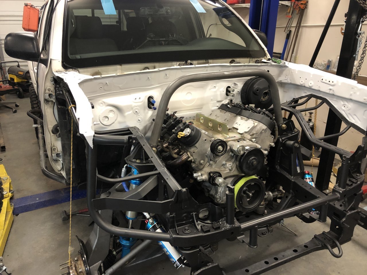

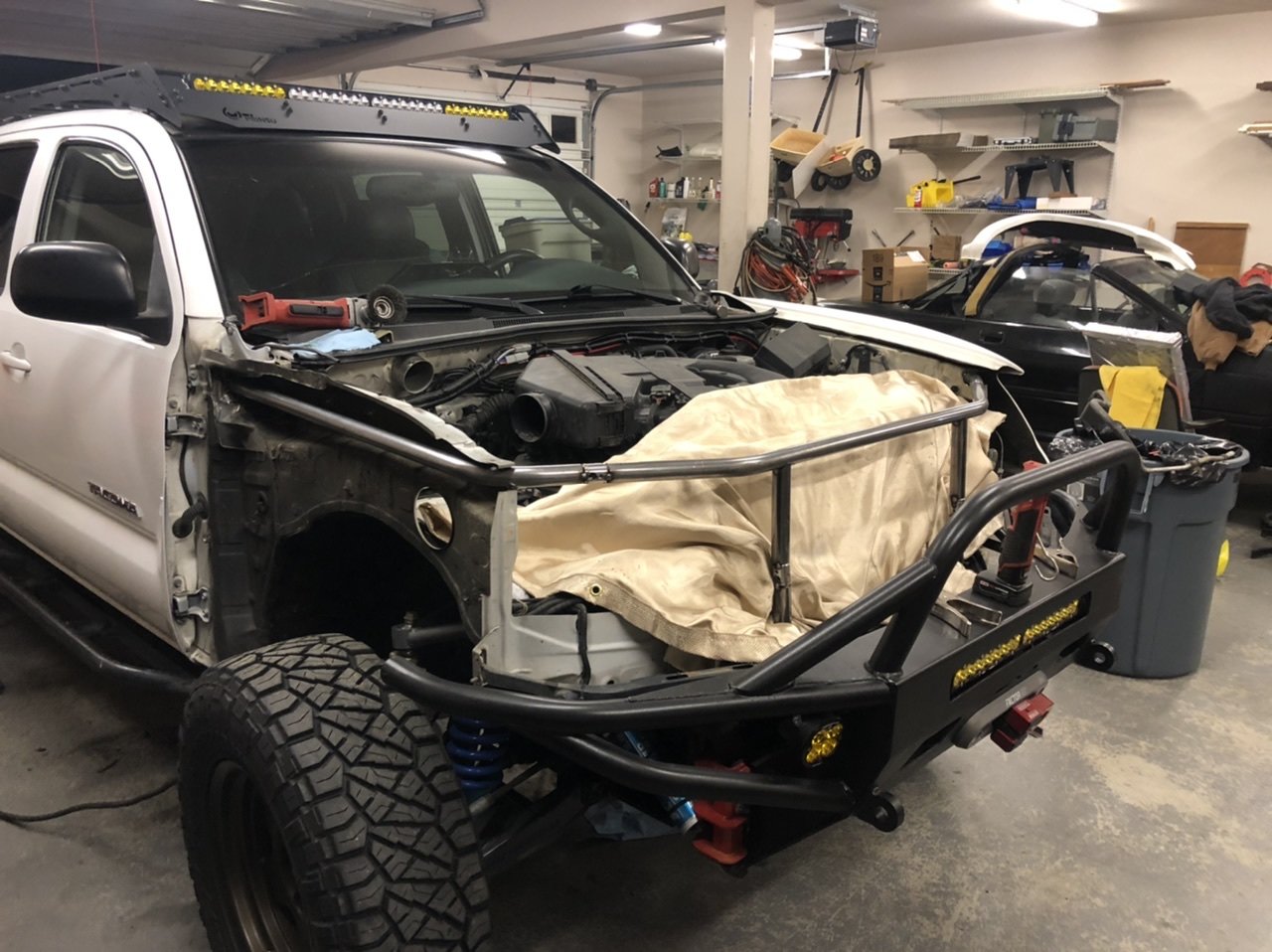

    This is what I did to mine and my core support wasn’t even cracking at all yet… lol

    2018 QuickSand
    Check out my build thread (Beginning of Money Pit)
    nice job

    Yeah it turned a 6 week project of installing new +3.5 lt into a 3 month project.

    Looks sick! I wish I had the patience and the skills for this level of fab work.

    thanks, yeah it went from slightly modifying the wheel wells to full on real quick once I started working on it… spent about three weeks just trying to get it how I wanted it… and now I gotta cycle it with 35’s and hopefully don’t have to modify anything further…
