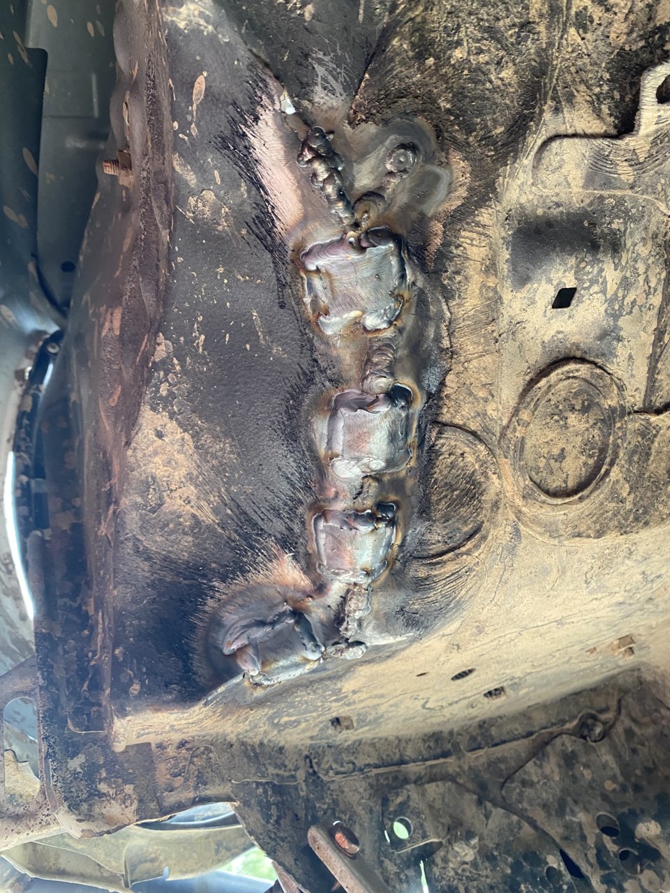

    Unsurprisingly a crack formed under my 65 lb battery, right where I did some tubbing. Welded it back together and added some 14 gauge squares to try and help hold it together. We’ll see how long it lasts.

    TIG welded yes? What filler rod did you use?

    No, just mig. That’s why it’s not the prettiest.

    So ER70-6?

    I don’t remember, whatever is in the welder. It’s .030

    Keep us posted. I welded mine up this time last year and it’s already busted through. Didn’t use filler material like you did though.

    I'm hoping that's the key to this working. I forgot to mention I also used a sliver of 14 gauge on the back of the crack (where I could) as a backing material.

    Yeah idk even what you would call this. I just kinda stared at the crack for awhile trying to figure out what to do and this is what I came up with. I'm hoping it'll help the crack from pulling outward again.

    This only started from where I tubbed. At that time, I was even worse at welding sheet metal so the joint wasn't super strong. I didn't think much of it until a crack formed and spread into virgin sheet metal. No issues on the passenger side where I tubbed in the same spot.

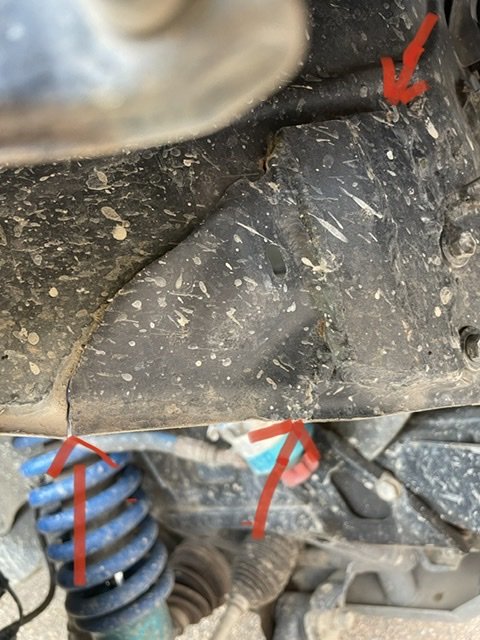

    Found my cracked on both sides in January. Had the cracks stitch welded and plates welded over. Maybe 700 miles of easy rocky/washboard dirt roads and 10ish rock crawling trips in Utah and Colorado since.
    And found a new crack on passenger that just decided to go around the welded plate.
    For off road trucks, these trucks fall apart when you off road.

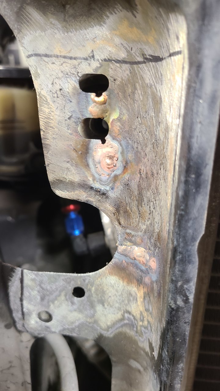

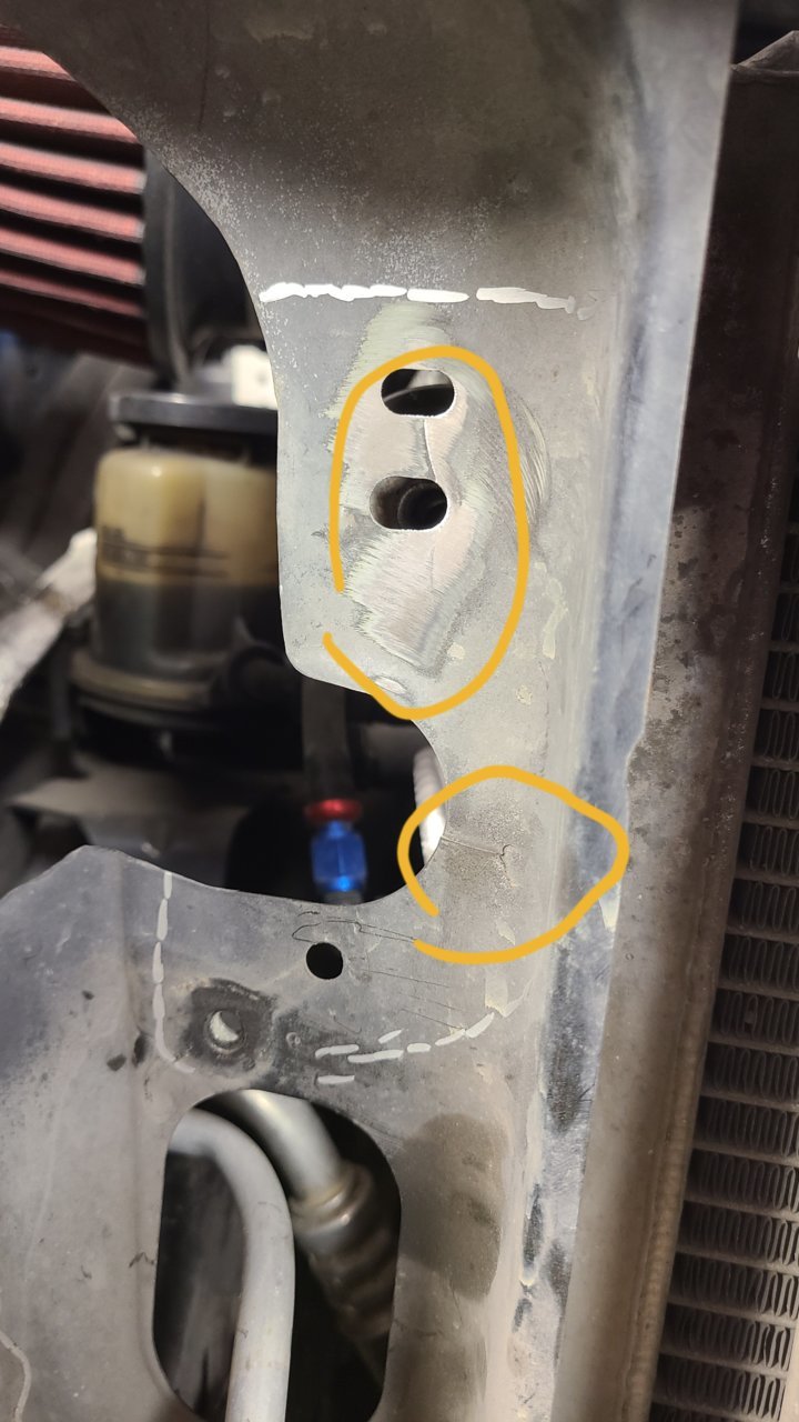

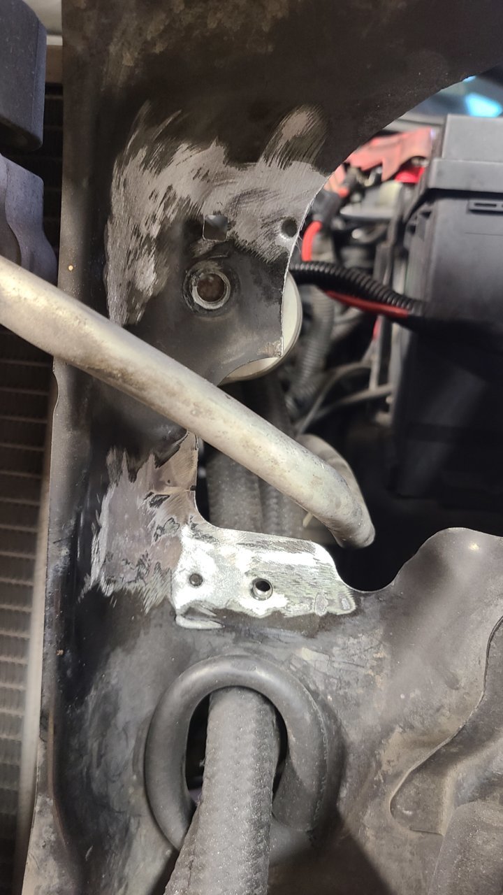

    TIG brazed the yellow circled areas back together. Not that easy. Need to braze on the added sheet metal tomorrow.

    Do you think the areas you cut out for plumbing weakened the radiator support much?

    Absolutely. Including the heavier radiator. . That's why I am plating those areas.
