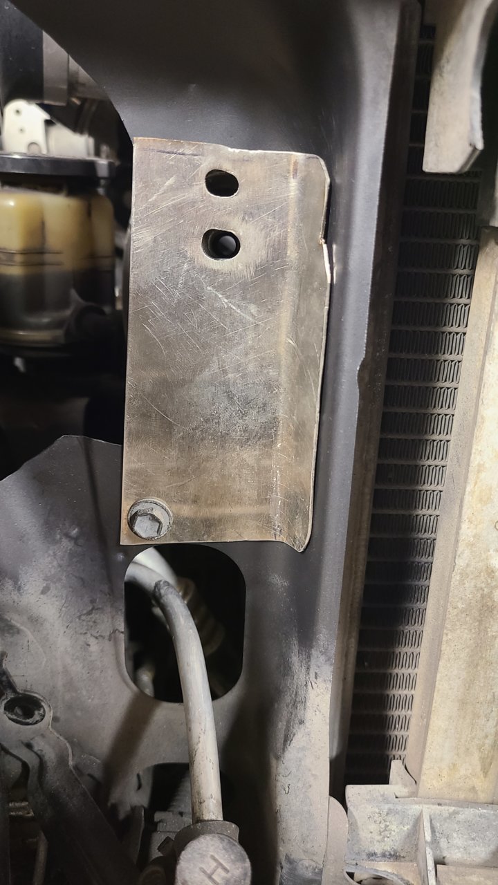

    Run that plate all the way to the base of the rad support, then across the front of rad support. essentially build a box for the the radiator mounts and tie it to the support bushings.

    Finally had to do something about mine. It was pretty bad. Did all this work and then found that it is torn at the top too where it meets the very top bar. I’m sure this will hold up ok but I’m just waiting to see where it transfers the stress to later on.

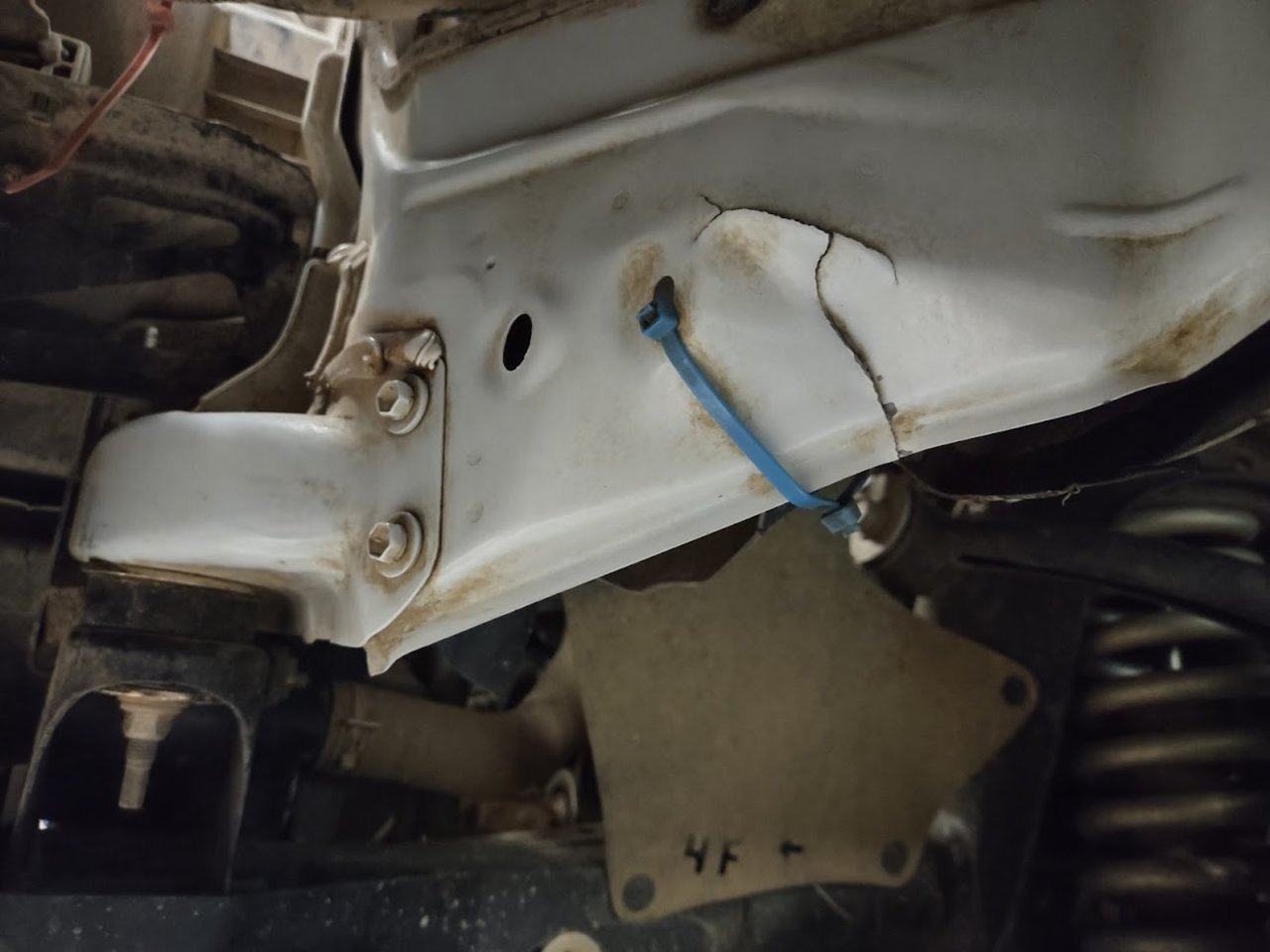

  7. Apr 16, 2022 at 2:37 PM
    #147
    E.J.
    E.J. International Overlander
    Jul 10, 2019
    #298824
    958
    Josh
    NWA
    2017 White Tacoma TRD Off Road
    AM-JKLVUtEDiSfDAlJ8fqnjB4XQ1GABEc2bJYs7q_e5f3ccd1f5e6e9c1e577cd9c0fecd77e2c9a6fa5.jpg
    BUMP, just discovered this crack and then this thread. I'm an overload...er overlander, thought I was wheeling mild. Not sure how I'm going to go about mending this.

    Depends on how much resourcefulness or money you want to use.

    Locker anytime Fog Lights anytime Full LED light conversion TRD cat back Rear cat delete Exaust Y reroute away from actuator Alloy Clutch master 2000 4Runner "Dog Leg" shift leaver Marlin shift seats and bushing Rear seat delete Rear diff breather extension Chrome grille swap Debadge Rear seat delete Honda blower motor beefy plug and wire mod Anytime 12v and USB with volt gauge in bed Blue Sea fuse box Hella AND 70's Caddy horns Low profile recessed hex drain plug swaps Alluminum battery strap 7pin relocated Backup cam on anytime Various other creature comfort and personal taste mods.
    Why does your core support have herpes?

    Does it bolt in or is it welded/bonded?

    I can't find any complete core support assemblies for 3rd gen, only parts and pieces.

    If you have the JD Fab inner fenders it bolts on:D. When you drill out the spot welds for the original on you could either weld it again or bolt it on.

  19. Apr 18, 2022 at 10:25 AM
    #159
    E.J.
    Jul 10, 2019
    #298824
    958
    Josh
    NWA
    GD this 16 gage is easy to burn through. I've noticed that almost every truck this is happening to has the Energy Suspensions poly bushings, including mine. I think there's a pattern there. After my SEMA show quality welding job I'm switching back to rubber bushings.

    Mine started happening before the poly bushings but yes the rubber will help to not allow as much stress to the body.
