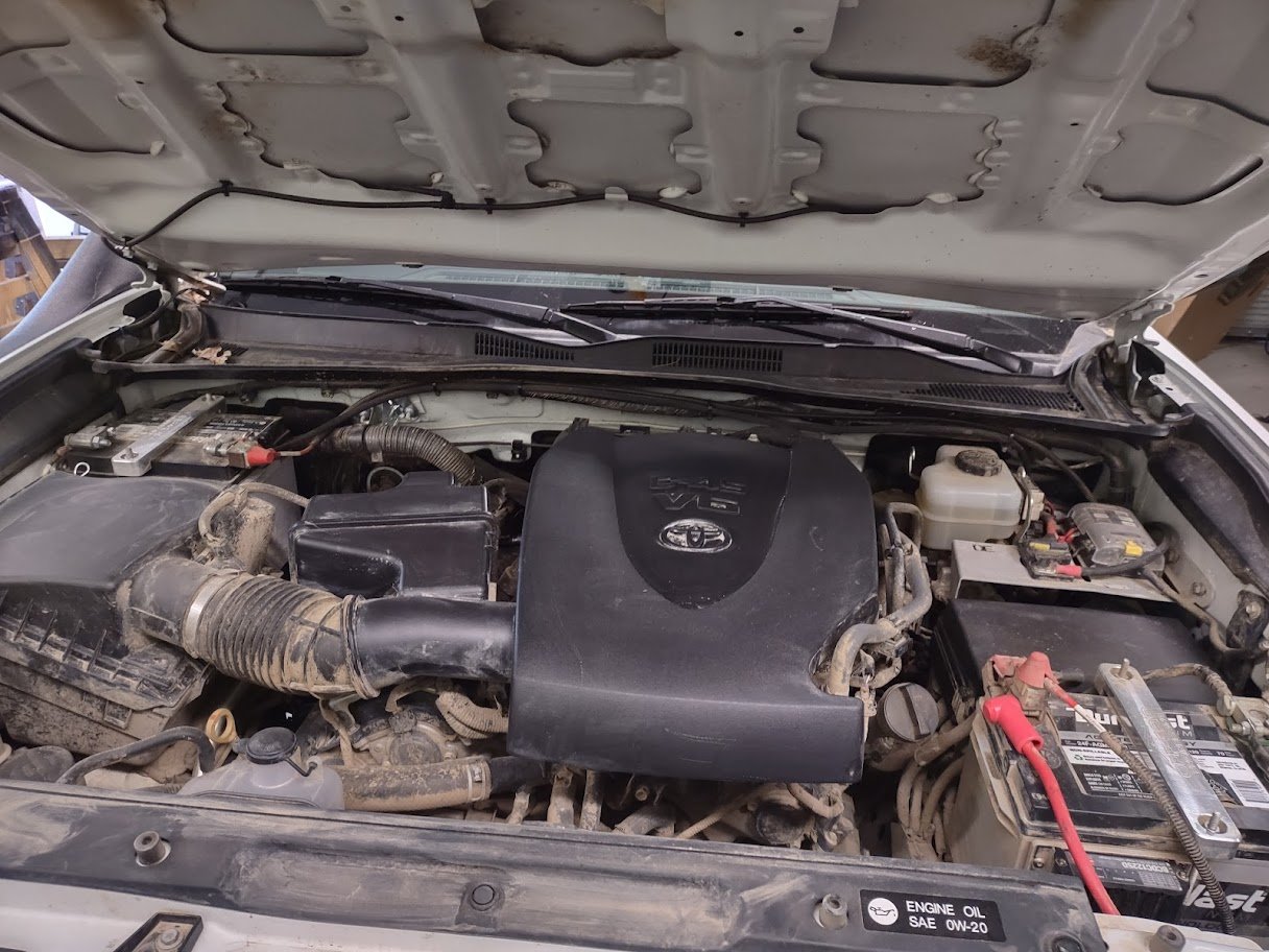

    This is what I got going on now, the plan is to use the passenger side mount for the starting battery and move all the aux power stuff to behind the back seat, leaving the stock battery spot empty. Then I'll go get a quote to get that support panel replaced at a body shop. I think this is a solid plan to relive stress on that corner, no?

    My battery was moved right after I bought my truck and the core started cracking anyway.

    I didn't think it was a huge pain to replace the cores support. Worse part is the ac lines go thru the support and that had to be recharged. I went a little further with reinforcing the new one. Basically I plated from the frame bolts to the radiator mounts and all the way across the top of the core. My hood has hood pins mounted to the top of the core support. I also tied all this into the hood hinges. Of course 11 years later the whole unit separated from the cab. But that's another story.
