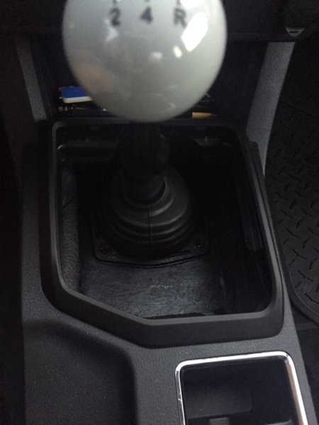

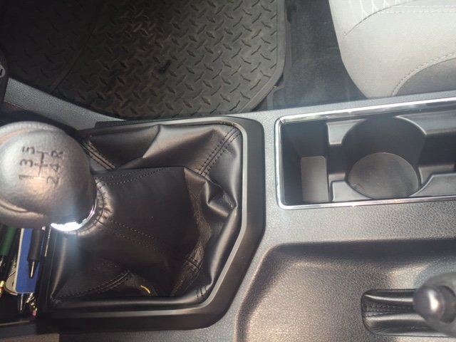

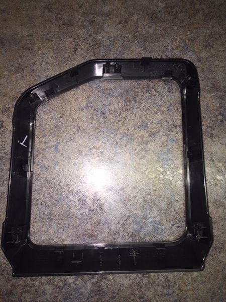

    Hello, 2016 Taco 5 speed. I want to remove the leatherette shift boot. I can undo some clips on the sides, but not the corners. Any tips or tricks? Thanks

    I have a different knob I want to use, and the new knob won't hold the boot up anyway....
    I took the boot off, easily, from my 2013, and painted the inside space flat black. It made for nice additional storage for things, although it did get a little hot.
    I personally don't like boots on trucks, I prefer the long stick look, with the rubber accordion boot at the base.

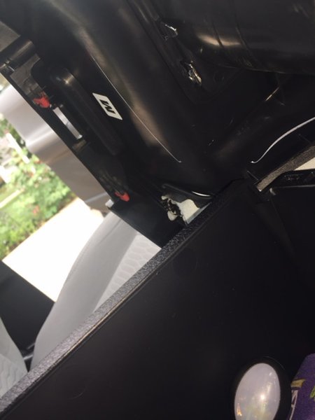

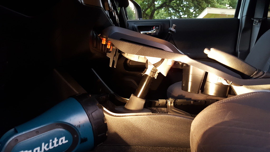

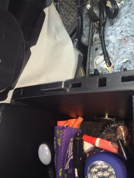

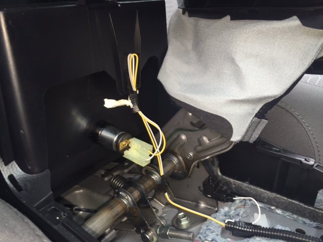

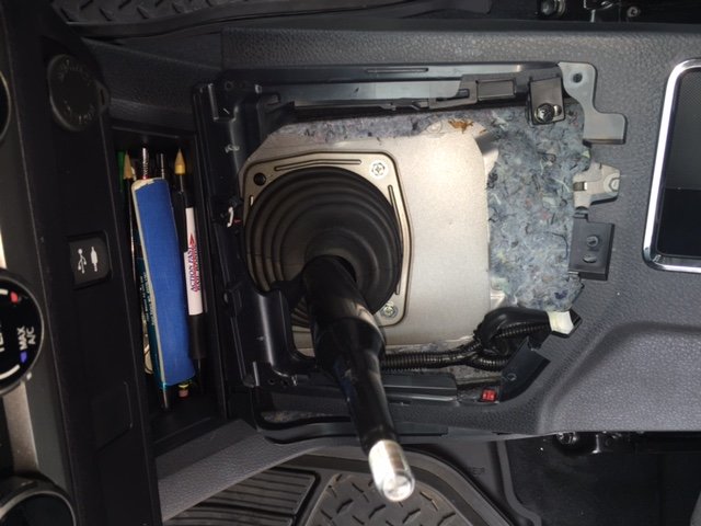

    This is how far I got doing my shift knob. Didn't remove the boot, but this may help. The entire console just pops up and lifts off. This should give enough room to see how the boot attaches to the console. Plastic circular clip is zip tied from underneath

    Wow, just pop off the whole top? Nice. Does it separate from the rear storage area? Can it be completely removed?

    It encompasses the front face of the center console. I believe it lifts up and out as well. If you take the whole thing out (I didn't need to) post some pics for future reference! :thumbsup:

    I just don't want to force/break anything plastic.

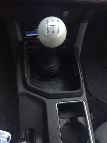

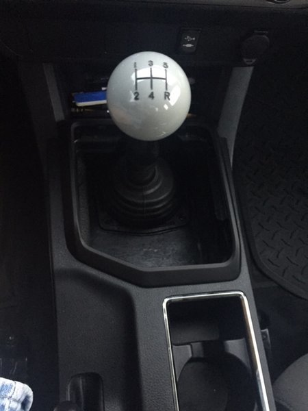

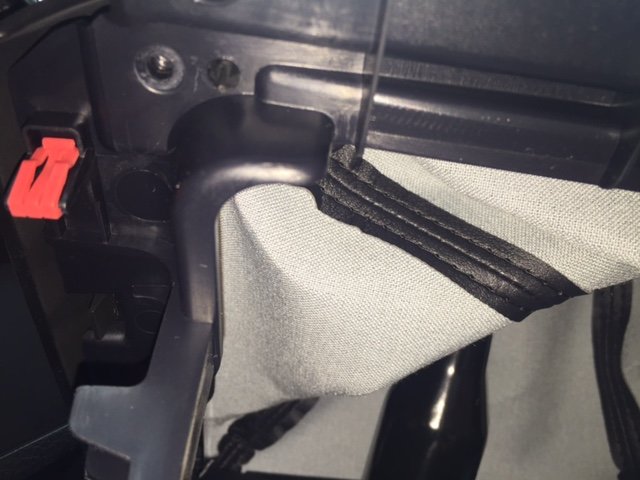

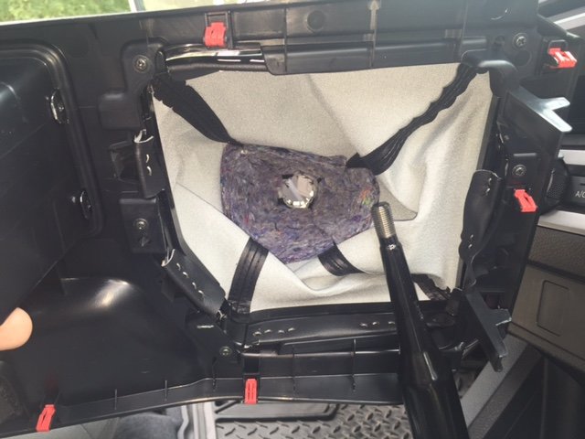

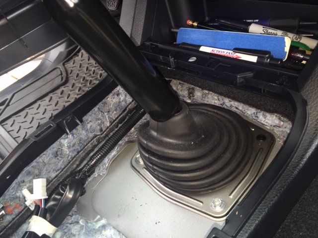

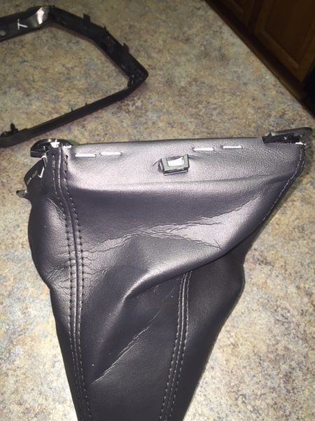

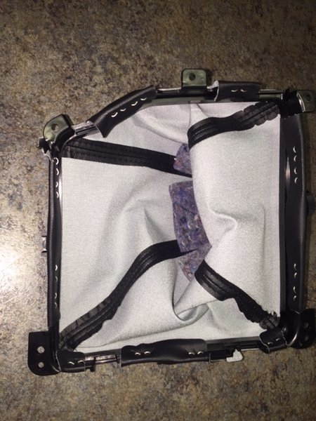

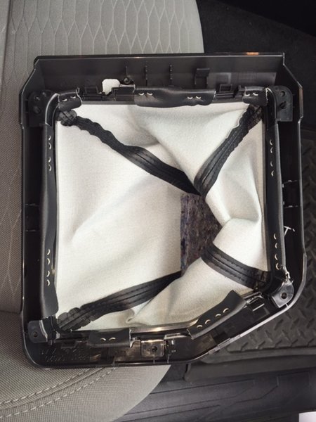

    It came off with a little upward pressure and wiggling, all is well.
    Then the boot came off easy, the whole top won't come off without undoing the brake boot, which I have no need to do.

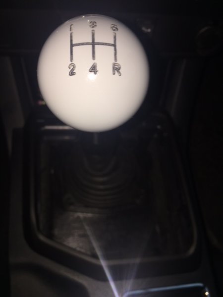

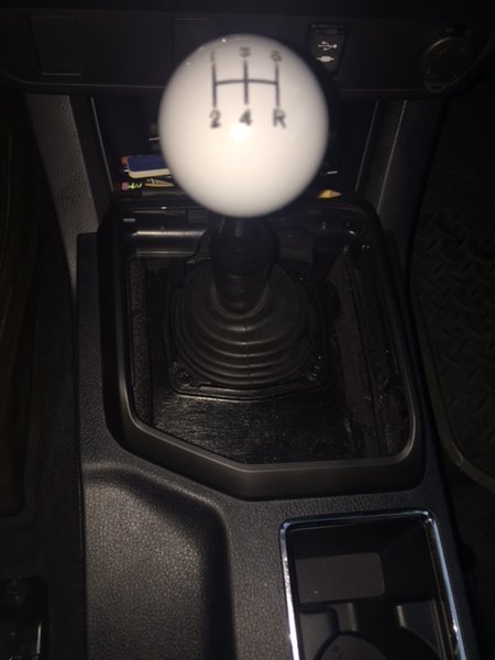

    Old school round shift knob will be installed.

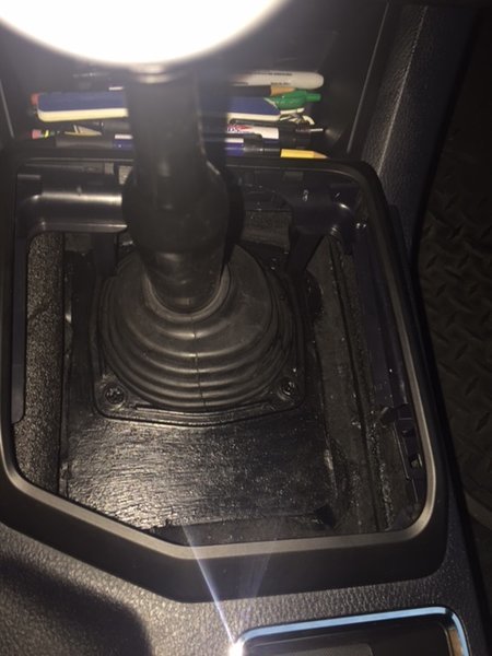

    I'm painting the inside over the hump flat black and will reinstall, w/o boot. It makes for a nice little storage area.
    The trim ring has 6 screws on the underside. Pics when done.

    Now, to trim it out on the inside...I just thinks boots are for race cars, not trucks.
