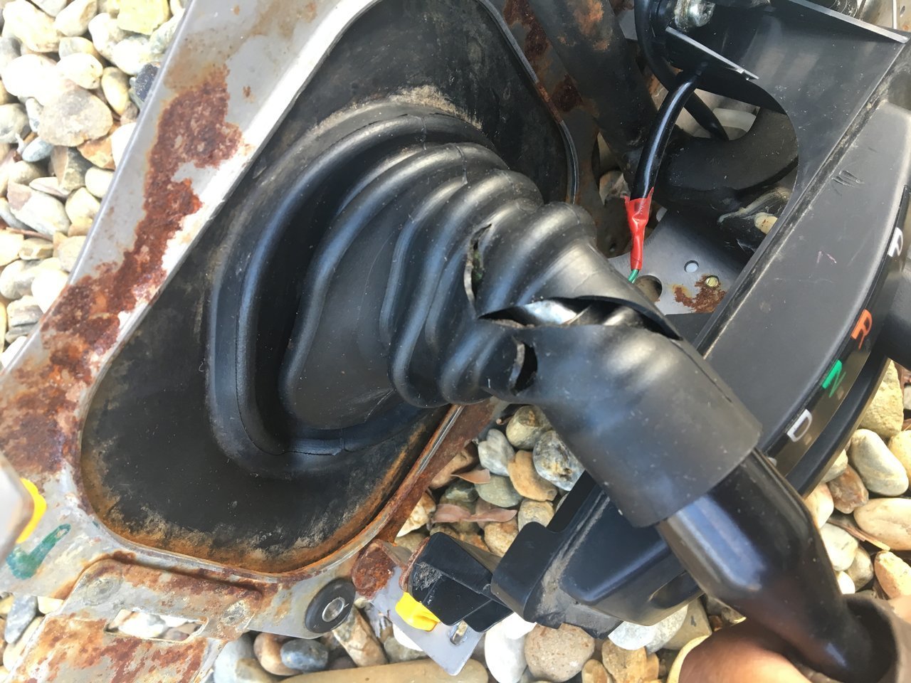

    The internal rubber boot on the a/t j-shift shifter assembly is torn, does anyone have a part number? I can't seem to find it. Part shown below.

    I'm pretty sure it's part of the shifter assembly. notice the rubber spots/grommets along the edges? Those are pressed in somehow. I have a spare one somewhere I'd need to look at, think it's buried in a relatives garage.

    Yeah that's what I thought... I looked through the entire 95-00 parts catalog and couldn't find it. I couldn't even find a diagram for the shifter assembly.

    Try this number#
    Toyota Part No.:36331-35010
    BOOT, TRANSFER SHIFT LEVER
    about 48.00. Check with the dealer, but I believe they'll fit 1995 -2004.
    Boot is separate from shifter assy, just pulled mine off, cleaned/inspected and reinstalled. Don't lose the metal inserts, they press in/out.

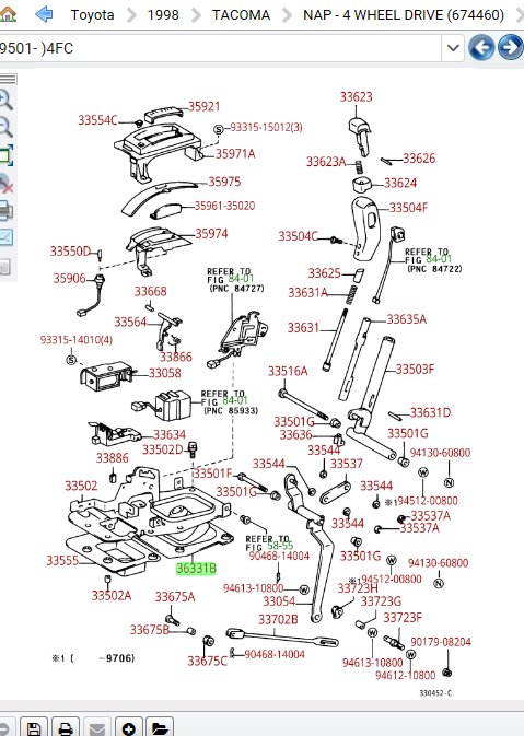

    36331B in the picture is the boot. Looks like s92dvr is correct with the part number.
