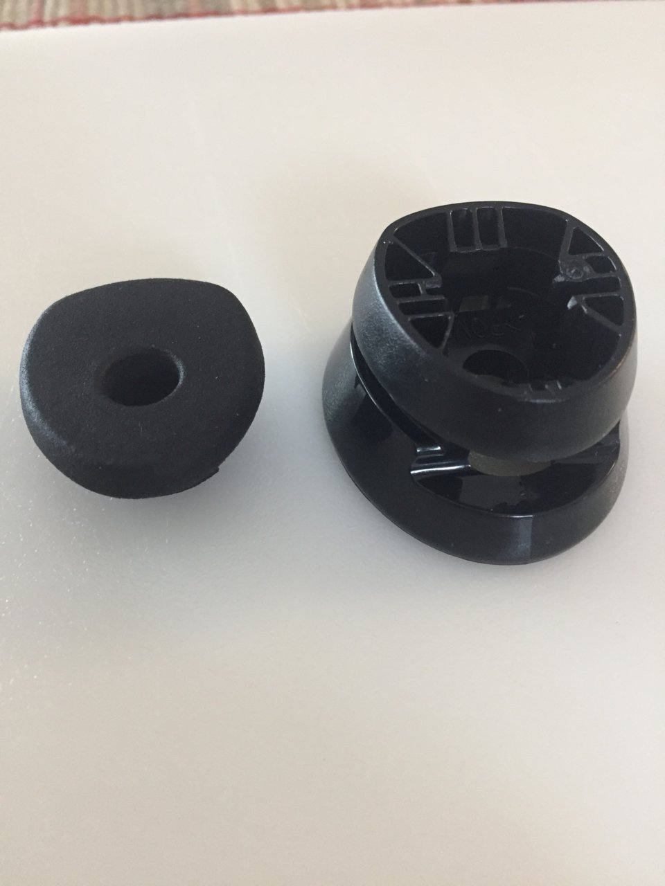

    Thanks to @MidWestTRDPro I also have this in the works. This is a complete replacement for the OEM chrome. The final product will be black.
    I should have my test piece pretty soon.
    Below is the OEM replacement and cap fitted together then sliced near the midplane.

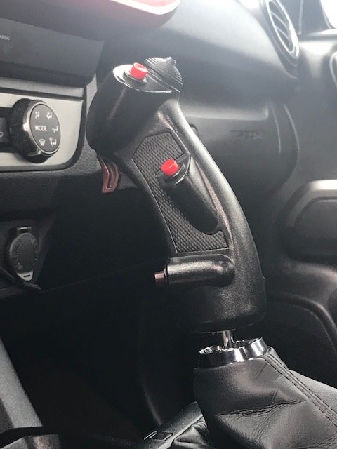

    Definitely need this to cap off my shift boot

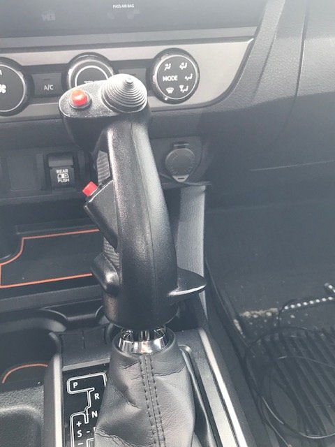

    Speed dawg shift knob
    image.jpg image.jpg My base sr auto came in black

    Funny how the MT SR collar isn't black like the AT.
    Yours also looks a little different from the chrome version.
    My SR manual knob twist lock features were slightly different from TRD knobs, but still mostly the same.
