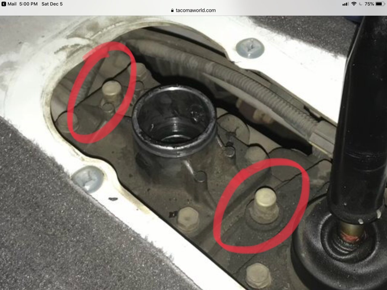

    This posting should also say to replace or check the transmission and Tcase pressure valves when the console is taken out.
    They are 5.00 items and if they get plugged up you can blow a seal in the transmission or the Tcase.
    They are common to get stuck closed from dirt and age

    Oh so now you tell me. How does one check these? Do the caps just pop off or something?

    The whole piece pulls straight out,
    They are one piece.
    They should wiggle around and be able to move up and down.
    If they get clogged the pressure inside the transmission will blow out the rubber seal.
    This is a common issue with the rear axle with this same valve and the rear seal blows out with the dealership costing 800.00 to fix the seal because a 5.00 valve was not inspected.
    But if you see alot of oil or leaking coming from one of these valves then its stuck open or defective

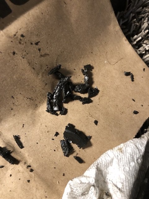

    i’m currently replacing mine and when I pulled the shifter my top bushing was completely disintegrated…i removed everything i could near the locking collar and even used some tiny needle nose to pull more out of the reservoir below…
    question: since it had completely fallen apart, what about the pieces that fell down into the reservoir below? I got everything i could see, but I’m sure there’s more…do i need to flush transmission now????75030332553__F08700B6-BA78-4C28-A9F1-373A4D54AAC1.jpg
