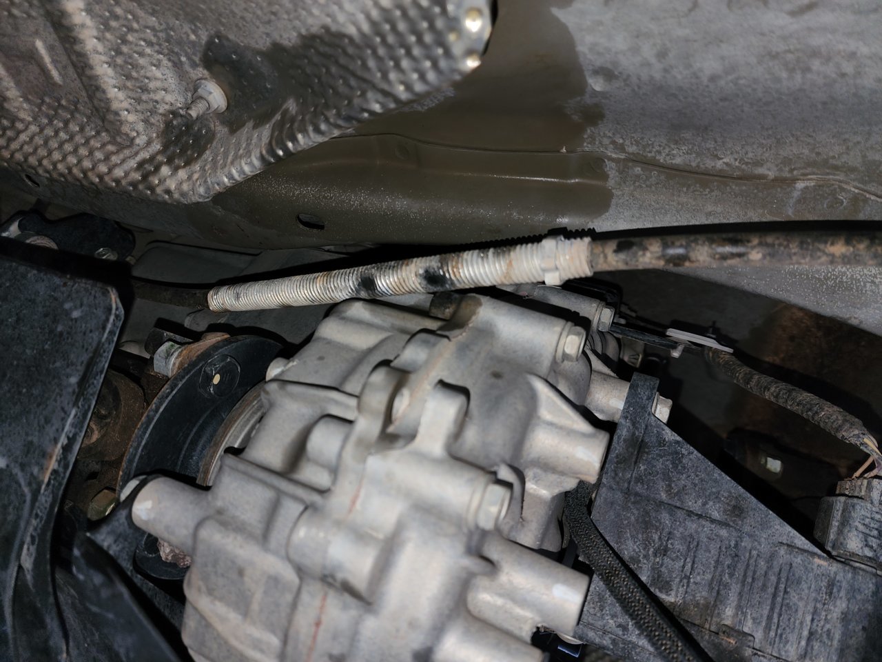

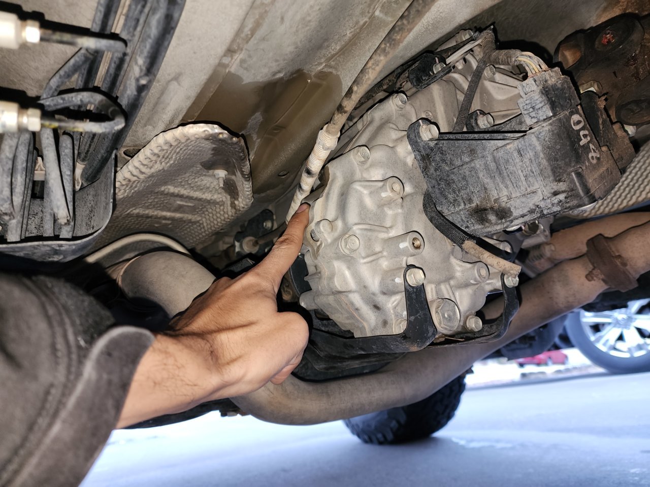

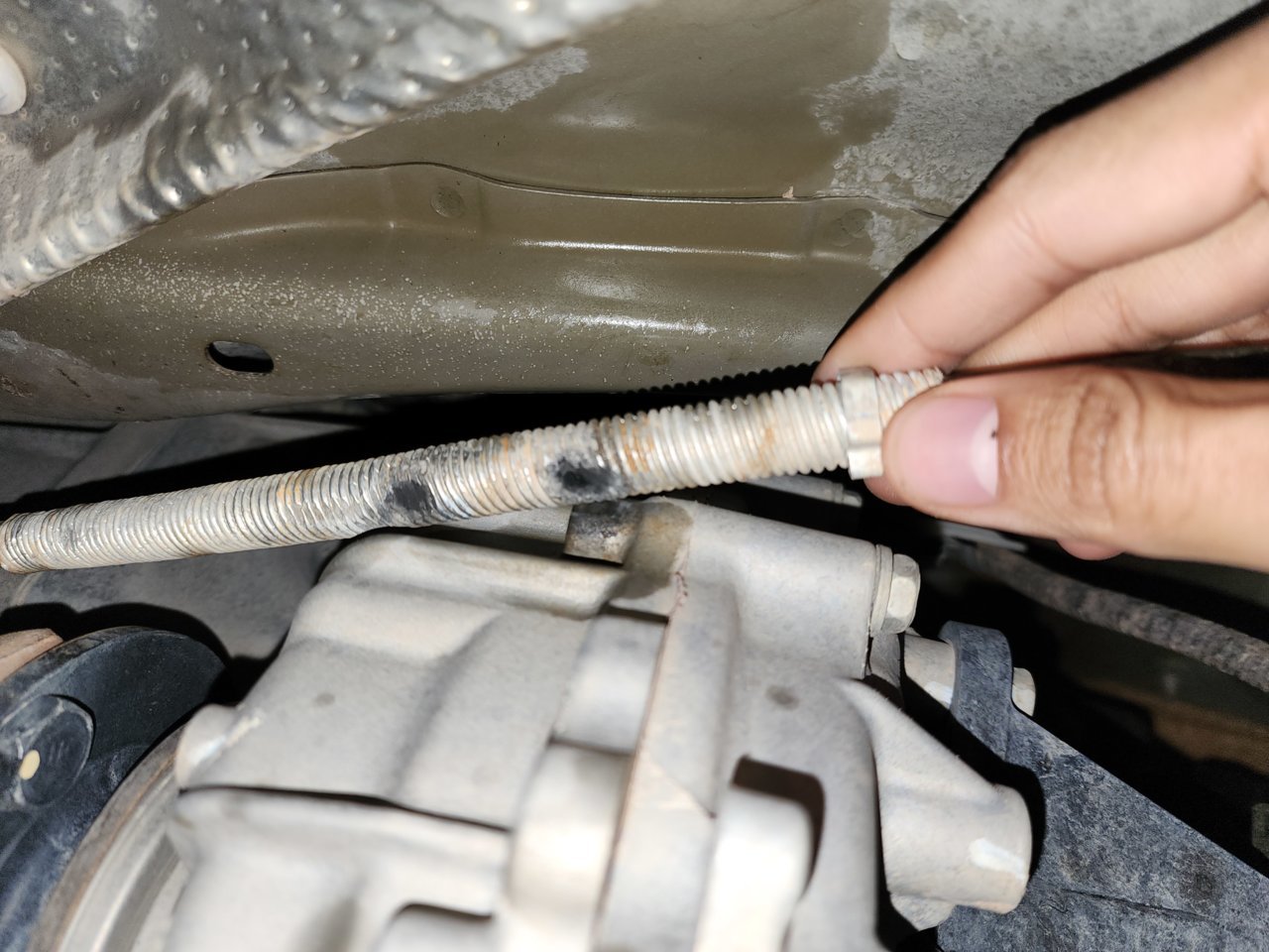

    I was under the truck earlier regreasing the driveshaft and I noticed a bit of fluid staining. At first I thought it was from the transfer case but then I saw this cable which looks like the brake cable for the handbrake rubbing the transfer case? It's rubbed through and I figured I'd give you guys a heads up before someone loses their brakes.
    EDIT: might have jumped the gun a bit. Looks like this cable runs to the tranny and attaches to an arm. Might be the shift selector? Any insight would be appreciated!
    76k miles on a 6/16 Build date, Mexico Built, 2016 DCSB TRD Off- Road, with no suspension or brake mods.

    I believe that's the transmission shift cable. Read this for more info.
    https://www.tacomaworld.com/threads/check-your-parking-brake-cable-psa.624898/

    Thats the shift cable, and its missing a bracket to secure it to the body.
    Edit your title so you don't cause panic.

    My bad, now I gotta find out where the hell this fluid is coming from...
