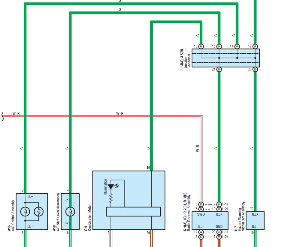

    So the Tail Light fuse is good? If so then look at the drawing below.You can see that the AC Controls, Shift Lever Automatic, Combination meter, Stereo Controls in steering wheel, and Hazard Warning illumination all come from the same junction connector J4. J4 gets power from the Tail Fuse.
    So if some of these are working and the shifter lamp is not getting power the issue would be in the J4 connector or the wiring going to the shifter lamp.

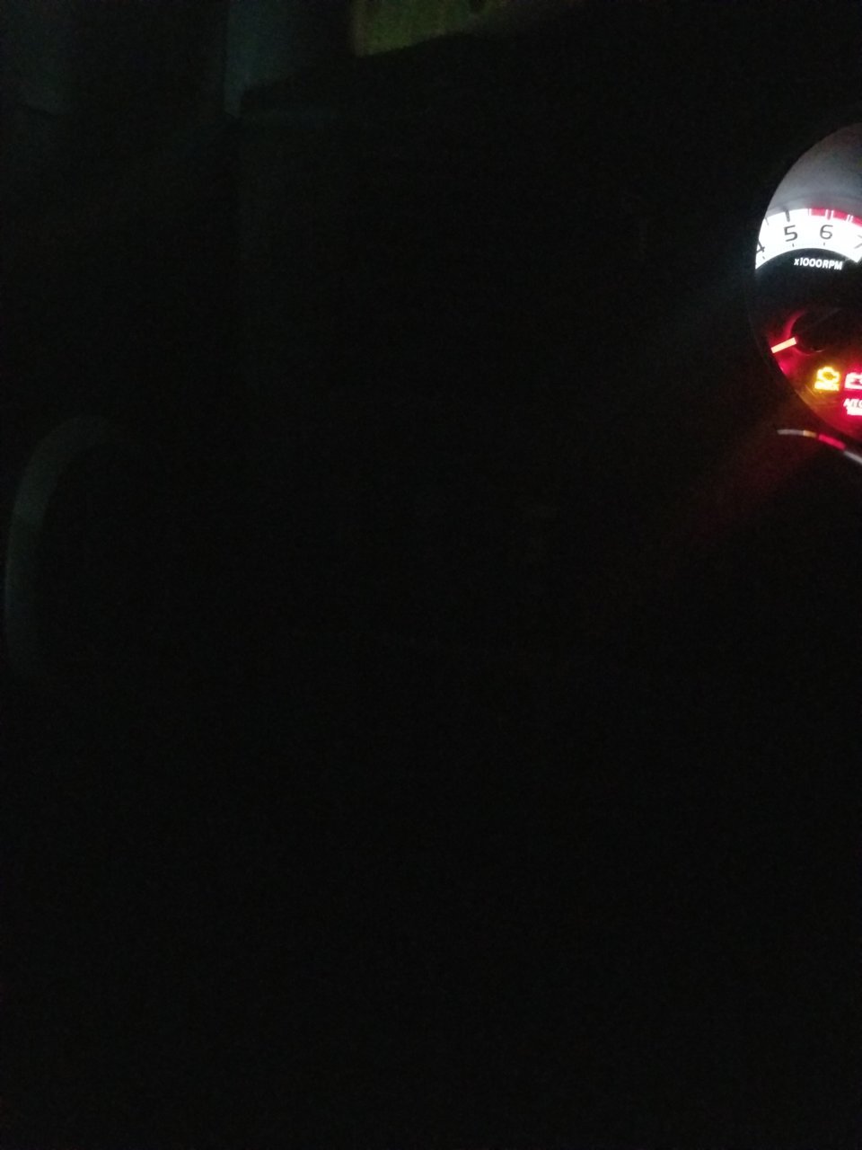

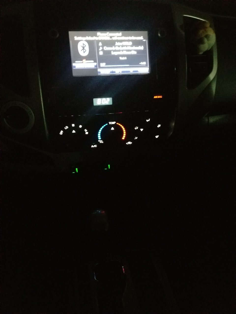

    I tried to take pictures of the working/not working lights. It appears every light to the left of the steering wheel doesn't work, including the fog light button. A/C knob lights are working. As far as I'm aware, the radio is stock.
    Thank you!

    Awesome. Thank you for the diagram. I will re-check that fuse tomorrow and let y'all know.

    Yeah that is looking like a dimmer rheostat issue. It varies the ground connection for those switch indicators, the combination meter, stereo steering wheel controls.
    One thing that seems to work for some is to unplug the dimmer rheostat entirely which should cause the lights to go full bright.

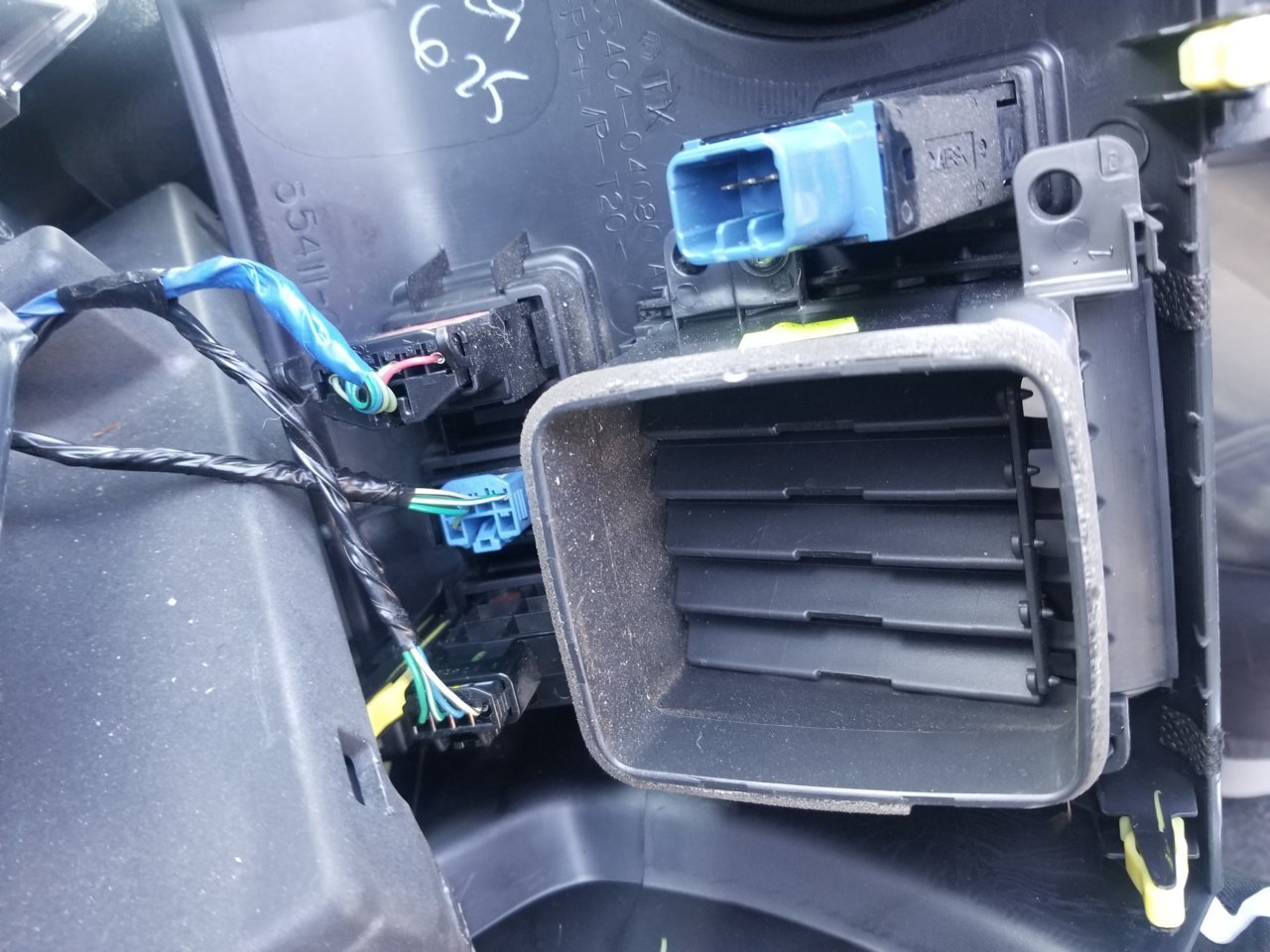

    Took apart that side of the dash and found that my dimmer switch was unplugged already. The plug was plugged into a spare button spot.
    Plugged the dimmer switch back in and voila, the dimmer works and the shifter light works. The hazard button light and fog button light are still out but honestly don't care much about that at the moment.
    Do you know why someone would do this?
    Thank you so much TNShooter and Jimmyh. I really appreciate all the help!
    Attached a picture below. Dimmer is top right.

    Likely someone had it apart and either didn't know how it went or just missed it when they plugged stuff back in.
