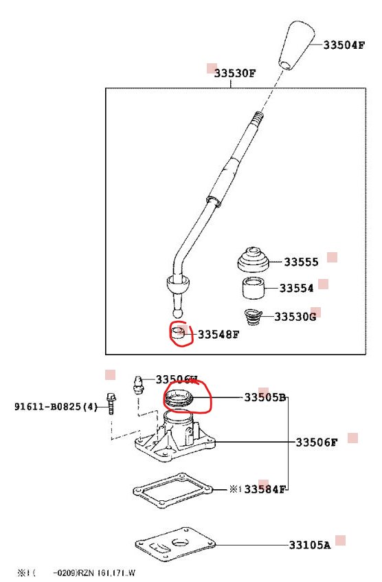

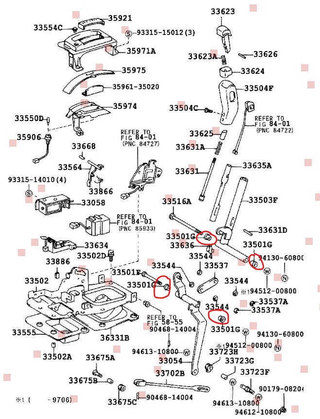

    Both automatics and manuals have bushing/cup issues- same, same, but different.
    Automatic:
    Manual:
  8. Nov 17, 2022 at 8:46 AM
