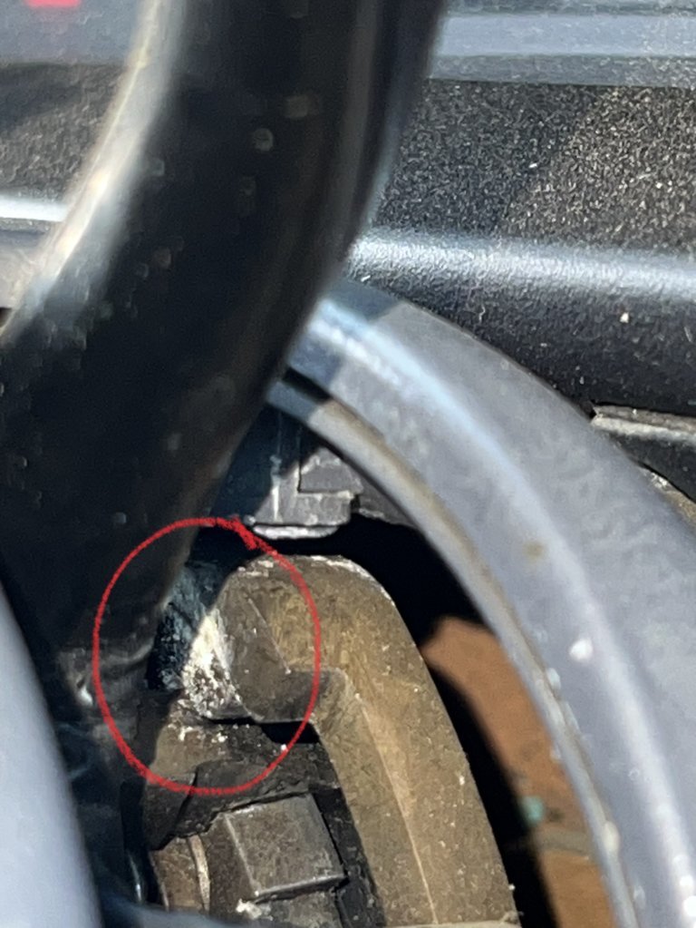

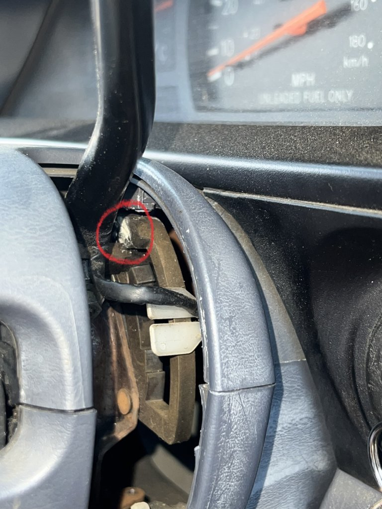

    Hello Tacoma lovers,
    Sometimes when I hop in my truck, the shifter will be stuck in park and I try to jam it down but won't do anything. There's a small black plastic bit right above the shift lever and when I push that in with my key, it'll push it back just enough so it allows me to pop the shift lever out of park. Then it'll repeat itself again once I put it in park and try shifting it out of park. Doesn't happen every time but it's happening more and more often the more I delay fixing it. (Keep in mind, my shifter is a shift lever that is attached to the steering wheel, not the average shifter in the middle). I could be wrong but it looks like the previous owner possibly greased the small black plastic bit, not sure if that helped it or made it worse OR the grease is drying up and that could be the cause of it getting stuck in park. Appreciate any help I can get!

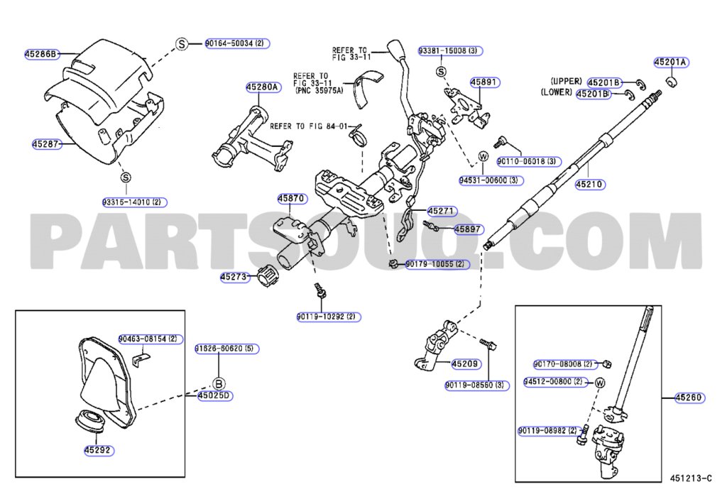

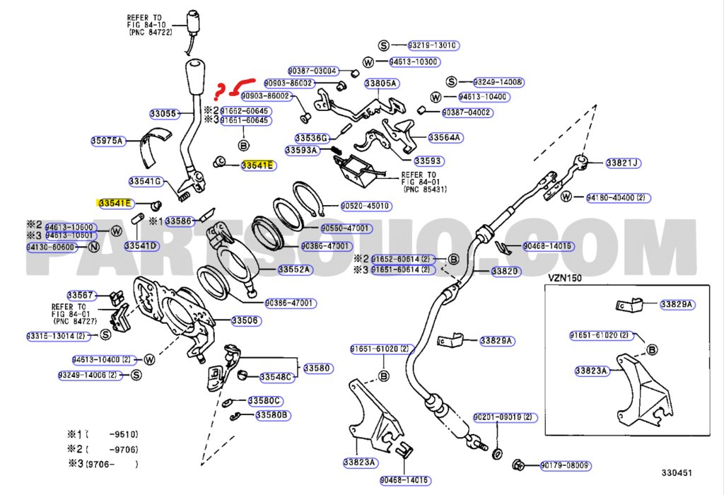

    Hmm, I looked at both and I could be wrong but It doesn't look like the part is there unless I'm not looking right. It's also a non tilting steering wheel which helps matching which diagram it is. I'll have to send a picture when I get home to help better identify the part to you guys

    Here are the pictures of the small plastic but I was referring to. Hope it helps anyone.
