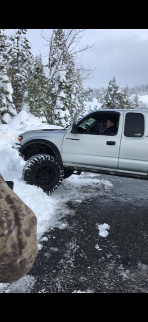

    Hello TW.. having some issues after my recent off-road trip into the snow. Everything was fine when we were stuck, when we were spinning tires, but towards the end of the day I ended up at a dead end and had to pop a u-turn on a single lane, tight road. I climbed up and down the walls of snow in front and behind me until the truck was turned around. When I was already turned around and attempted to put the shifter into first, I heard a loud cranking/scraping noise coming from underneath the engine bay. I couldn't put the shifter into first so I dropped it into reverse. After I took it out of reverse, it would not go back in. Had to get a tow truck to take me home because I could not shift into any gears whatsoever. It shifts right but not left. The shifter moves slightly up and down but not completely into any gears.
    I was wondering if anybody has had this problem and can help me out.. thanks. I can answer any questions you might have, the best I can. I attached some photos from when it happened so you guys can get a visual of the road and truck. Link to when it happened is on YouTube https://youtu.be/OP8LXt2M_c4 .
