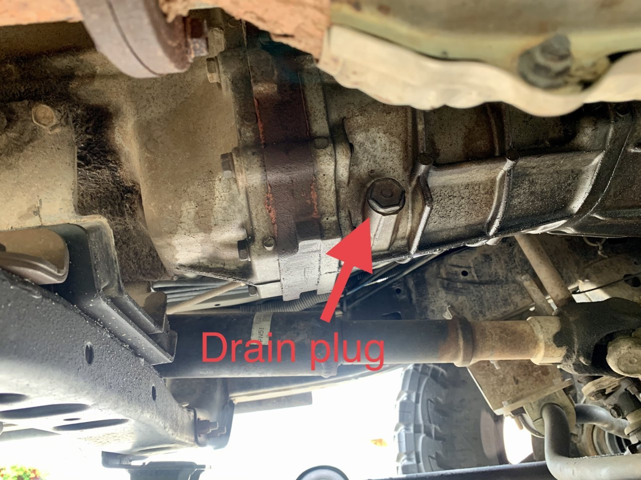

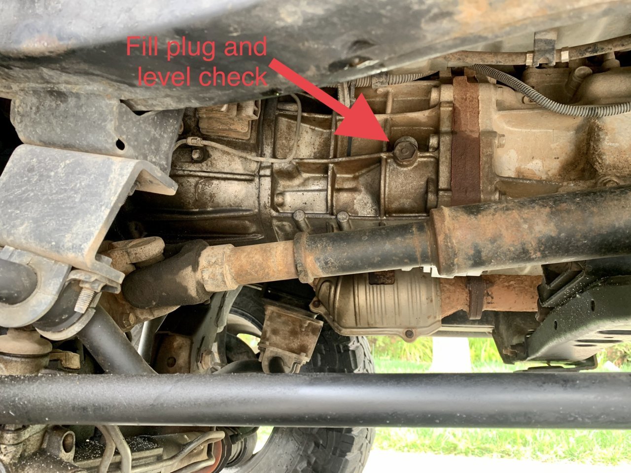

    Anyway, can someone let me know if I got the right idea (below)? Believe it or not, I couldn't find this information in my 300+ page manual.

    Yes. Remove fill plug first.
