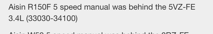

    Can any manual tranny from a V6 1st gen Taco fit my truck? Does anyone know?
    Just starting to look at prices for the entire assembly

    I’ll look in the pdf version of my manual when next to my computer

    Yes and no. Better to stay with the same one you have. There can be some trans output shaft differences.

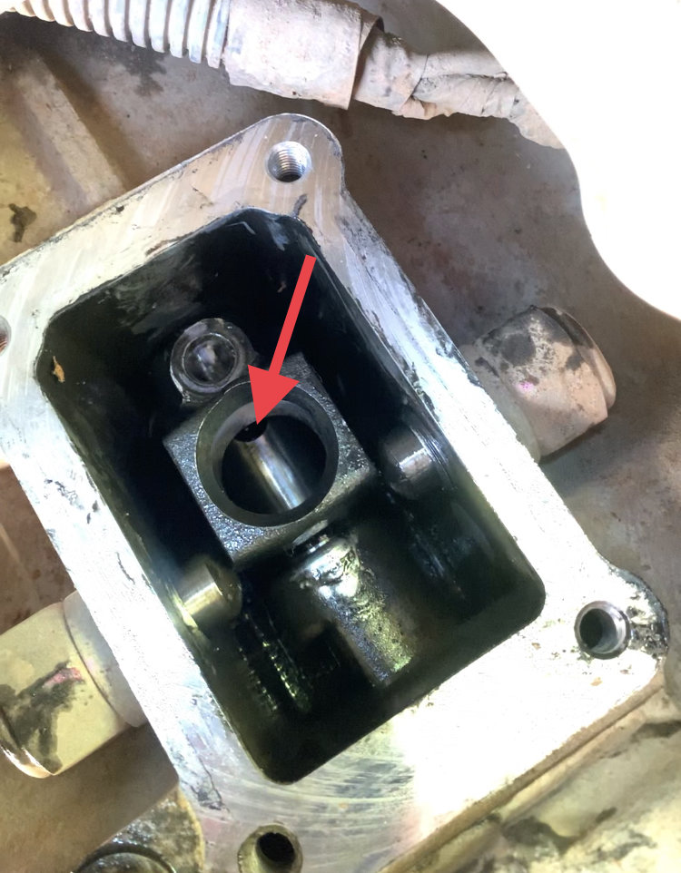

    By the way, this is the furthest you can get from inside the cab, at least that I can find. Just wanted to post a quick pic so others can get educated if needed
    you will see that the top bolt that connects to the shaft and holds the piece which holds the shifter has been removed. We wanted to check if the spring on the right was functional. Once the bolt is back in place, the shifter does not move to the right as previously mentioned. But at least now we know it’s not just the right spring that’s broken on the inside.
    In other news, I’m calling shops for quotes on transmission rebuilds along with clutch and flywheel resurfacing. Looking to be about $2000 for everything

    (Arrow is pointing to the where the installed bolt location normally is, only a little bit of it is visible)
