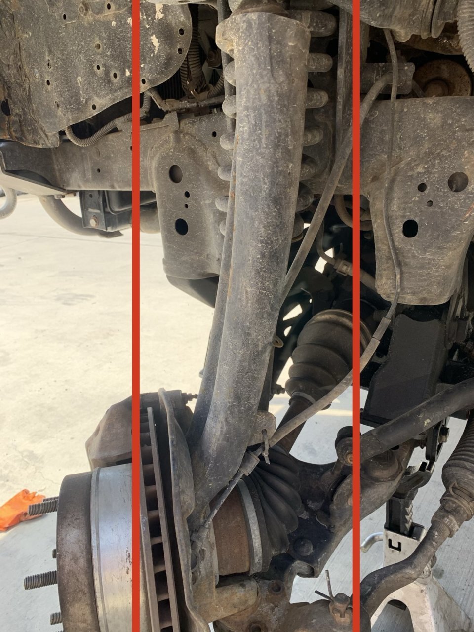

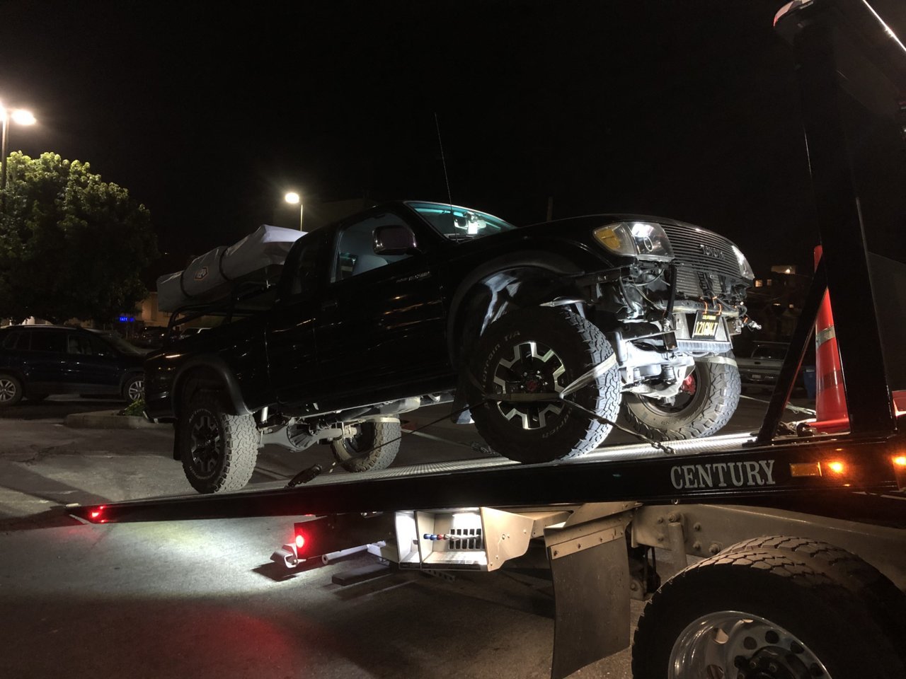

    Lol! My LBJ failed exactly the same way. It broke all the way when the tow truck driver was unloading it from the rollback.
    I was in downtown San Francisco doing groceries when it crapped out. Luckily I just left the parking lot.
    One of the bolts were missing, and it caused the others to fail. It was improper torque.

    Oh man yea good for me also that it was just on the side of my street. He had to slide the truck on wooden blocks up the ramp. So for you, it broke partially in the parking lot and then only completely broke off after he got it off the tow truck? Gnarly, could've broke as you were driving!

    Yeah it broke all the way where the LCA was separated from the steering knuckle as he tried to drive it off the truck. In that picture three bolts are still holding the wheel. We had to get it off with a jack and slowly roll it off.
