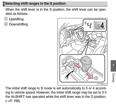

    well, I must have picked the wrong week to quit sniffin glue. I cannot find the instructions that I referred to in the manual. Maybe I read it on a forum somewhere, and thought it was in the manual. But I still stand by the claim that it did go smoothly into "S" 5th from "D" twice. Not sure the actual speed. It does say it will go into 5th, depending on speed, but that point must be north of 70mph. Heres the actual page.

    If you are drive speeds enough to be in 4th or higher, it will always default to S4. Always. Been using it for months and has never defaulted to 5th.

    but but but....Toyota says it will go into 5 at some point. Tell ya what, I am going to get it up to 75 today and try it. If it drops into 4th at 75, I'll give up. Thats gonna be about what, 4500 rpm.....redline is 5500....should be fine. Yeah...I know what happened to the curious cat !

    The book says it should. That's why there is a thread on this
