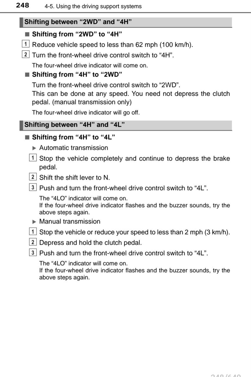

    Manual Mall Crawler
    Page 248 of the manual...
    Shifting into 4wd, you need to be below 100kph...
    To shift back into 2wd, you can be going any speed.
