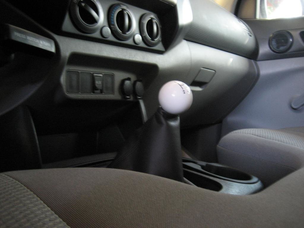

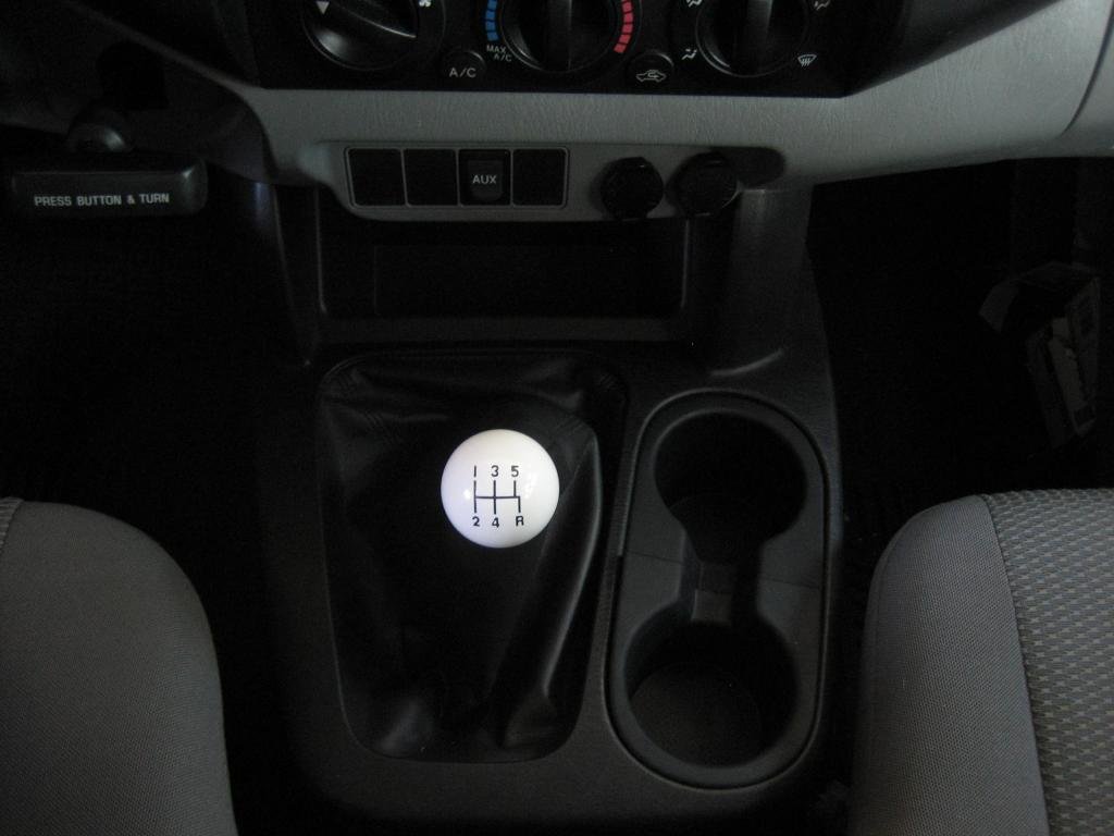

    Aren't they the same transmission? I took the chopped shift lever off my 17 year old gen 1 and it fit perfectly on my 2012 gen 2. :)

    A heavier shift knob helps with smoother shifts also I've noticed. I had an aftermarket one on my 2011 and it helped a lot.

    Feel can be improved in a number of ways. Heavier shift knob, synthetic fluid, proper clutch pedal adjustment, etc. A shorter shifter, but one that leaves the original fulcrum point, can actually make shifting harder. You may be changing the distance your hand moves, but the actual 'working' part is moving the same distance as it was, so you'll disadvantaged your leverage. But they do look cool.
