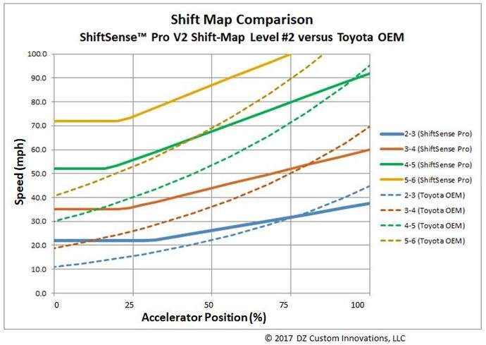

    Does this unit still let the truck shift up into a high gear when you're coasting/descending/driving on the flats with light throttle? Or will it simply not use 5th or 6th below a specific speed?

    Yes it'll hold the gear but most of the time the speed setting is faster than I'd like.
    I find it doesn't do engine braking very well here in the Sierras, so I'll just kick it down myself.
    Not sure if that's what your asking.

    Thanks. Guess I should have spent a bit more time interpreting that graph when I first read through the thread, but by the time I'd hit page 100, I was a little punchy :). Yeah, that answers my question. For light throttle driving, it looks like the truck is going to be turning higher RPMs than with the factory shift profile, since it will be holding 2 gears lower (e.g. staying in 3rd gear when going 30ish mph at low throttle instead of going up to 5th).
    Interesting that quite a few folks say that their MPGs didn't really change or even went up, since usually higher RPMs mean more fuel consumption, though I might be oversimplifying. Maybe all the lugging that happens with the factory profile hurts the mileage.
    Regardless, I'm pretty sure I'm going to order one of these. Not a day goes by that I don't curse the bizarre shifting behavior of my AT. Wish I'd bought a stick.

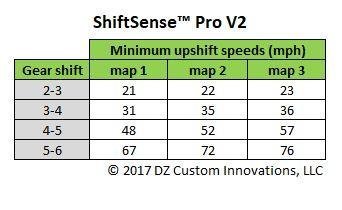

    OP... is the number 2 map, equal to the regular ssp. chip number 2 map...

    From the FAQ...
    Level 1: Lower RPM shift points, less aggressive.
    Level 2: (default selection), optimized for all around performance and has been the baseline programming on prior units.
    Level 3: More aggressive shift map, designed to achieve slightly higher RPM for performance driving and trailer towing.

    To access the modes you turn car to aux and program it to mode you want. Tskes about 10 sec. mode 1 is what most of us use, mode 2 is normal, mode 3 towing. But you cant simply switch from mode to mode. Once you program the mode you want it stays in that mode tell you reprogram it
