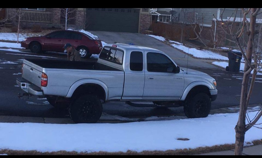

    Here she blows Capn' - The day she came home to me. $5000 at a sketchy mom and pop loan shark dealer in Colorado springs.

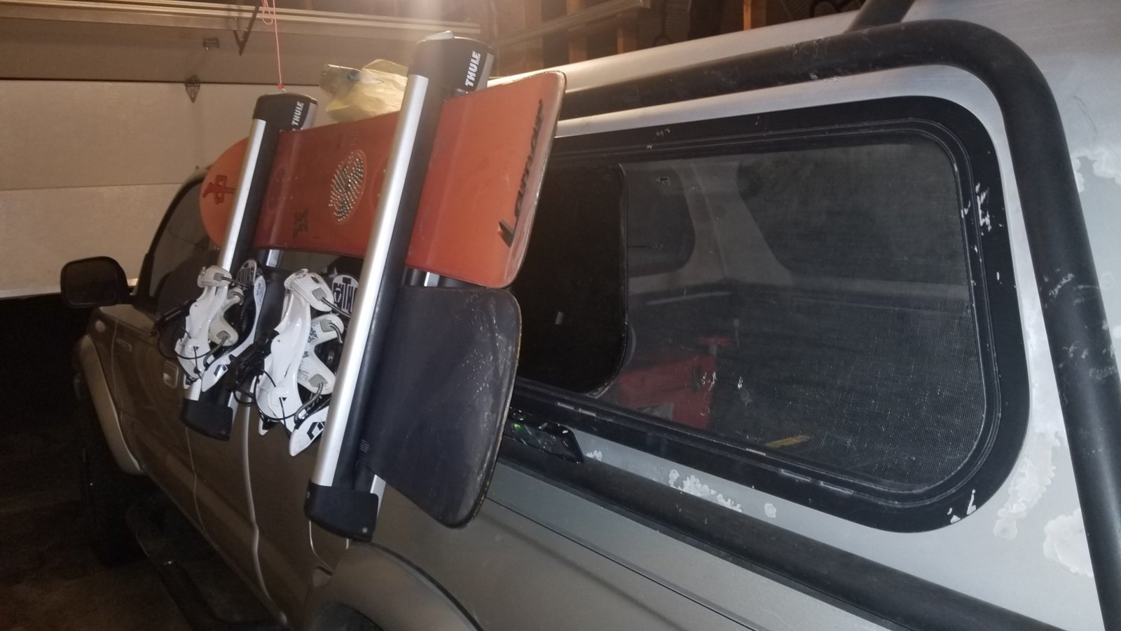

    I slapped some thule ski racks on the side, Worked most excellently, Left ample room for me and the mutt to sleep on hwy6 before the no camping signs arrived outside of keystone and A-basin.

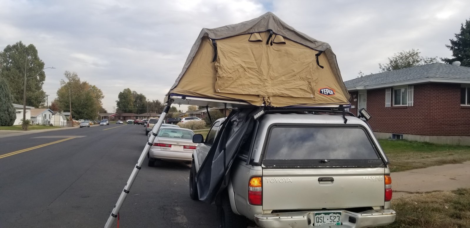

    October 19' I finally bought a RTT, Dude off of TW as well! I loved this tent with my heart. Used it religiously.

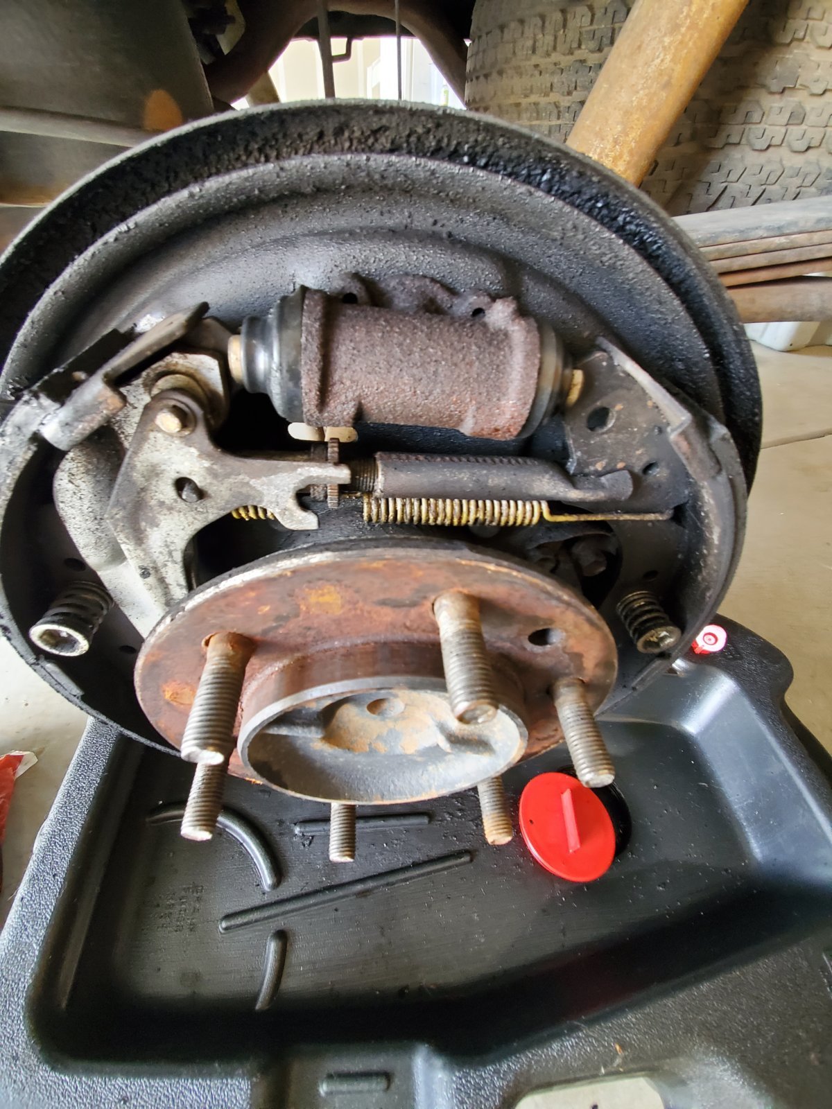

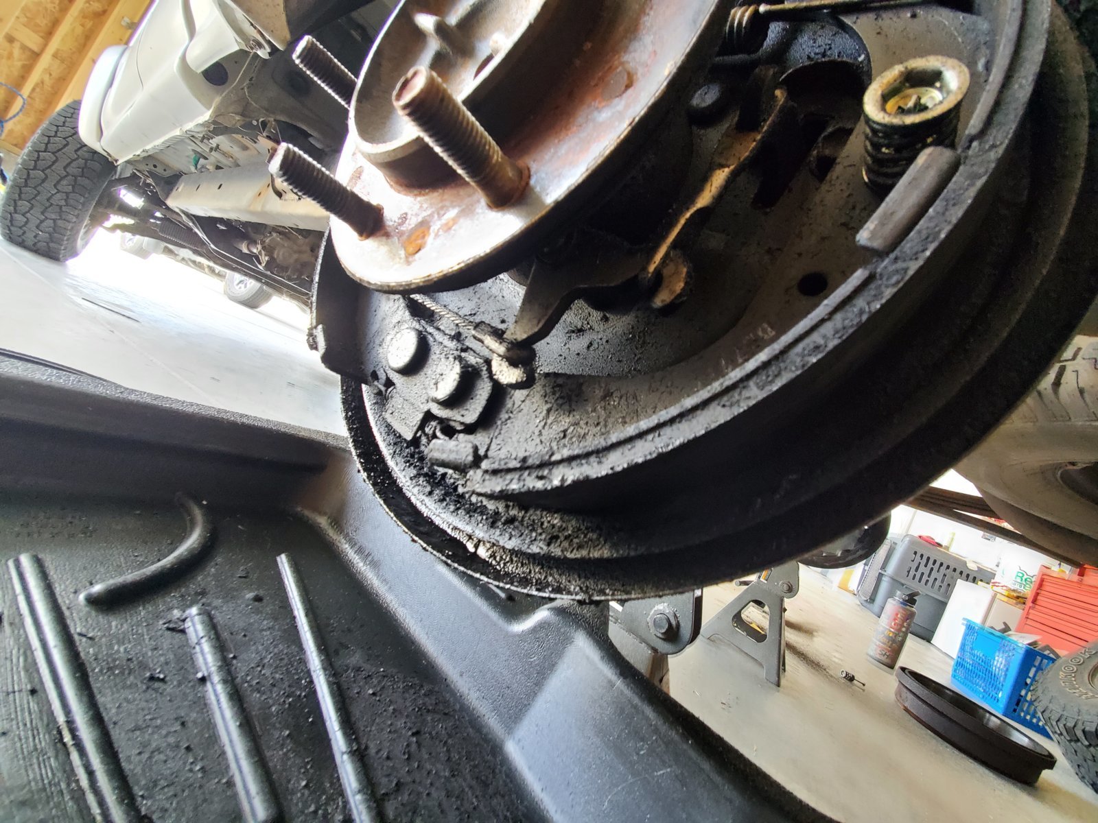

    New Drums, shoes, hardware and wheel cylinders were in order. I was driving up the Poudre when suddenly I lost brake pressure 1hr into the canyon. My camping trip ended before it began, I had to engine brake out of the canyon and get the truck home to the garage to figure out what happened. The wheel cylinder pissed all my brake fluid out. good times.

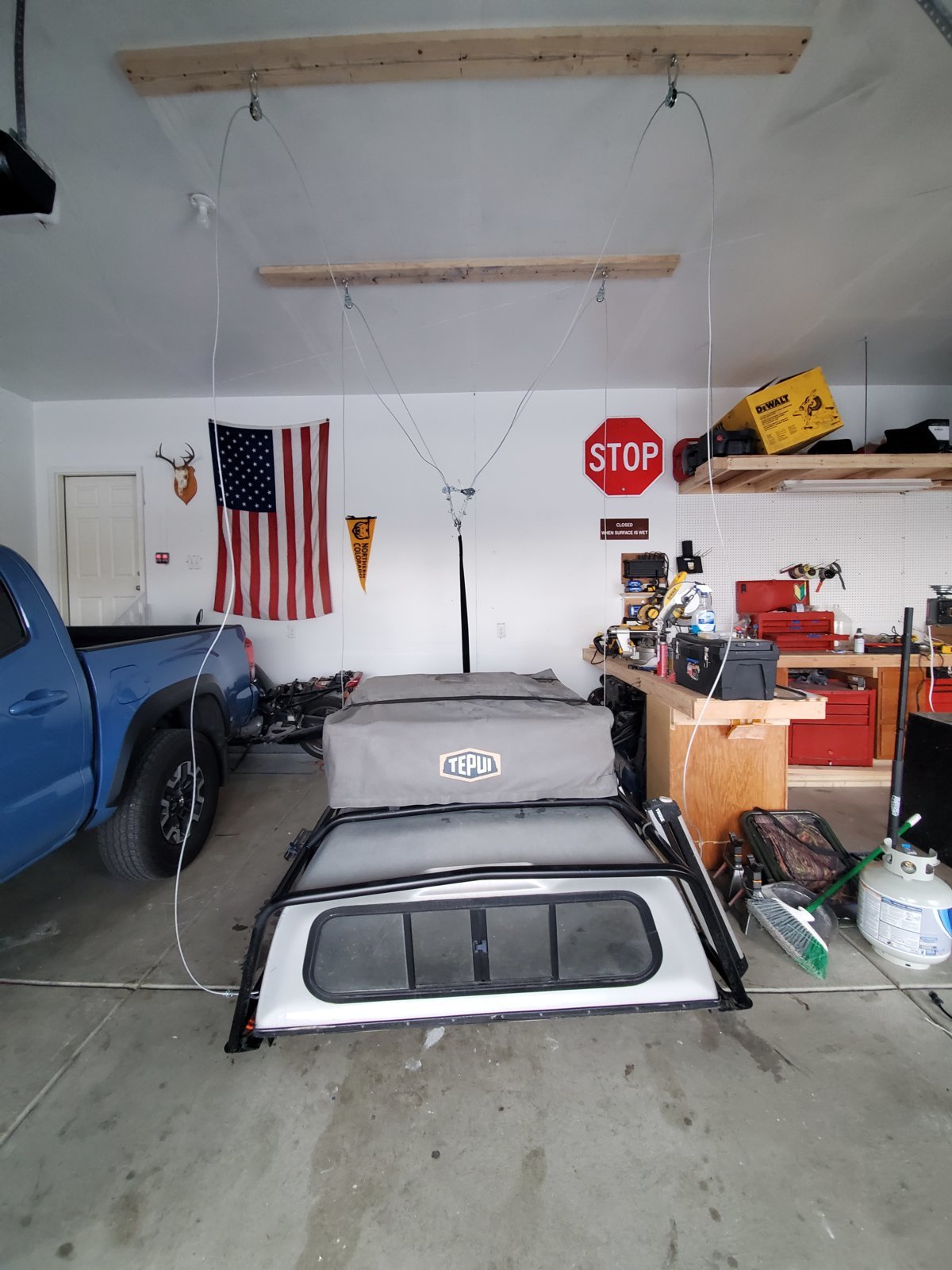

    My DIY hoist almost killed me. the eye bolt ripped out the back wall releasing a ton of slack. The cap came crashing from the ceiling to the floor. I've re-engineered it since, without fail, but still scares me to use it lol. Also big shocker the rack and topper was undamaged from an 8ft fall.

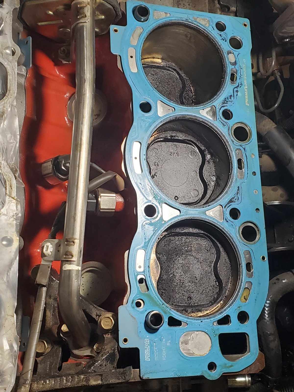

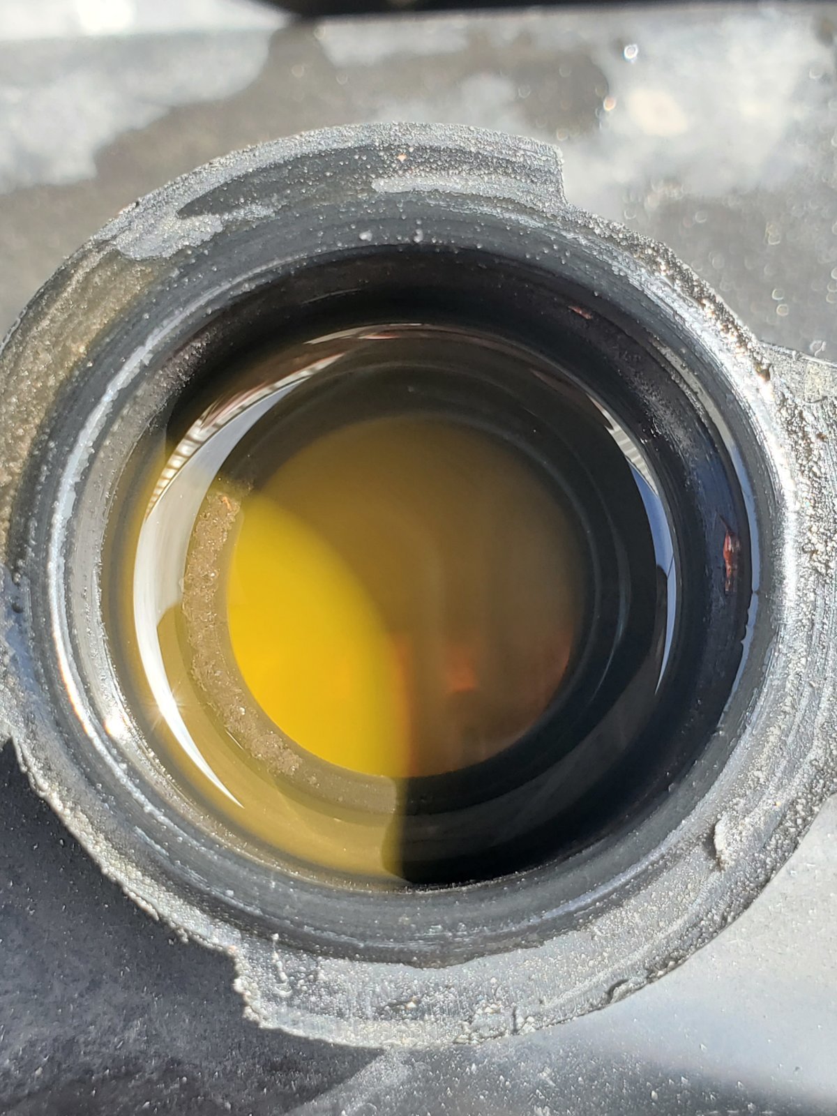

    Headgasket failure identified. (later on at least, in this moment. the truck was overheating and I didn't see this coolant yet).
    During a 9hr drive to my best friends house in NM. My truck began overheating near Trinidad. This probably marks the start of my active engagement with the TW community.
    Luckily the outside temp was so cold (blizzard @ -5 the whole drive) I was able to limp the truck another 4hrs into NM to his house to sort out the problem. I then harassed the Colorado BS thread for what could be the cause of my overheating issues. After a new Toyota waterpump, Thermostat, Full core aluminum radiator. I found that I had incorrectly installed the headgasket on the driverside head. The port was plugged by gasket material, and coolant wasn't circulating properly. It's a wonder how I built this engine 2 years prior and it took that long for it to fail.

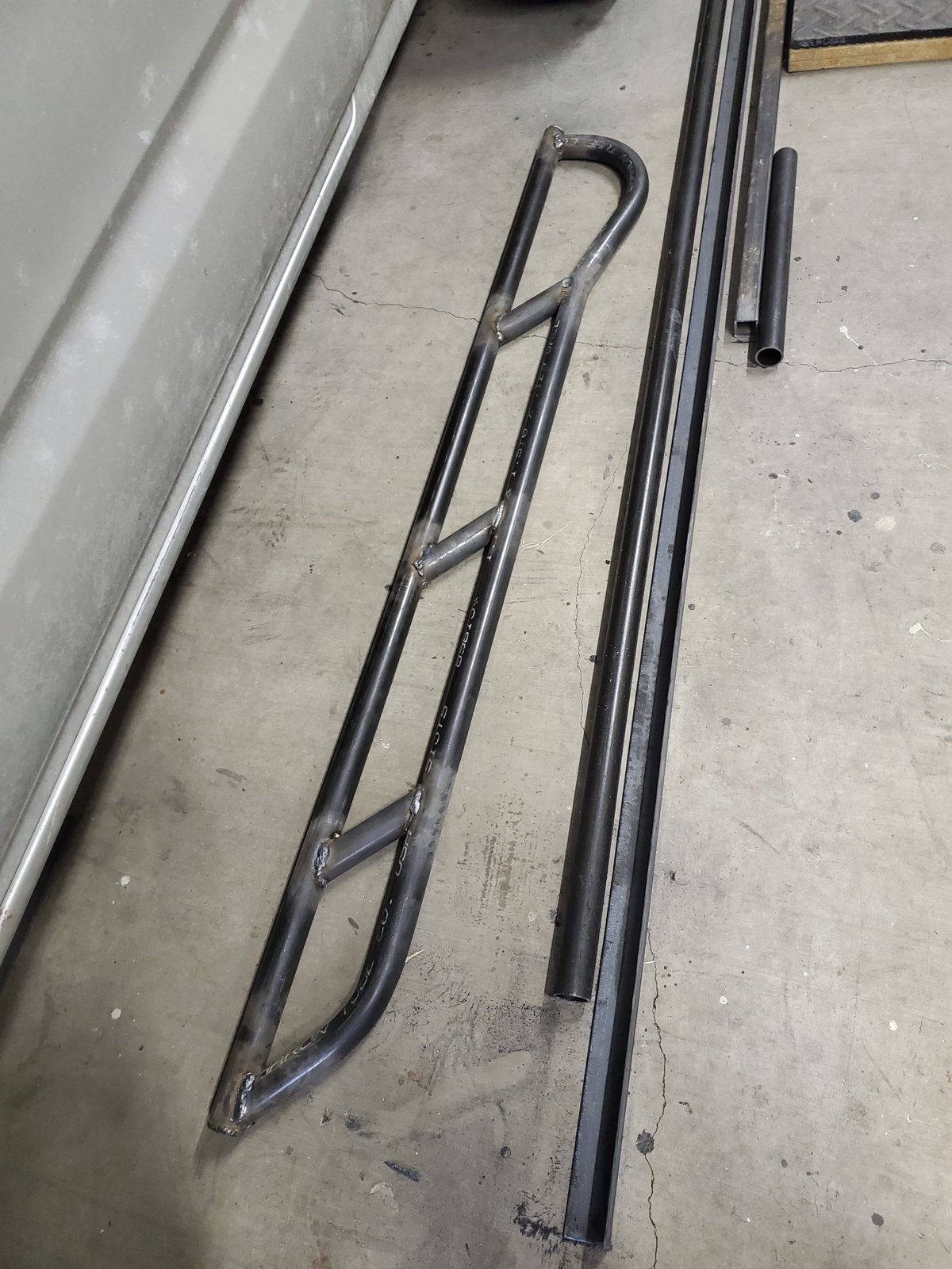

    February 2021- I had driven down to See Jake who was living in NM at the time. I bought him this Tube bender as a house warming/birthday/thank you gift for the following work.

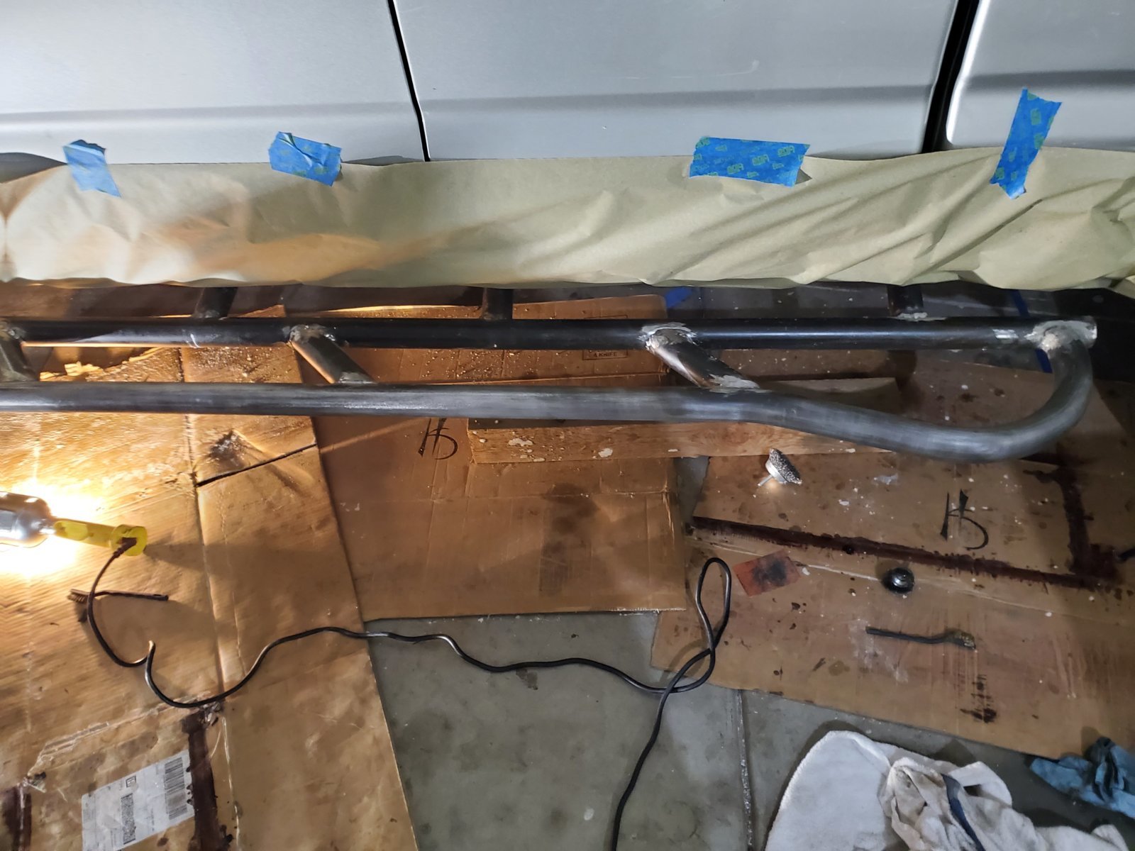

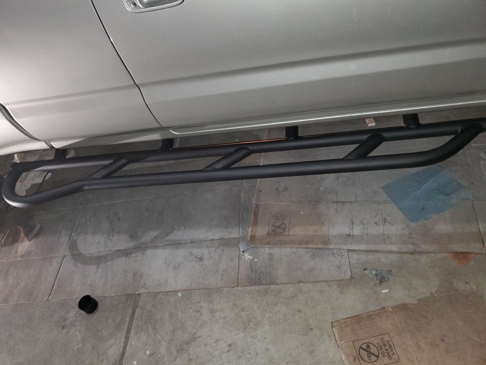

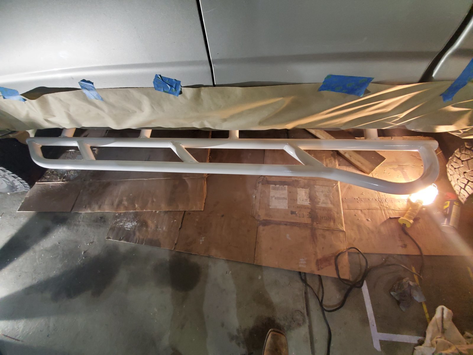

    He taught me how to weld here, and we skillfully built sliders in a day... A very long day.
    I think this photo was at 04:00. lol

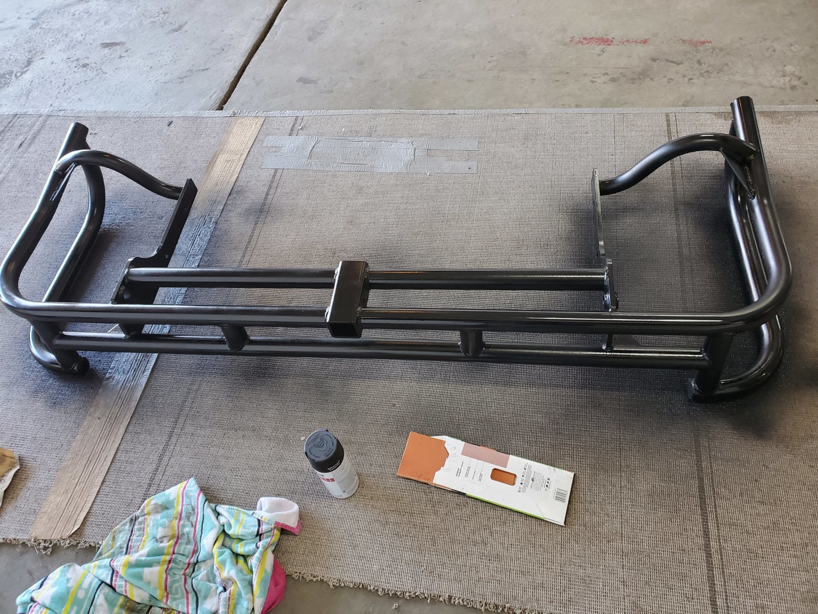

    I then drove through another blizzard home to paint these bad boiz.

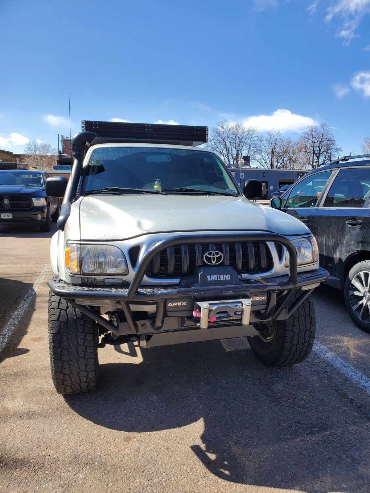

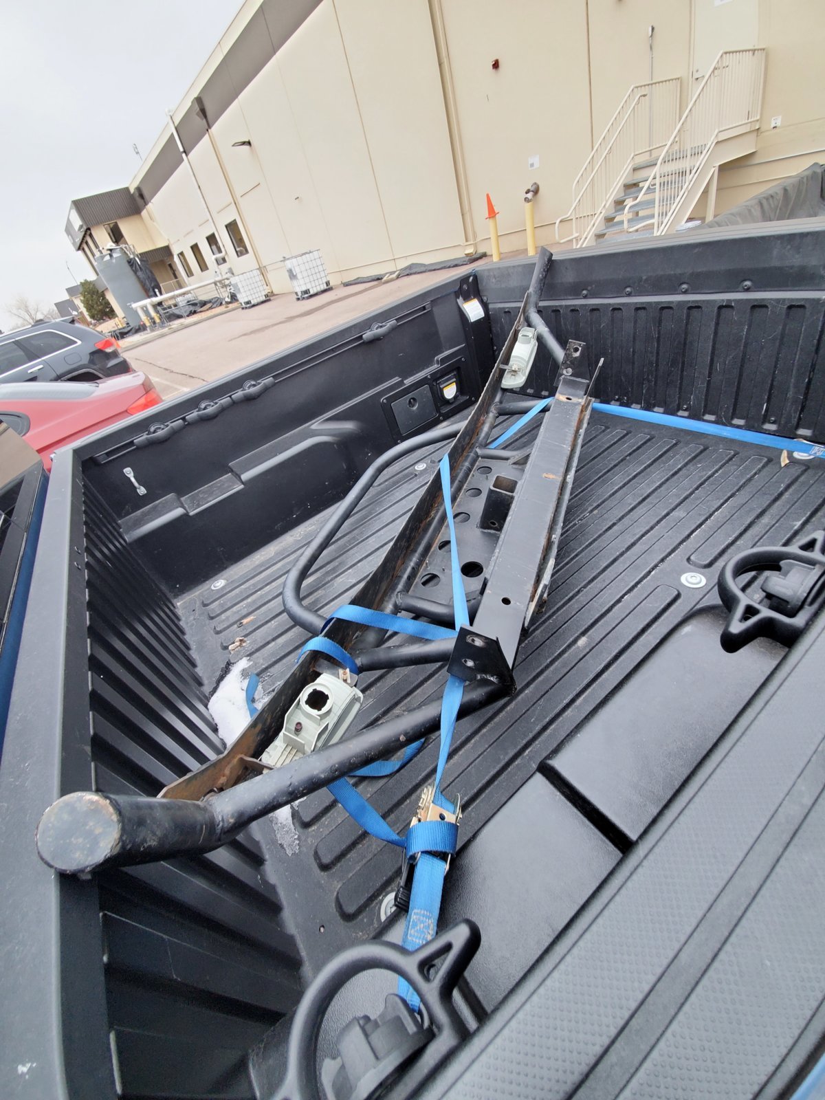

    AND HERE WE HAVE - you guessed it! Another TW find. 200$ bumper from a cool cat in Thornton IIRC.
    Mounted in no time, and taken up to storm mountain for my proof of concept. ALSO my neighbor gave me a set of 33s he was looking to offload. So here is their debut.

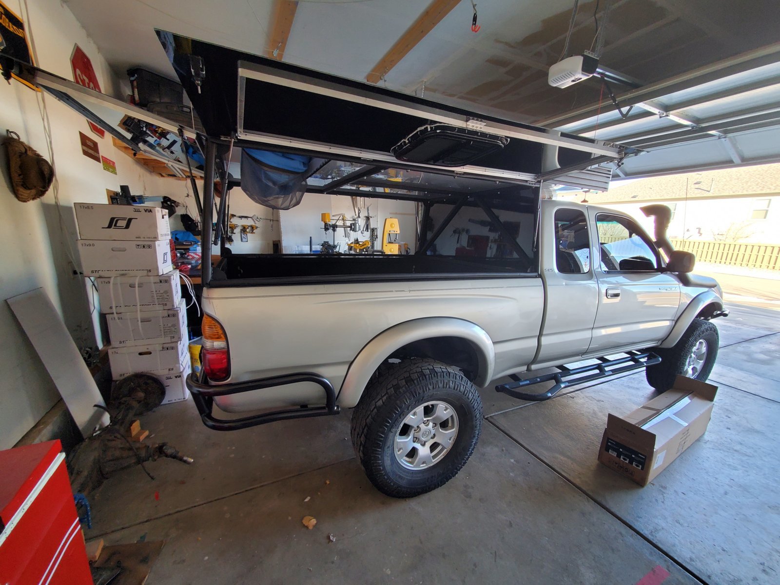

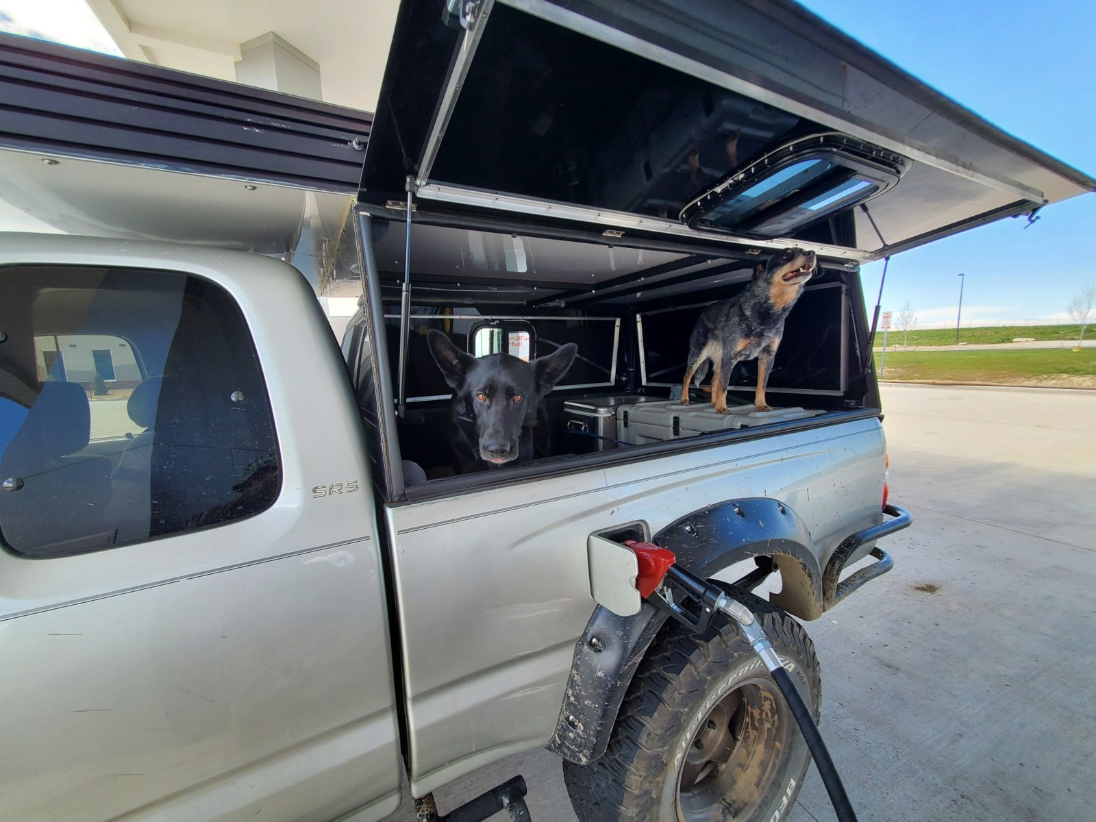

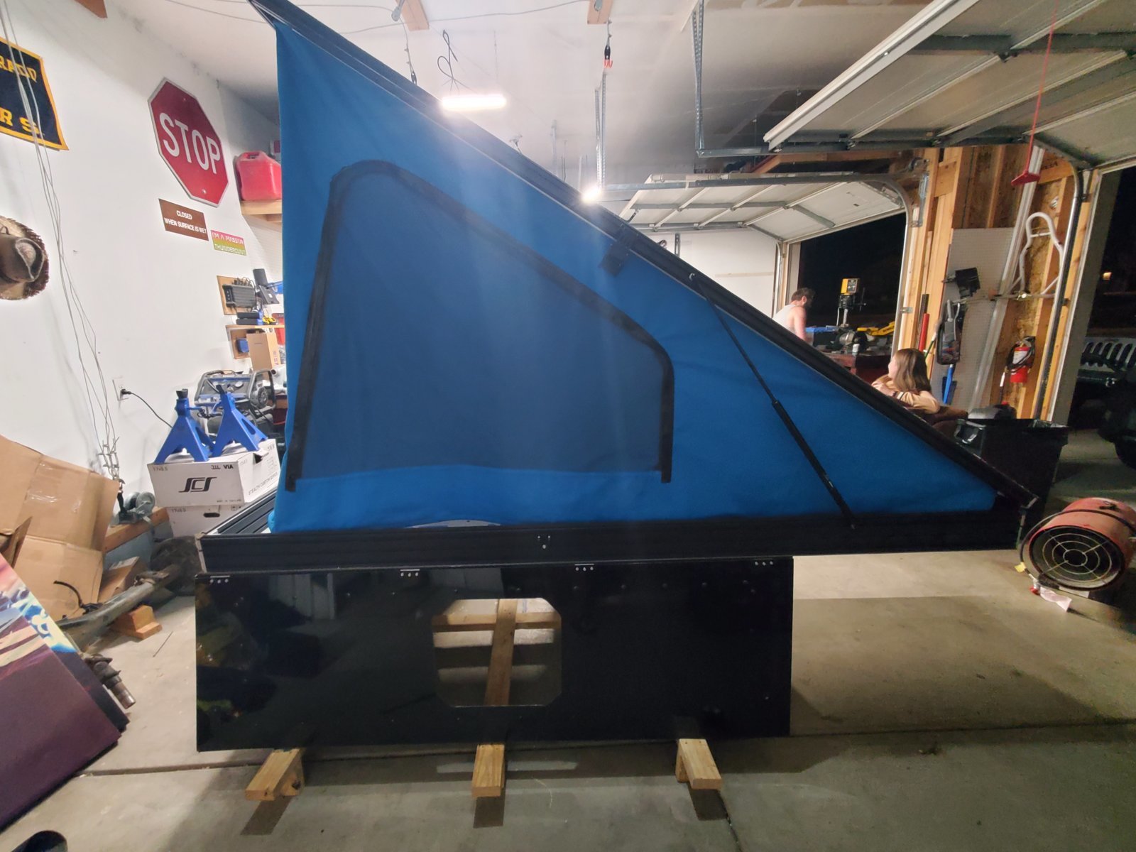

    February 2022- Jake did the bult of the leg work on the topper as I was travelling for work to much, and the shop space being used was his. A quick test fit on canvas, needles, and rope, And bombs away.
    Summer 2022 -Jake and I chopped up the bumper to squeeze this 12000lb bitch in there.

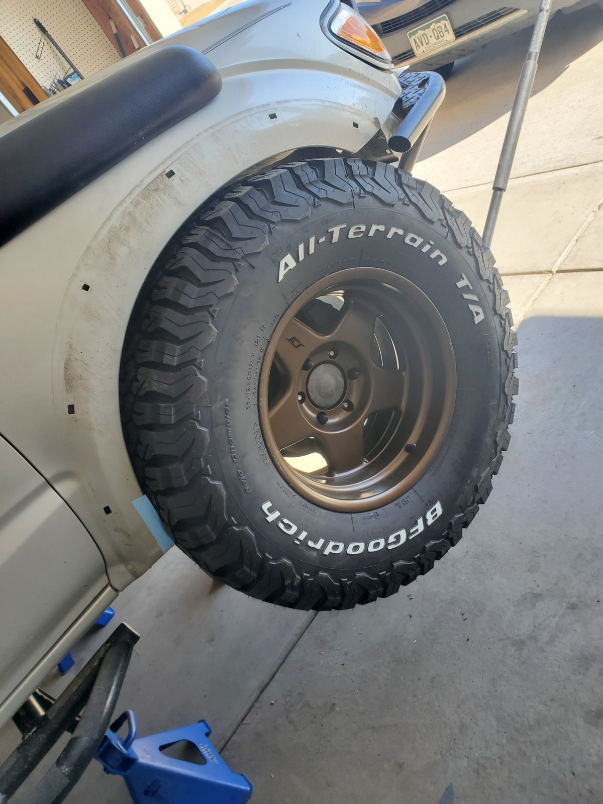

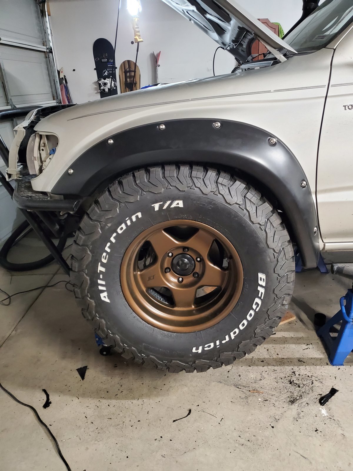

    April 2023 - It was now time for 35's and new rims. - though these pictures skip the entire suspension remodel which was done in Feb2022. We will get there later.
    The rims took FOREVER to come available. I spent forever trying to spec out my rims and tires for optimal fitment. I wanted to move on from wheel spacers, having 1.25" spacers i needed -39mm offset to replicate the tire spacing I was already running to proceed without spacers. SCS F5's were the best bang for the buck and I liked the look. Just had to wait for them to come into stock. The tires are purchased, mounted and balanced, here's the look.

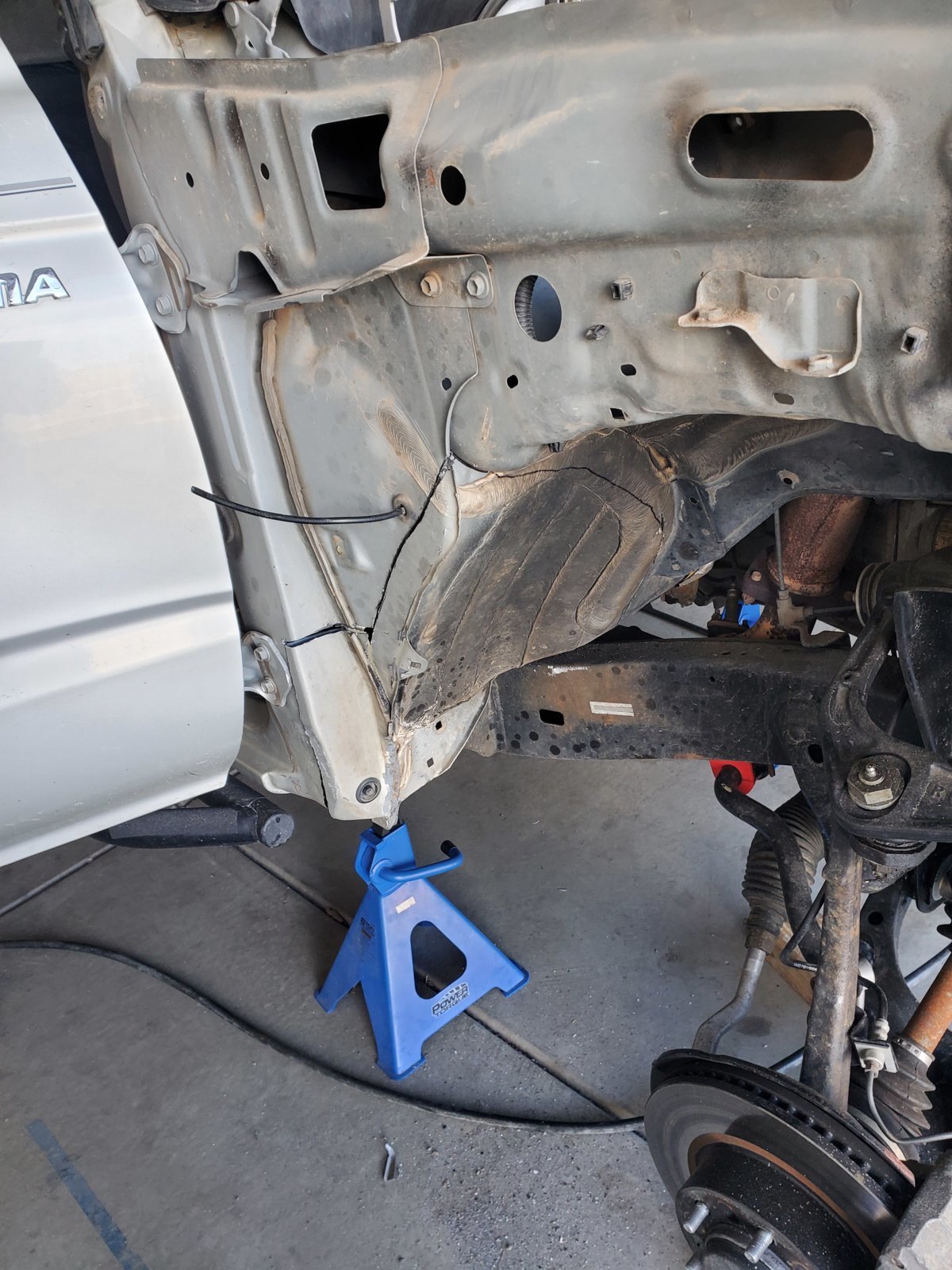

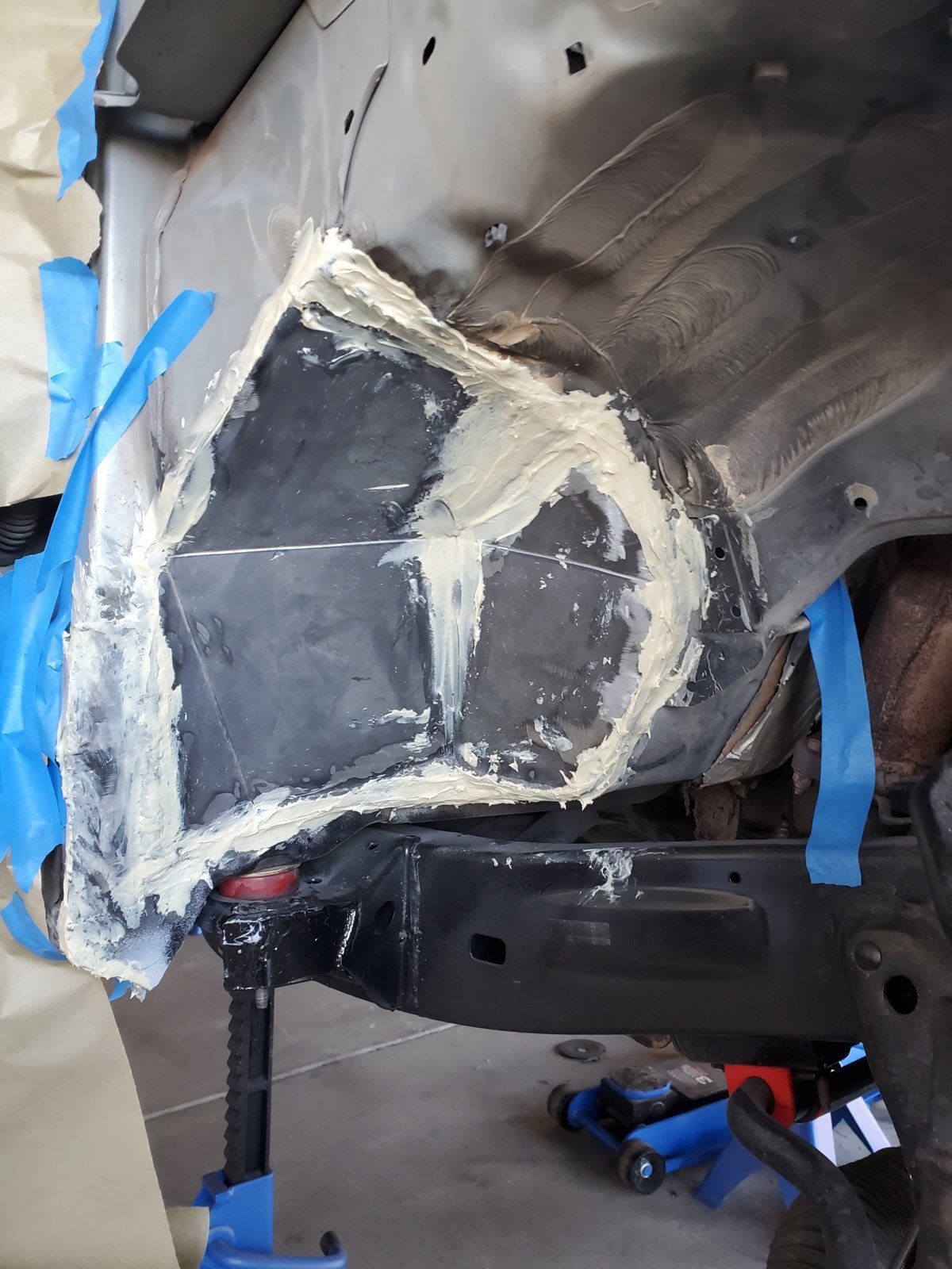

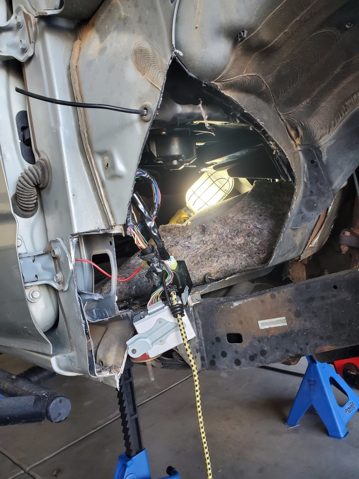

    Fenders come off, hack saw comes out, 16ga 4x8 sheet of steel was purchased. And with the help of the Colorado BS thread I made some shit happen. Did the washer reservoir mod due to the need for space.

    With the fire walls chopped and welded back in, I then chopped the fenders bare and clean to fit. Lastly, being a single adult with no children, I purchased the bushwhacker fender flares because, fuck it, I've gone this far, whats another $400? What's despicable is I chopped these brand new fender flairs up just the same as the body.

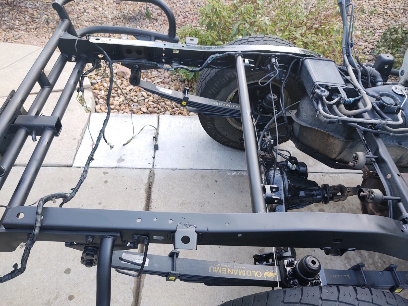

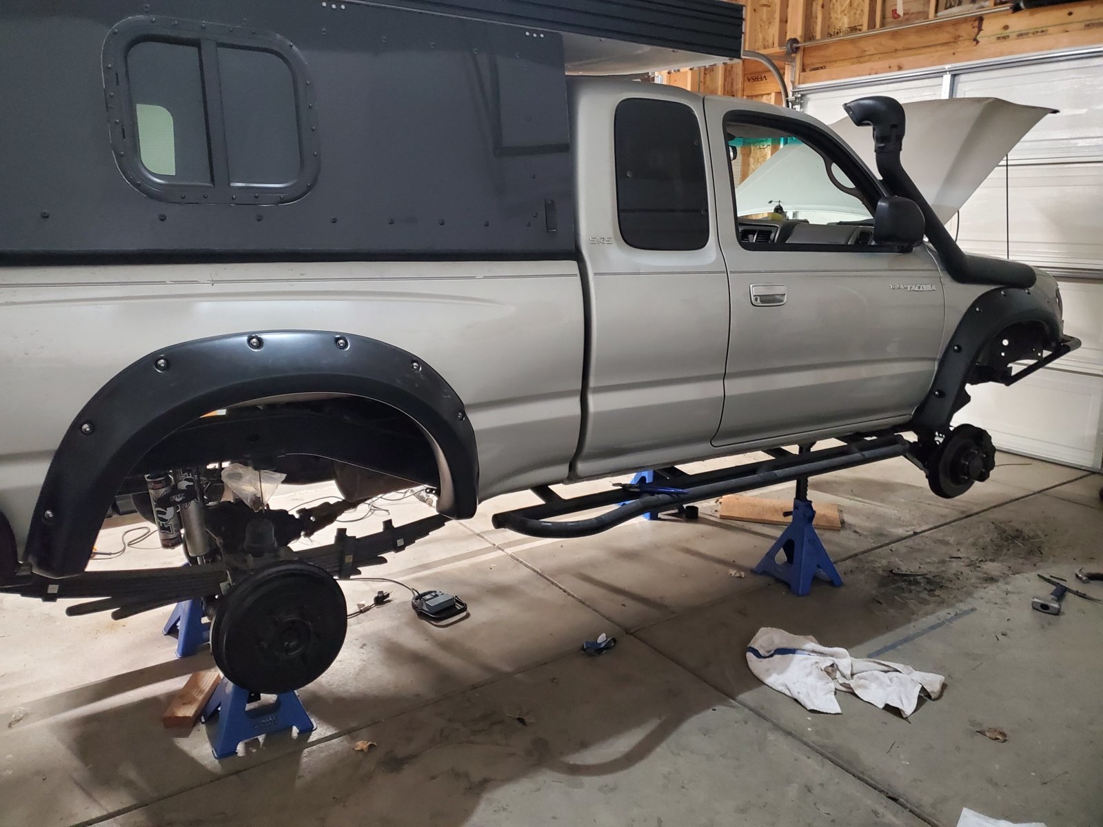

    What is skipped here that I can't seem to find photos of is the suspension/driveline upgrade. Photos will be dropped as soon as I get em'.
    I picked up a factory elocker axle from Tim with 4.88s I ordered a front pumpkin with an ARB locker to match, for coilovers we went to Toytecs, durobump stops and durobump bushings for the front axle mounts. full body bushing change on Energy PU bushings. New LBJ/Tie rod ends even changed the steering shaft seal on the firewall as well as the rack and pinion ujoint. New leafpacks as mine had disintegrated with time, and rear shock relocation/ubolt flip. Lifted the truck 2" and went to a front and rear locker set up in a weekend of assembly.

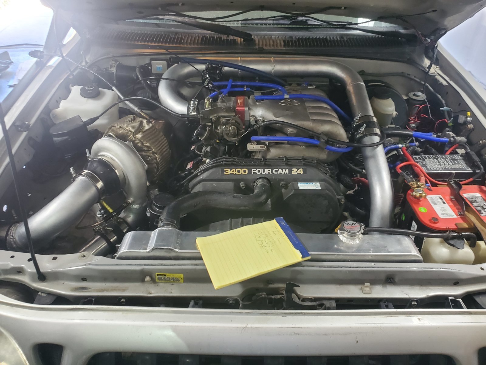

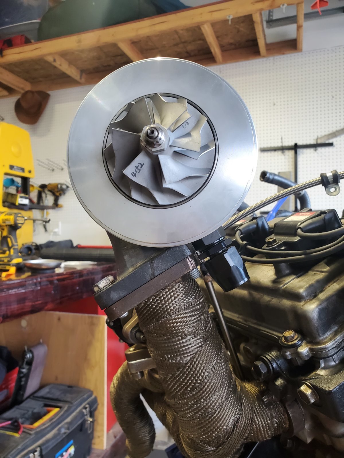

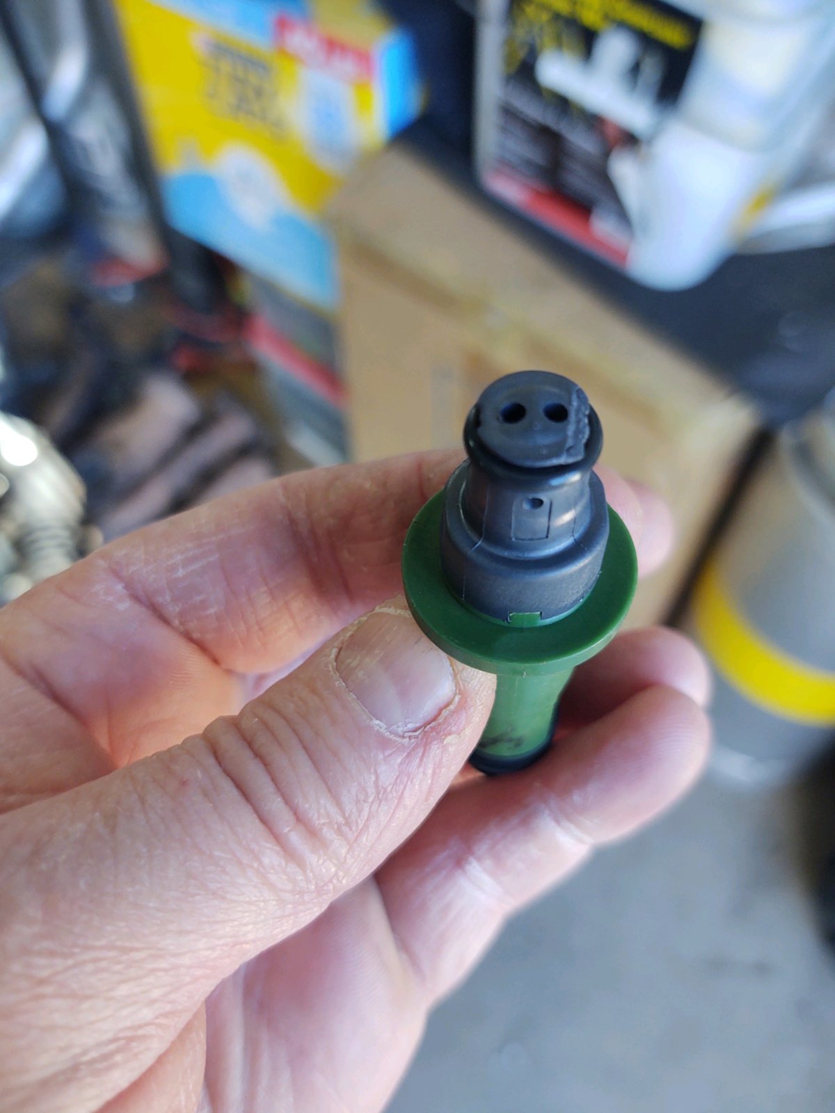

    So then this happened. another 6k later I had slapped a Cx racing turbo hardware kit into the truck with a haltech 650cc injectors and precision for BOV and WG.
    This little injector arrived damaged, I photographed it before installing it should it give me trouble in the future I wouldn't forget which one it was.
    Skid plates fit with the intercooler safely housed inside. The piping however sticks out a wee bit.
    Broke the cycle, First test drive was on old flowers road this time. Not storm. Not a problem was found.

    I have questions... what happened to that green injector pintle cap?

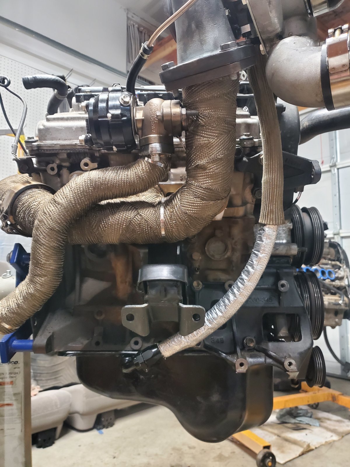

    Ended up seizing my motor while on the interstate. Have been on damage control. Oil return line melted off the tube.. no oil no running lol
    That injector came out the bag with a no.4 sharpied on it and had that damage to the face. I documented it in case it gave me trouble. Considering it was away from the spray face I didn't think it needed replaced.
    What happened is unclear to me besides bad qc

    Wow I'm sorry to hear that, and that's some odd timing too. I literally just replaced my drain line because I felt it the other day and it felt crispy where it was close to the header.
    I used some Parker hydraulic line and some DEI heat shield sleeve this time. I hope you can find a good swap engine.

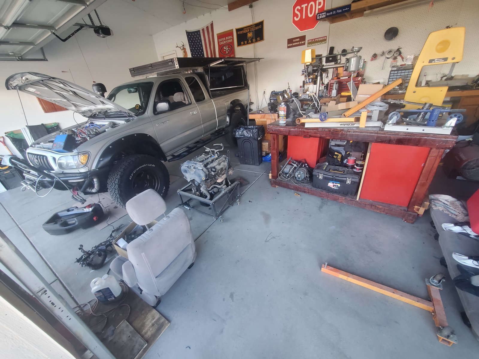

    Engine took the long nap.

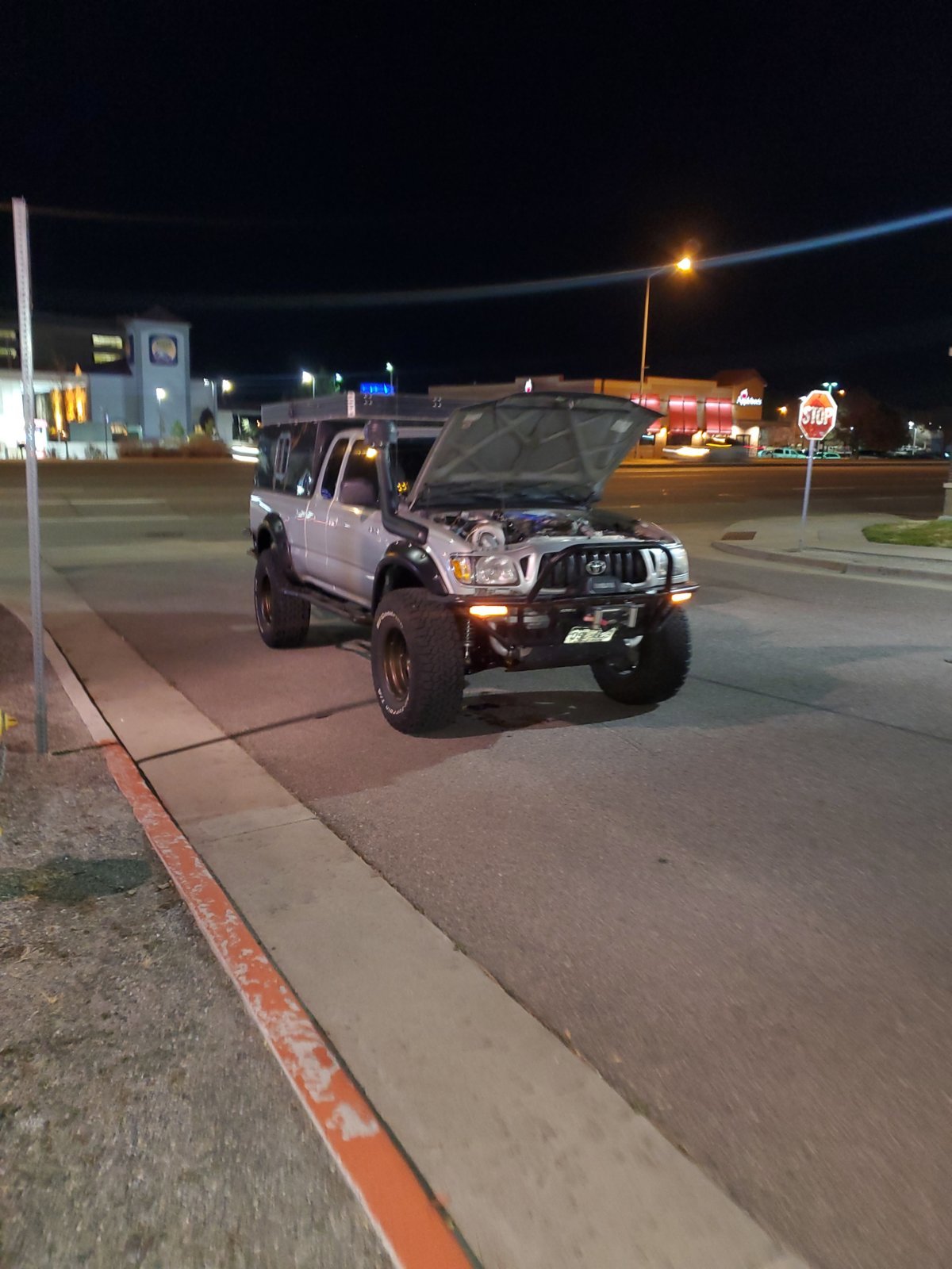

    Northbound i25 leaving the airport coming home from a work trip; I noticed what I thought was smoke out the rearview camera, moments later the Oil pressure light came on, I kicked the clutch threw it in neutral and promptly before I could shut her off the motor seized itself.
    Coasted off the highway, off of 120th and i25, Popped the hood and found the oil line as pictured.
    Met a really cool dude named Chris, He offered to help, went home for a tow strap, came back in a bad ass Xterra, Proceeded to hang and talk shit with me while i tried to refit the line, add oil and pray it started. IT cycles, but somethings dead, wont ignite probably slipped the timing? - Chris ended up towing me home the next morning on his flatbed. What a fucking GUY. Refused any form of thank you/payment. I will be buying him whiskey when this is corrected.
    Pushed the truck up the driveway/into the garage with my roommates jeep. Lol
    peep the engine stands pre assembly.
    As of Monday night this is how things are now.
    My meticulously cleaned engine bay is PAINTED in motor oil now, really the entire passenger side underbody. Shits dripping off the bed in the garage still.

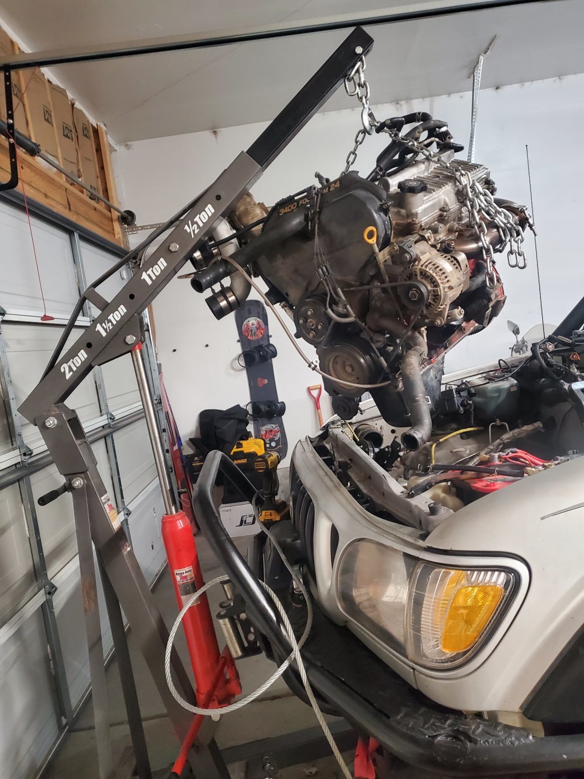

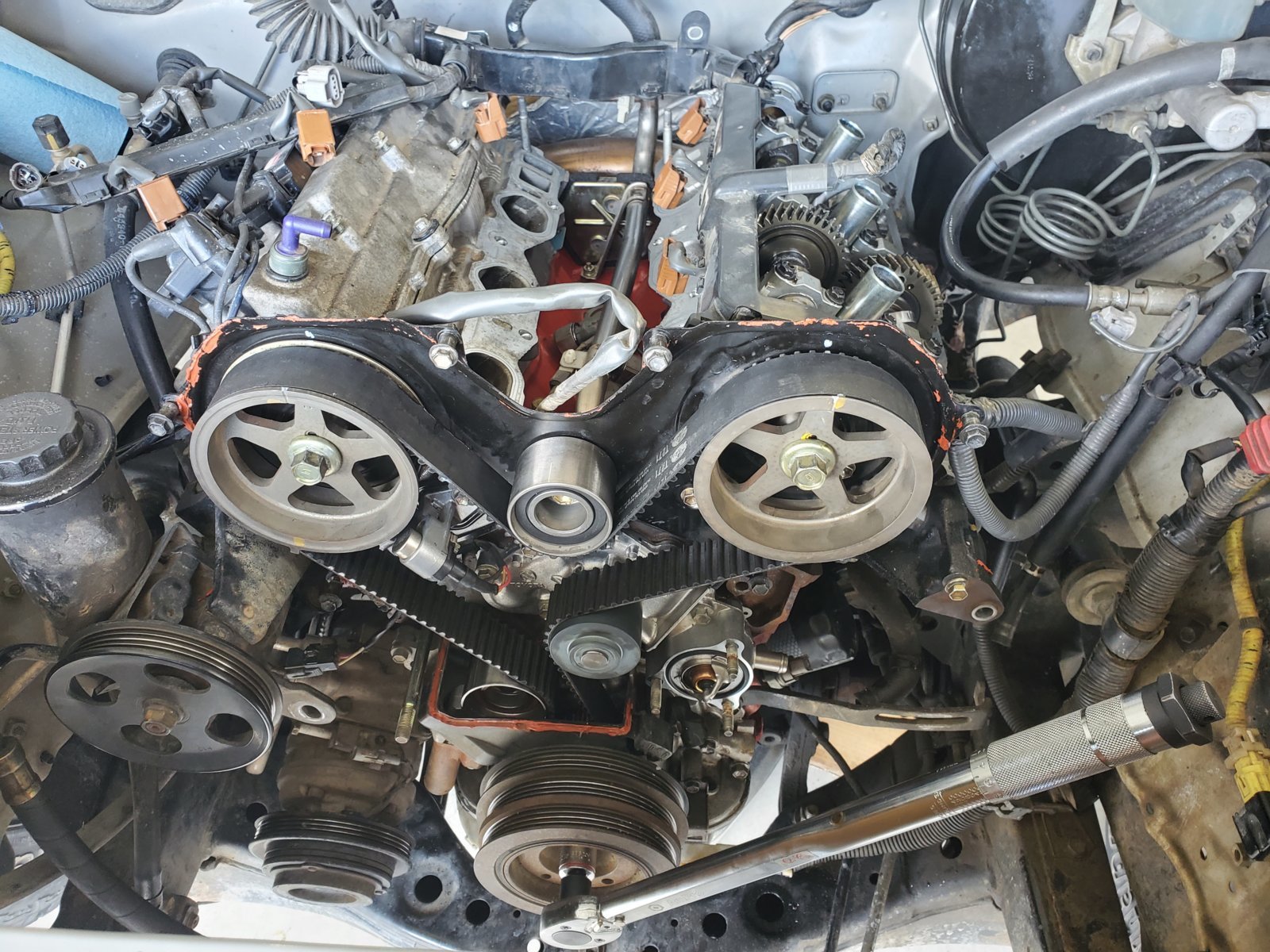

    After waiting 3 weeks on holiday shipping, I received my AN hose and fittings. Had to chop the bung off the oil pan and glue a new one on, bought an AN style flange to replace the bung style. Went with nylon braided hose for the toighter' bends, and went fucking mad with heat wrap and insulation tape this time.
    While the motor is out I replaced My torn to shit difftube mounts with a new set with PU bushings. As well as tack'd in a few new nuts for skid plates as the bumper ones stripped out and the belly side(back of LCAs) disappeared entirely
    I ripped the PS pressure sensor off the wire on engine removal. Gotta hit a yard to find one to solder in, then I'll drop it back in

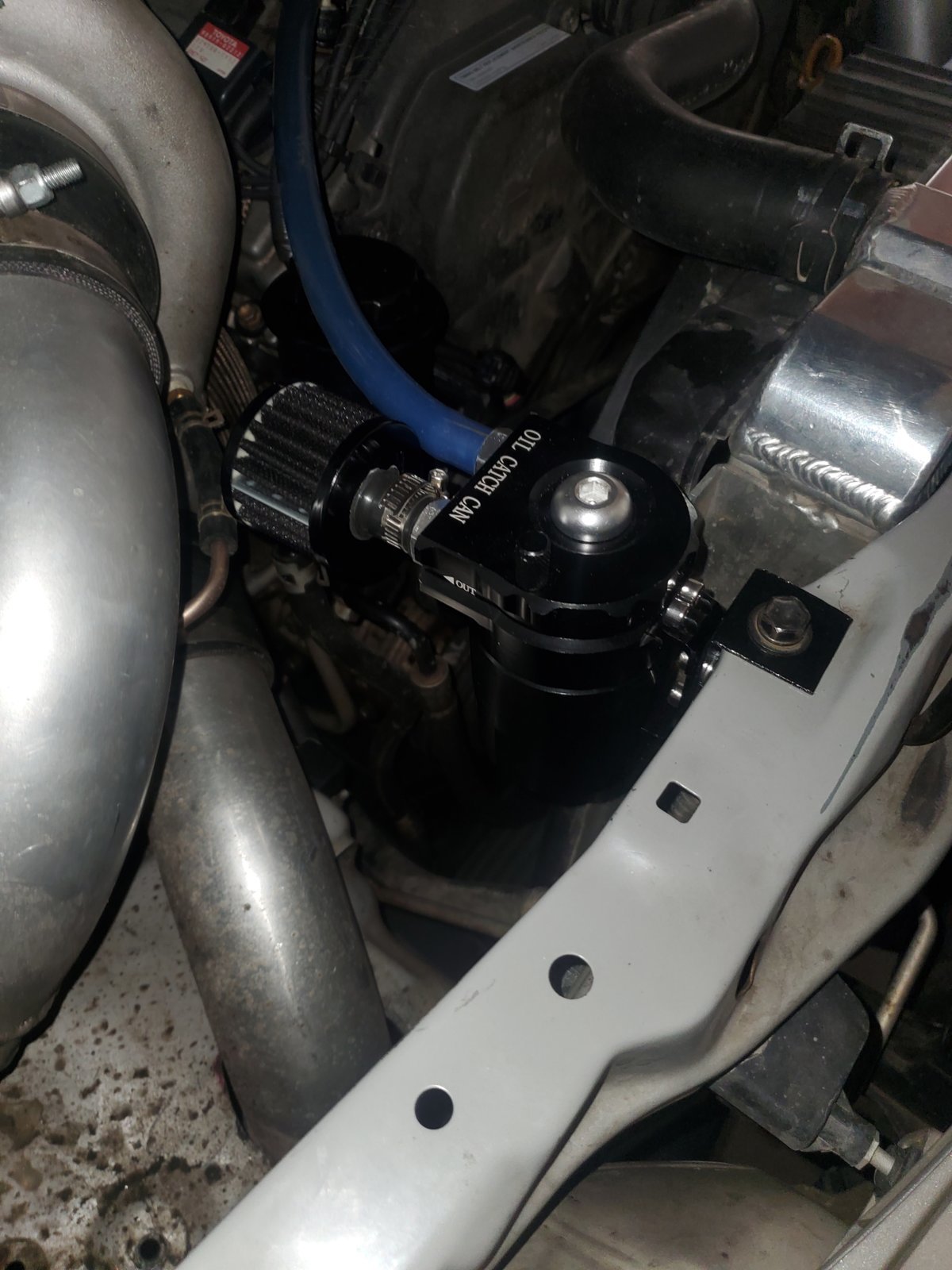

    Couple little odds and ends this weekend.

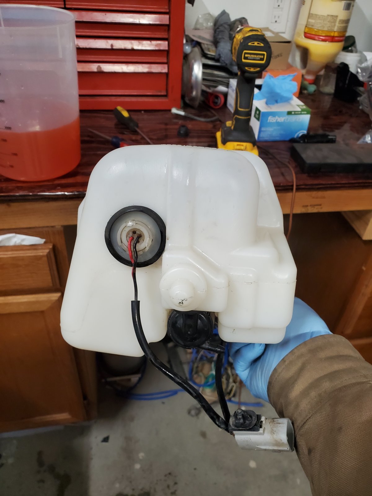

    Added a chineesium oil catch can. A favor from the Amazon.
    The plumbing for the dorkel needs redone. So when that happens I'll add a bunch for vacuum on the can

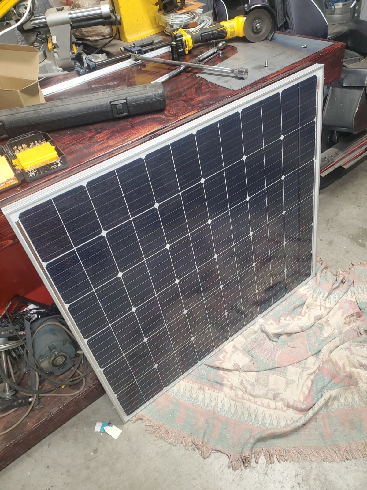

    Cut up some steel to mount my solar panel. I was 1/2" off in my measurements on v1 design. Ended up just flattening them out to make it work. Once I sort the wiring out pictures of it mounted will come.
