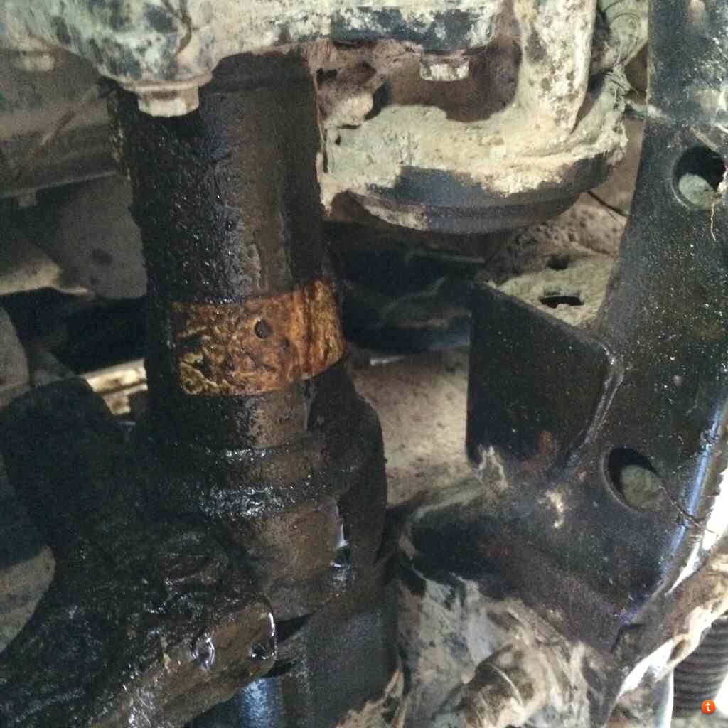

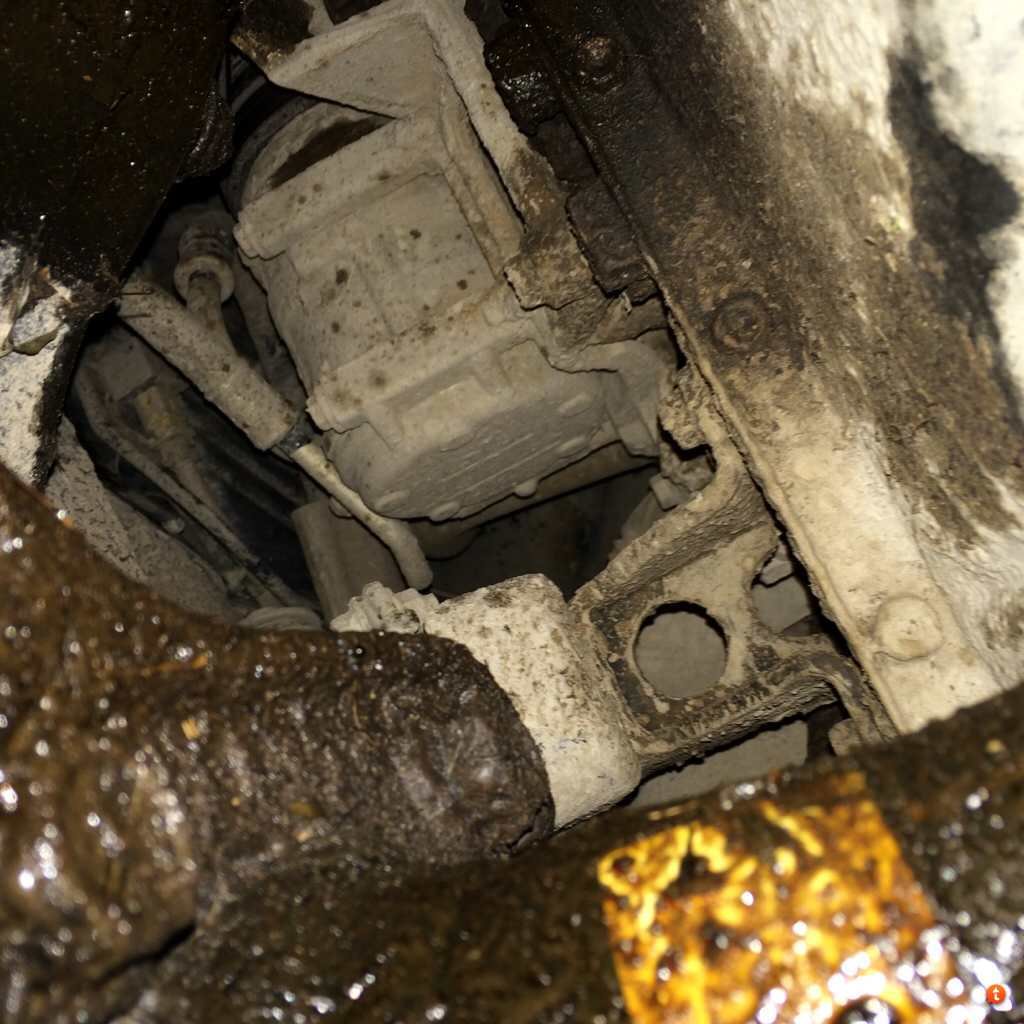

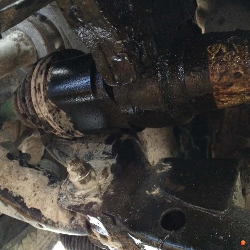

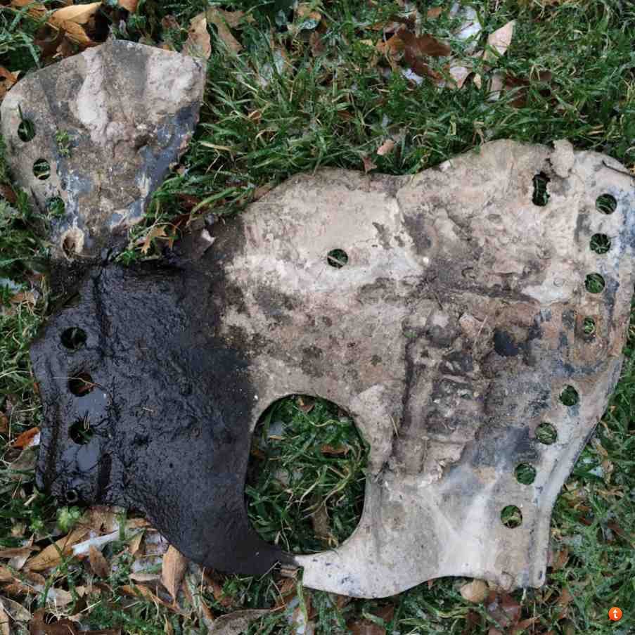

    That's front front diff that is leaking... Eff and how the heck did I do that to my skid plate?

    shit, damage from TORR perhaps?

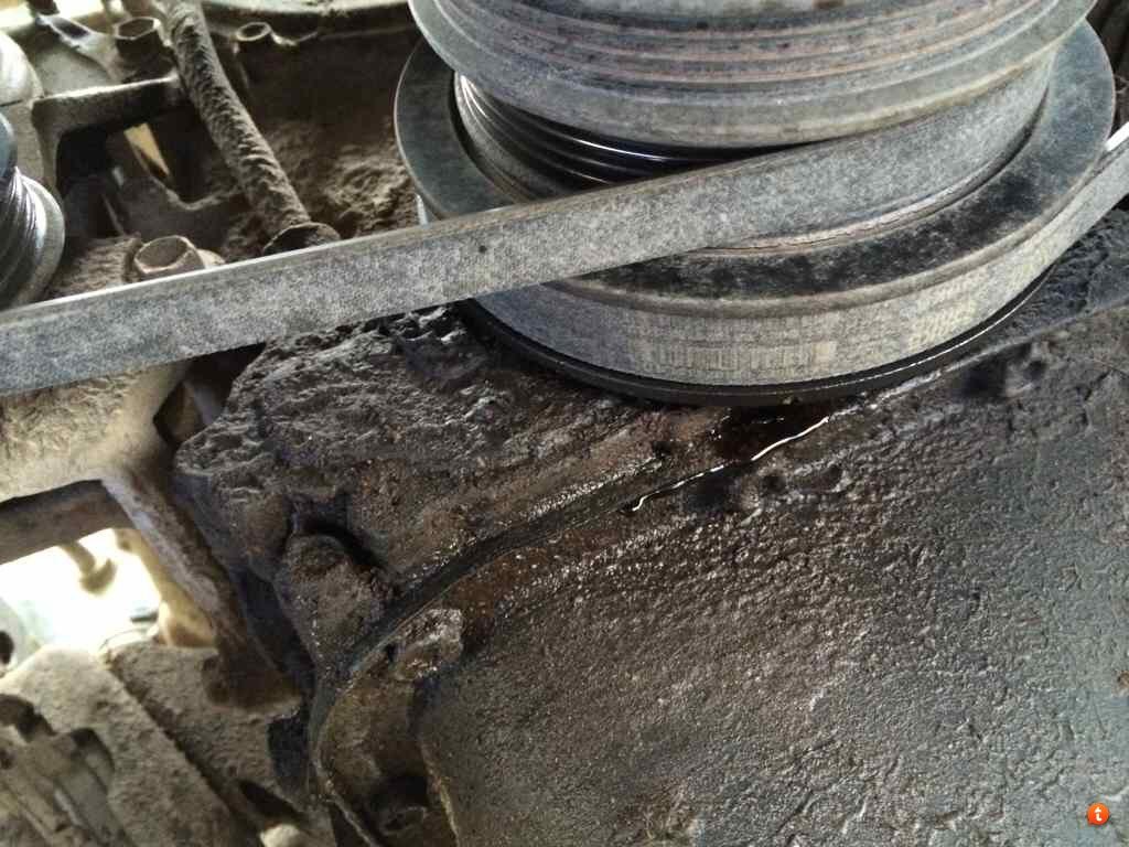

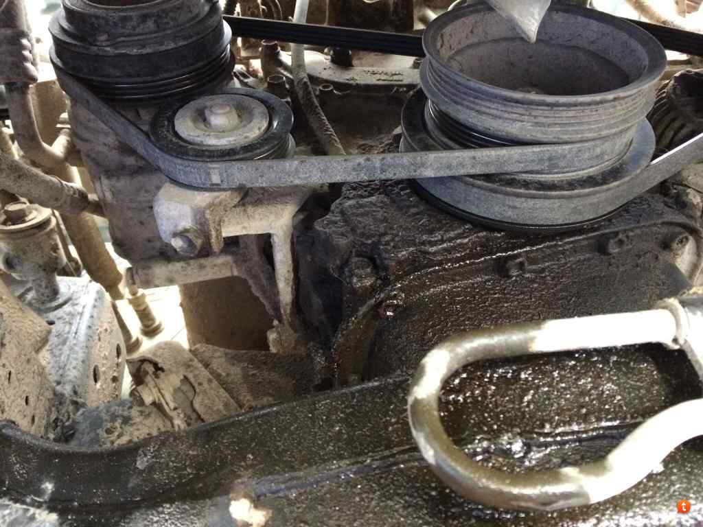

    No clue I checked all fluids when I got home and things were fine, but it's not the diff, I took the other skid plate off and look what I found e2any7ap_737041d75c13bff53011390bed4e42d688a53190.jpg
    That's my engine...

    Oil is really low and I checked it two days ago, I check my driveway everyday that is why I noticed. I wiped the area then started the engine. The oil pours out evedy5ys_b918cd9f64c5dad5d53c70267b8a0df6a1387a5d.jpg

    Oil pours out from behind that pulley

    Probably so, but how to get it to stop leaking? I wonder if my block or oil pan is cracked from the cold?

    The seal behind that pulley could have crack

    That's been leaking for a long time. The cold probably finished cracking the seal and now it's time to replace it.

    Yea front main seal is done, seeing how hard it is to replace

    Don't think it's too hard. Radiator might have to come off to get the pulley off

    Hardest part will be losening the bolt.
    I know on the v6's you have to have the Tool or bump the engine to loosen it up.
