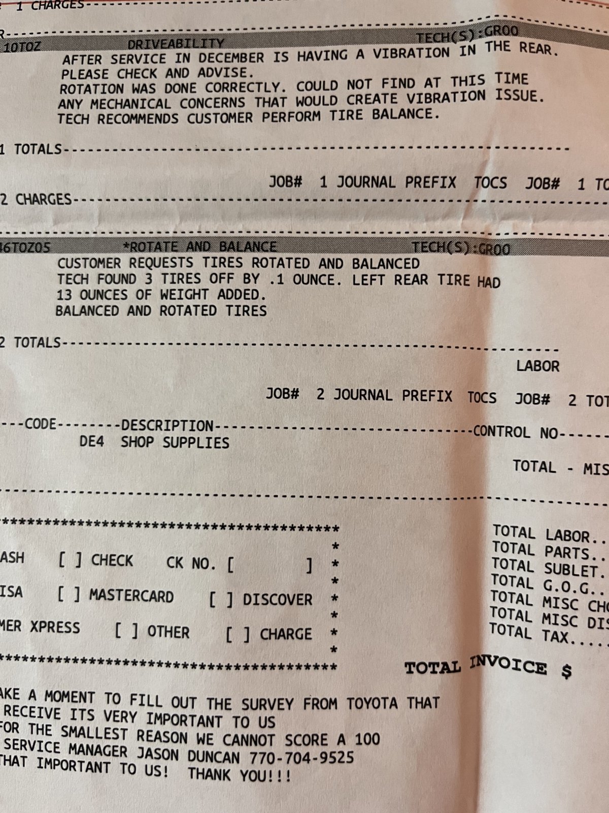

    Attached is the last service record

    So i'm not there so i'm guessing but, based on them adding 13oz to the one wheel I would guess it's an issue with the tires. If they had a road force balancer they'd know for sure but otherwise I would verify yourself that your tire pressures are correct then give it a couple tanks of gas or so and see what it does. These trucks always have a little shake to them I find. Maybe the tire had some abnormal wear (which is typical of a duratrac) thats giving the squirrely feeling. If nothing changes then bring it back of course and see if they have the same truck with the same tires on the lot so you and the tech can do a back to back road test. Subjective issues are kinda hard to diag online. Let us know the outcome

    Sounds like a broken tire band. Replace the tire on the wheel with bad balance.

    Broken belt in the tire that required 13oz

    Of course, it’s a 35-40lb tire. That’s a lot of weight moving around if it’s not concentric or unstable why wouldn’t it. Plus the floating feeling in the rear.
