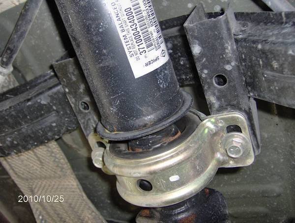

    Check the carrier bearing, that’s about the only “bushing” in the drivelshaft.
    Next check the u-joints.
    This is the carrier bearing. There is a big rubber bushing inside. You’ll see it once you are under there.

    How will I know it's bad? There aren't any visible signs of it being bad. When I move the drive shaft after the carrier bearing, it wiggles a little; before the bearing, it does not.

    You grab the drive shaft in front of the carrier, and push up on it.
    The hard part is explaining what “bad”, as there is some movement in even “good” ones.
    But it should not have a lot of play.
