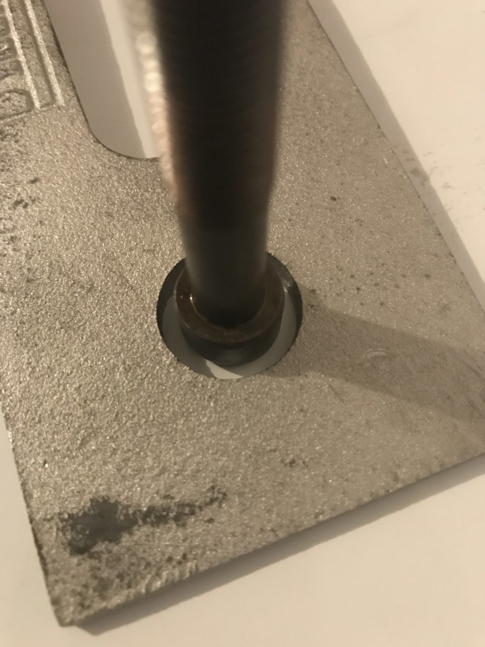

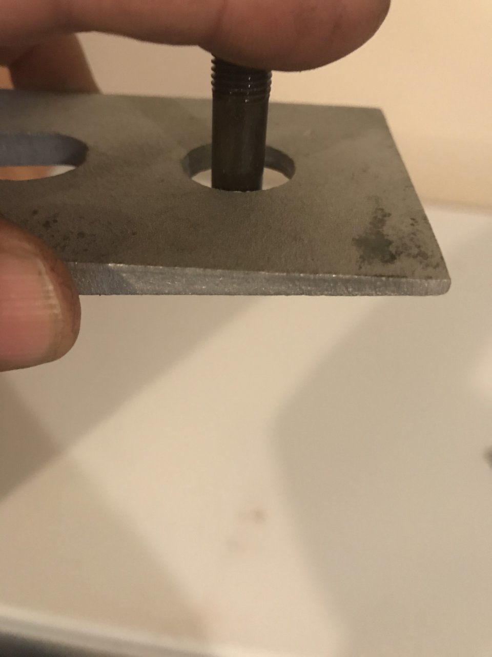

    0D624D47-C07F-460B-93CF-3A48AA5B47BE.jpg E15020F9-38DA-408D-9297-C6F02D6631E8.jpg 6260E2B1-75FC-4E31-AF04-2A4DB573BBDA.jpg Now, I’m no master mechanic but should these center pins have this much slop within the centering hole?

    You don't use that hole. You use the slot. The u bolts will keep the shim centered and kept in place

    Really? What’s the hole for then?

    I couldn't answer that. The shims I bought only had the slot and the others I've seen only have the hole. If you used the hole in that location on your shims they wouldn't be too effective.

    The shims you bought are designed to slip in without taking the spring pack apart.

    I am of the opinion a pint = a pound and a cc = a ml; so if it works for you, good. The shims I purchased are steel and designed to bolt into the leaf pack, a purest solution. I like the idea that my shims are locked in, providing me one less issue to worry about.

    Did you have enough center pin button remaining to lock into the perch?

    Longer pins with a collar is the way to go IMO...you can see the collar on the left spring pack between the pin and the bottom overload. When adding a shim this is the best way to ensure that the pin seats into the top of the axle.

    Good question. No.
    I did add collars to the center pins.
    Exactly like Sna above. :thumbsup:
