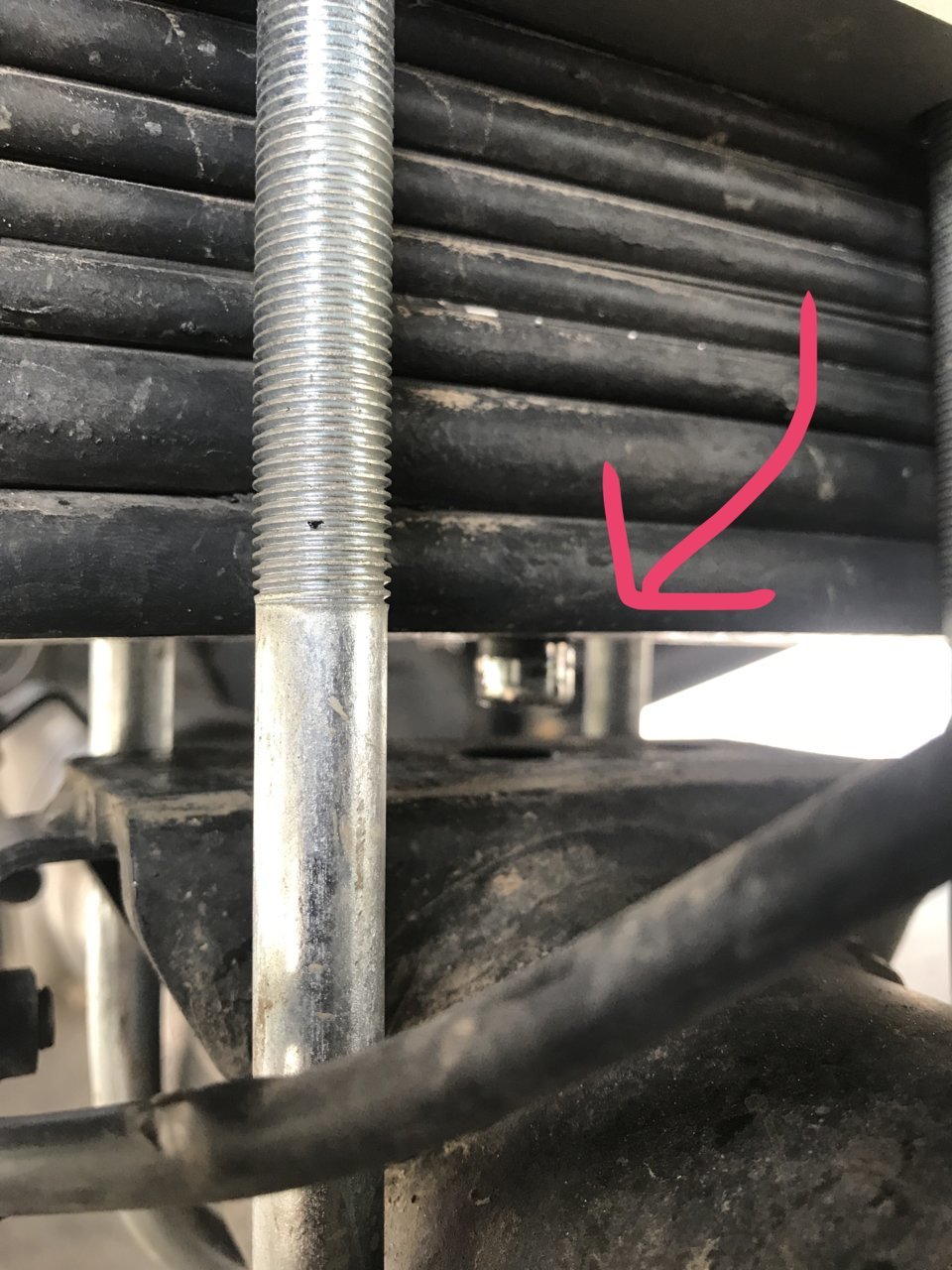

    @sorgon82 So i have the Ubolt flip kit and my ubolts were pretty long (in-case i ever want to add an extra leaf) But I just loosed the Ubolts as much as i could, then put a bottle jack under the leaf and slowly jacked up the leaf, separating it from the axle. Once i had enough room, I slid in the shims and then lowered the leafs back into place. I needed a second set of hands to lower the jack while i guided the leaf pack into the axle hole. Here a pic before the shims went in. Ignore the arrow.

    Yeah! Right on i was hoping i could just do it this way. Thin end toward the front correct?
    I messed up and cut off the extra center pin on my extended one, luckily i put the collar on it but if I ever want to aal Id need another center pin again lol
    Sna and DrFunker like this.
  20. Aug 20, 2018 at 9:50 AM
    #40
    DrFunker
    DrFunker Well-Known Member
    Feb 3, 2014
    #122158
    42,912
    Yes, pointy end forward. :thumbsup:
