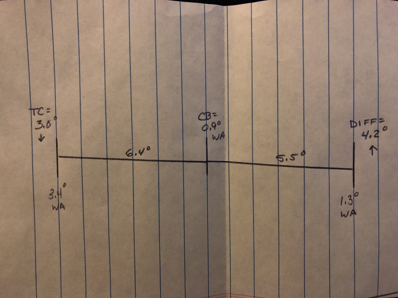

    I have the same vibrations and only have a 1" block in the rear. Problem is my leaf pack is the TSB pack and already has a shim installed. So do I replace the 1" flat block with a 1 degree tapered block from lowrangeoffroad.com or pull the TSB shim and replace it with a 2.5 degree shim? Anyone know the degree shim used in the TSB leaf pack? 2018 TRD OR brand new came with a shim

    You have to measure your angles of the drive shafts, pinion and carrier bearing, they have to be within a certain tolerance, I checked them with my phone but you’ll be much more accurate using a digital protractor

    Did you measure with the iPhone app? The one that's a "leveling tool"?
    lloverso likes this.

    I downloaded the Clinometer app, your not going to get the most accurate measurements with it though because it’s hard to hold the phone steady enough for a perfectly accurate reading but it’ll give you an idea, I’d invest in a digital protractor from harbor freight.

    Yes, see attached photo for angles
    evoxtaco[QUOTED] likes this.

    I attached a photo of my angles

    Looks like that driveline has some crazy vibes like mine, maybe 3* or 4* shims and a FK29 drop will help correct those angles not sure though.
    If I have to I’m going to invest in a one piece drive shaft and call it a day lol these drive shafts are way to finicky
