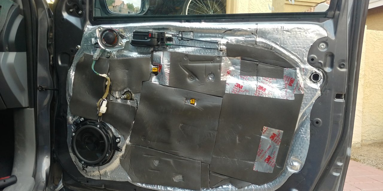

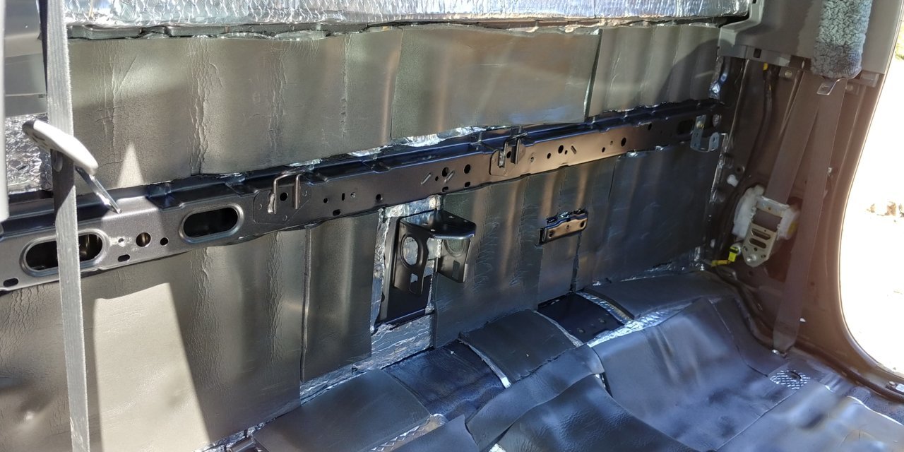

    I feel the doors made the biggest difference, but I did the floor and back of the cab too.

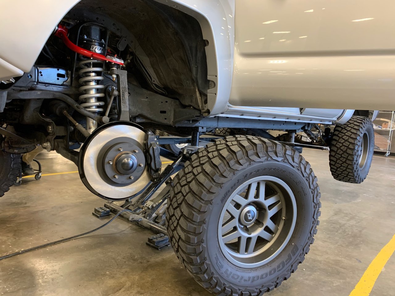

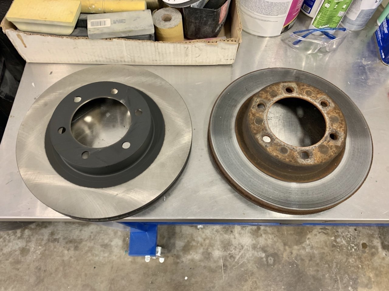

    484
    Adrian
    Charleston SC
    Fox Lifted 2007 Taco With Mods Here & There

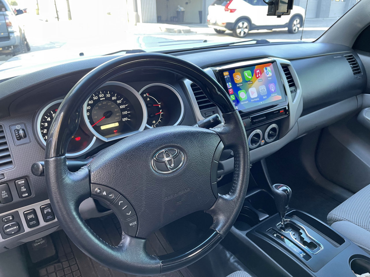

    Too many things to list but top 3 are: White LED gauges, Joying head unit & GX 470 big brake swap.
    White LEDs are cleaner looking & the Joying head unit has a better audio output.
    Running the GX 470 front brakes over a year and still working well.

    If it’s similar to the 4Runner swap, then yes.
    I did the 4Runner swap and it’s been great; pretty much anything to give better brakes is a plus.

    That’s correct, at least 17” wheels required for the GX/4Runner brake swap.

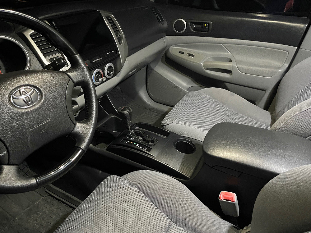

    @takefootoff i love the blacked out center console. How did you do that?? I’m tired on the gray not matching my joying unit

    It's an OEM part from a base model truck, on those trucks the shift bezels always came in black. PN: 58805-AD010
    Here's an example, if you search around you can find it cheaper.
    https://www.ebay.com/itm/165538818808
    As far as my center console assembly I got that out of a 12-15 Tacoma. The center consoles were always black in those years.
