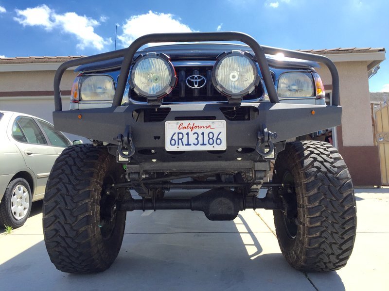

    3rd Gen DC V6
    image.jpg image.jpgWasn't that bad when you do everything correctly
