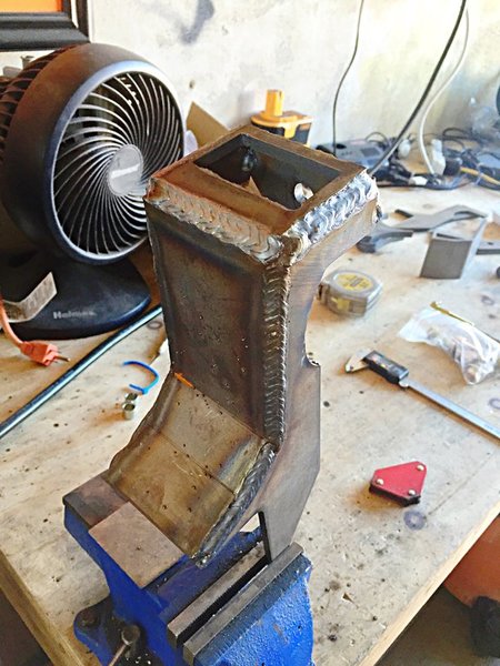

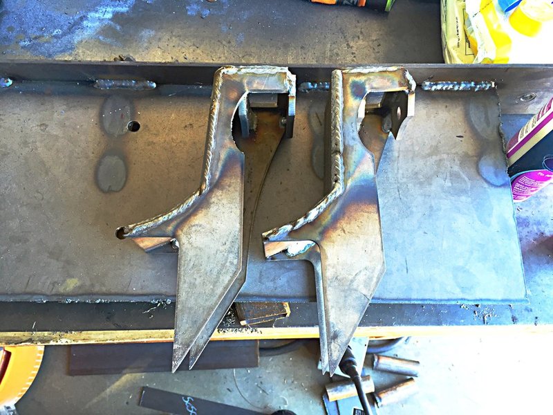

    Does it hurt to weld them on the inside?

    No, I think they should be welded on the inside. The first picture I posted wasn't finished up yet. I welded them on the inside as well for added strength

    Looking good. Do yourself a favor and pull the bed off when you weld those on.

    You'll need someone to help you pull it off. I'd suggest tacking the mounts in place with the bed on, so you know there won't be any interference, and then pulling the bed. If you want to be anal, tack a tube between the mounts once the bed is off to ensure that they don't move on you.
