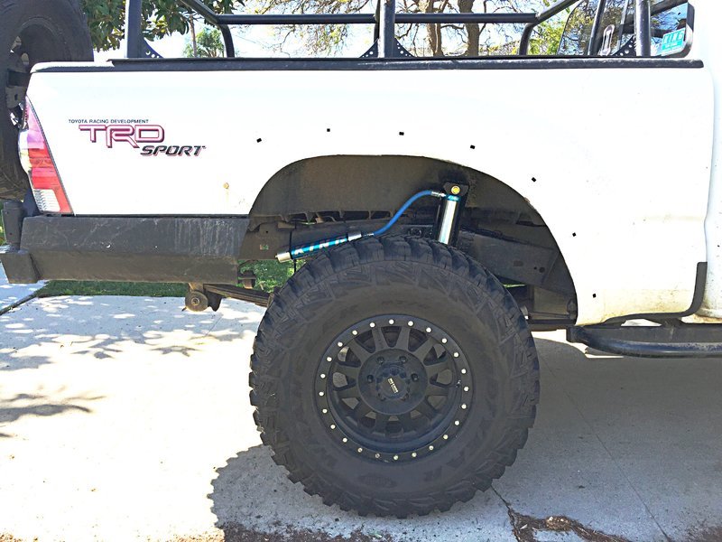

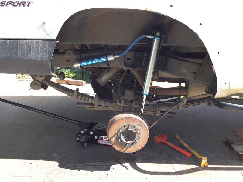

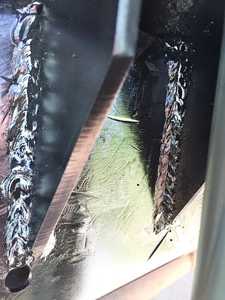

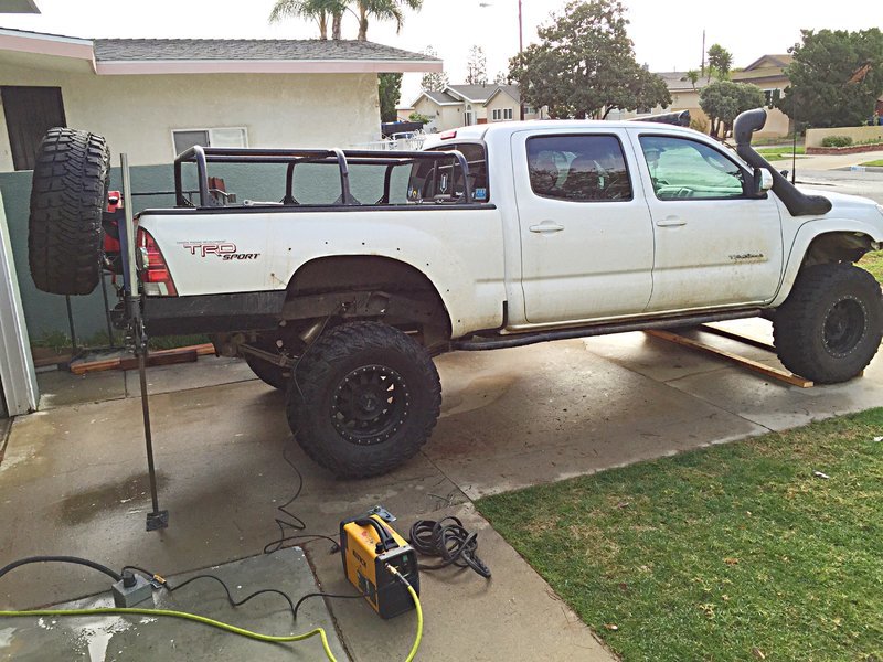

    Well I spent this morning into the afternoon doing half of my BAMF shock relocation. Did the passenger side. Going to do the driver side tomorrow. It was a ridiculous pain in the butt to cut off the stock shock mounts because my plasma cutter stopped working. The diffuser inside melted and I didn't have a spare. So angle grinder it was. Went through about 10 cutoff wheels on just the one side. Basically took some measurements, put the truck on Jack stands and took my rolling Jack underneath both sides of the axle and went up and down and tested where I needed to be for the bottom shock mount. I can grab all my measurements later. Too hot right now. Cleaned up and gonna take a nap now :) Here's some pictures. Hopefully be able to find somewhere nearby to get some flexing pictures!

    Looks like he went the shoe string mod :anonymous:
