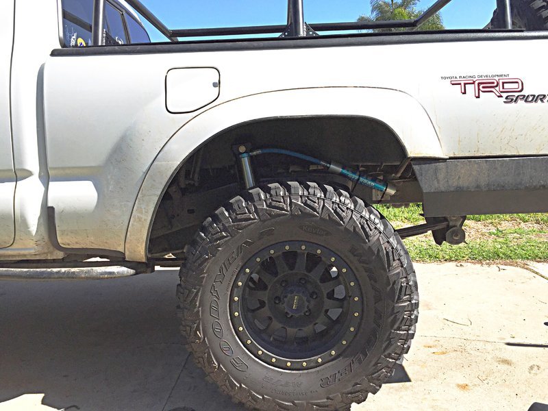

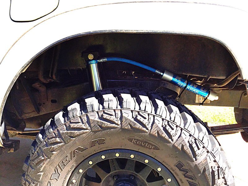

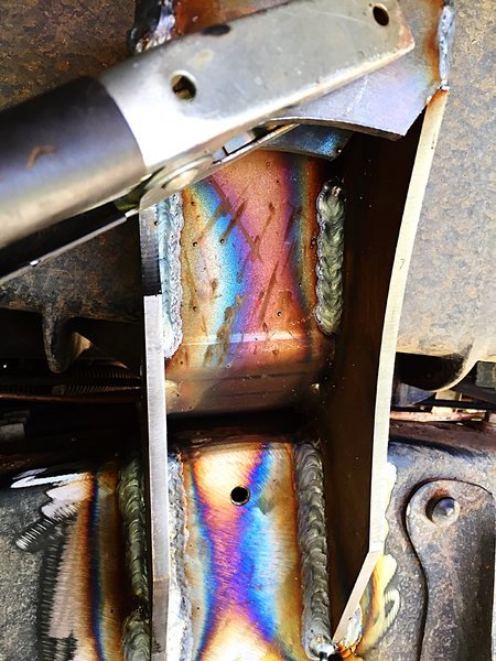

    Well this morning I went out around 9:50 and started on the other side. Just got back inside from cleaning up. That side went so much smoother because I had all the measurements from yesterday on the passenger side. Yay! All done with the rear now besides extended brake lines and resi mounts that I have to make.

    The shock relocation looks great!! Did u cycle thru it to see how much bumpstop you'll need to prevent shock body rubbing?

    I will be making some extra supports that tie into the frame cuz though 6 bolts are definitely not good enough to winch from!
    I kinda measured as I went and didn't write anything down. Hard when you're wife is pressing you on time, and you're doing everything by yourself with a sore tailbone. I'll try to get some measurements of the placement of the upper and lower shock mounts.
    I put the truck up on tall Jack stands and flexed out the rear with tacked on shock mounts and tested everything out. My shocks will have a small amount left before bottoming out when the bump stop is all the way compressed. And when I put my LT kit on up front I'll probably be putting my 1" Bora spacers from the front onto the back wheels. So I don't think I'll have to worry about shock rub too much. Hopefully hahaha

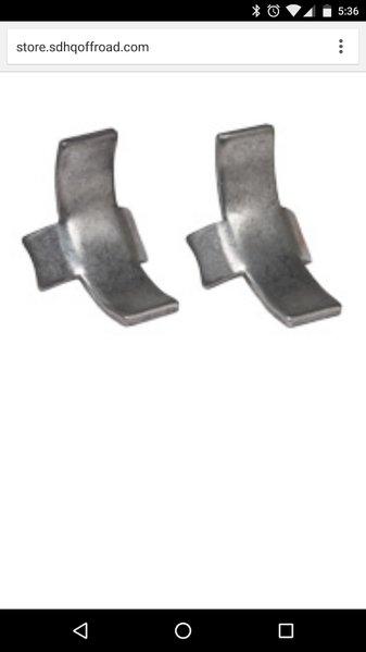

    Mhm, All Pro makes them if you don't want to dish out the money for LT coilovers just yet. I guess it works but I wouldn't want to play games with that
    I figured he would at least want the axles haha

    I had to order a set for my shocks, it ran about $330 from king. Had to do it because it wasn't a "kit" shock that a company has worked out with king so they were custom built.

    Ohh, so basically a big spacer?
    Thats weird.. Dakota doesn't have them with his Kings and LT :notsure:

    He would have to, to mount to the coil bucket. From what i was told TC has worked out a kit shock for their LT kits so they already come with the top plate on the shock.

    Oh okay. I was wondering how they worked without a noticeable adapter.

    He's thinking of a eye to plate adaptor, that Cl posting was a spacer to make your coilover longer for a LT kit like a big spacer

    Yeah, that spacer is made by All Pro, it just goes on your extended travel coilovers to make it "long travel" without buying the actual long travel length coilovers.

    Yeah not sure what scenario would make that right, because all you have is an expensive wheel spacer at that point since your travel is still whatever your extended is
