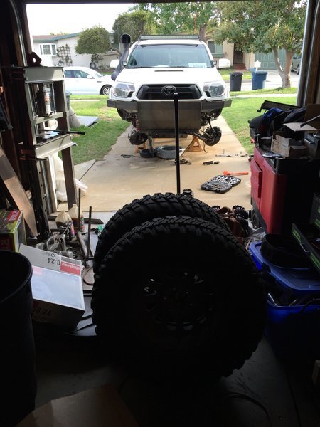

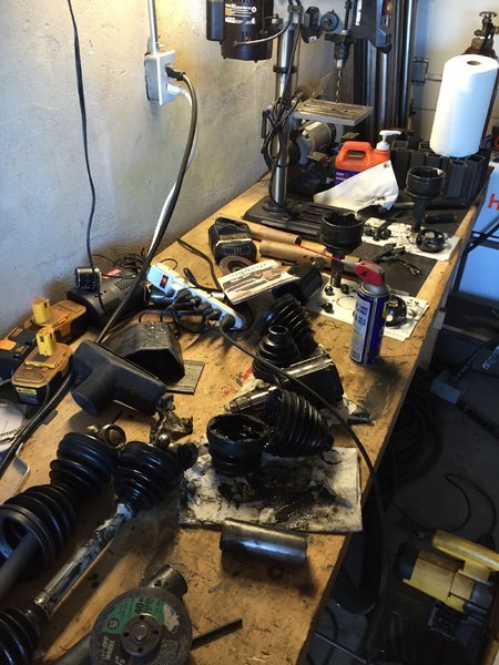

    Well the shop that I brought the cut off axles to didnt get a chance to do it tonight, I'll be picking them up tomorrow. Got the upper, lowers, toe rod extensions, and Coilovers in. Just need to pick those back up tomorrow to finish building the new axles. Man 35's and long travel are a pain to make fit and get rolling but I know they'll be worth it haha.
    This is my work bench right now :cool:
