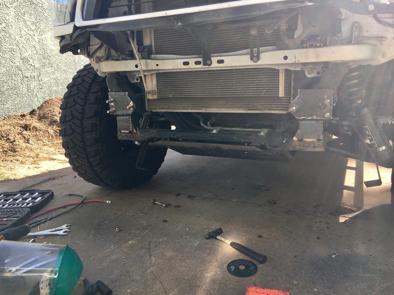

    Haven’t added anything to this thread in a while. Yesterday I spent the day changing out a torn boot on my driver side CV axle. That wasn’t very fun. Messy. Axles suck. Happy that it’s fixed now though.
    Today I decided I desperately needed to repaint my front bumper cuz it just looked really worn and ugly. I took off the bumper and noticed that the frame horns were cracked pretty badly in 3 different spots on each one. So I got to work and took some 3/16” plate that I had lying around and made some new reinforced frame horns. Also grinded off the stock bolts and welded in some much beefier 1/2” grade 8 bolts. Feels soooo much more solid and I don’t have to worry about those cracks failing if I’m winching my truck or something now haha. I repainted the bumper with rustoleum truck bed liner and it looks freaking great! I love the way that stuff looks! By the time I put the bumper back on it was almost dark so I didn’t take a picture.

    I like the beefy ones that SOS concepts sells. They’re only like $50. Yeah dude they’re super thin! Glad I noticed the cracks before going out wheeling again. Anymore beating on the truck would have potentially cracked them really badly

    Yup seen a good many of Tacoma’s have them cracks. This was gonna be the next thing I did to my Tacoma.

    Yeah dude. It’s only 1/8” there. Super thin. How’s the Jeep coming along??
