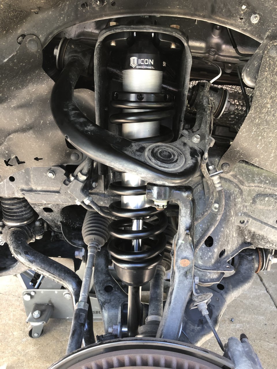

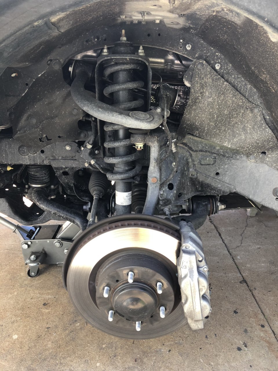

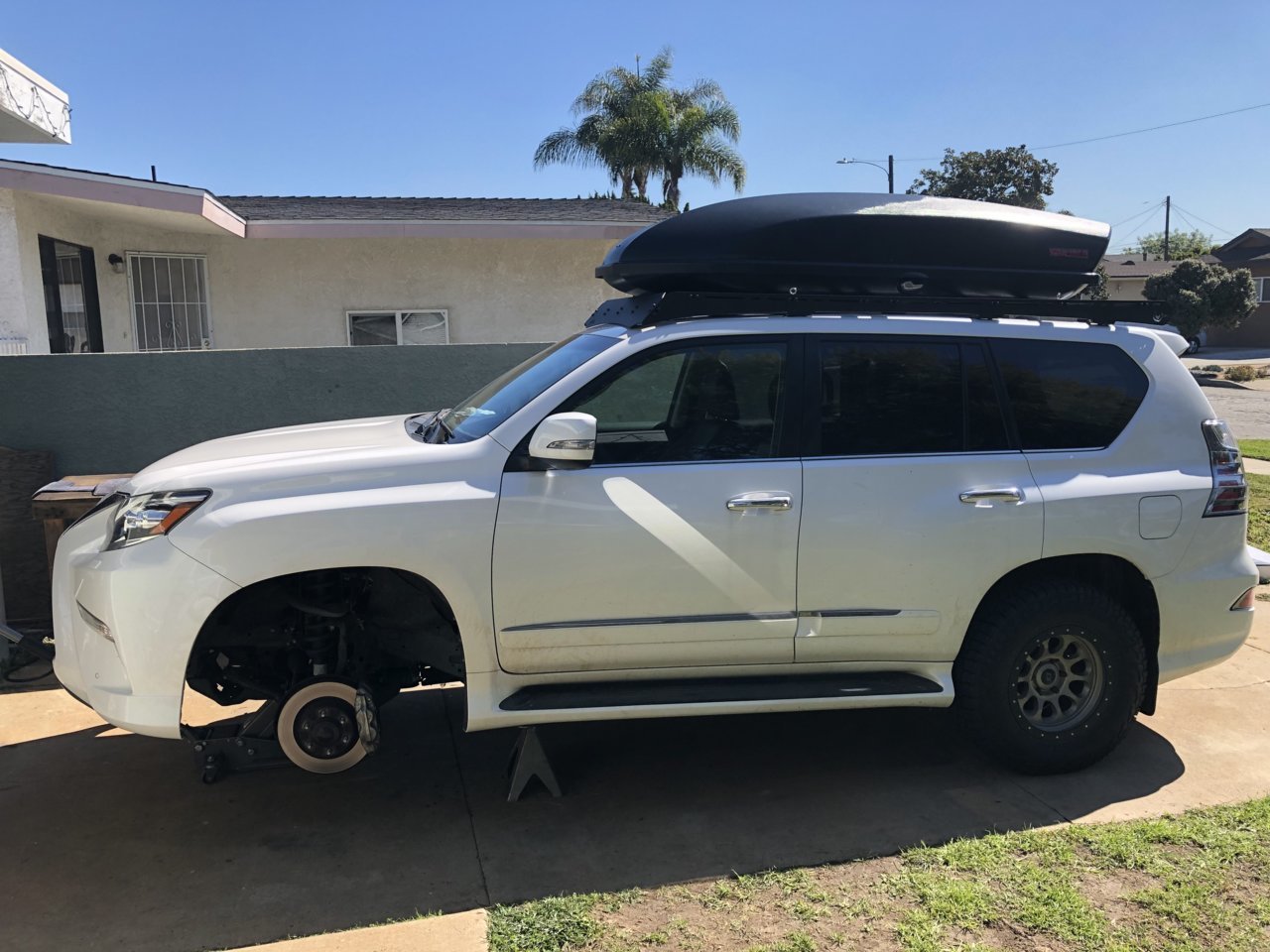

    Had a little time this last week to work a little bit on the GX. Had only enough time to get the ICON coilovers in. I’ll do UCA’s, rear shocks, and springs hopefully within the next week or 2.
    Out with the old and in with the new.
    Night and day difference between the stock shocks and ICONs. The stockers were super soft which was great for street driving but almost too squishy. I took it for a spin once I put the coil overs in and it handled so well. Soaked up everything in the rode so much more comfortably but wasn’t too squishy

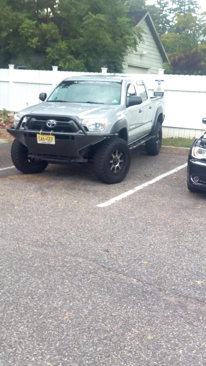

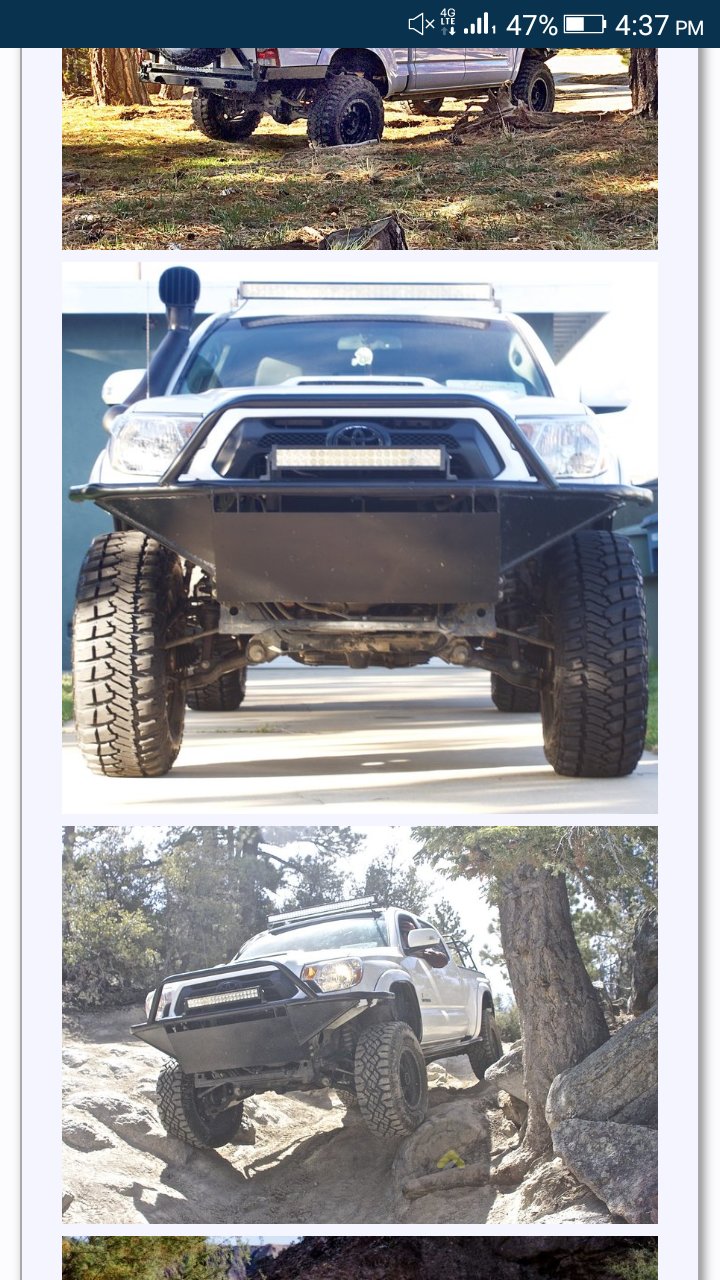

    Idk this bumpa looks real familiar

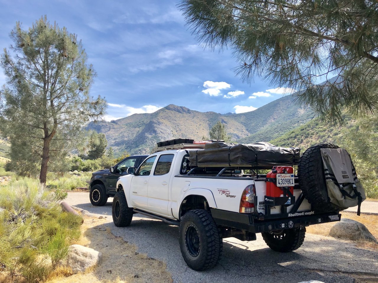

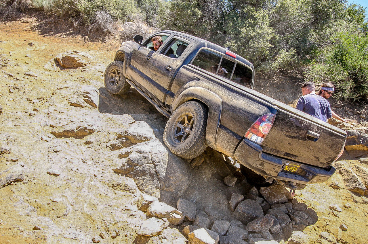

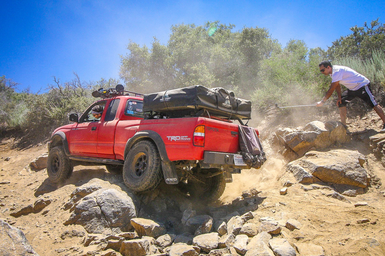

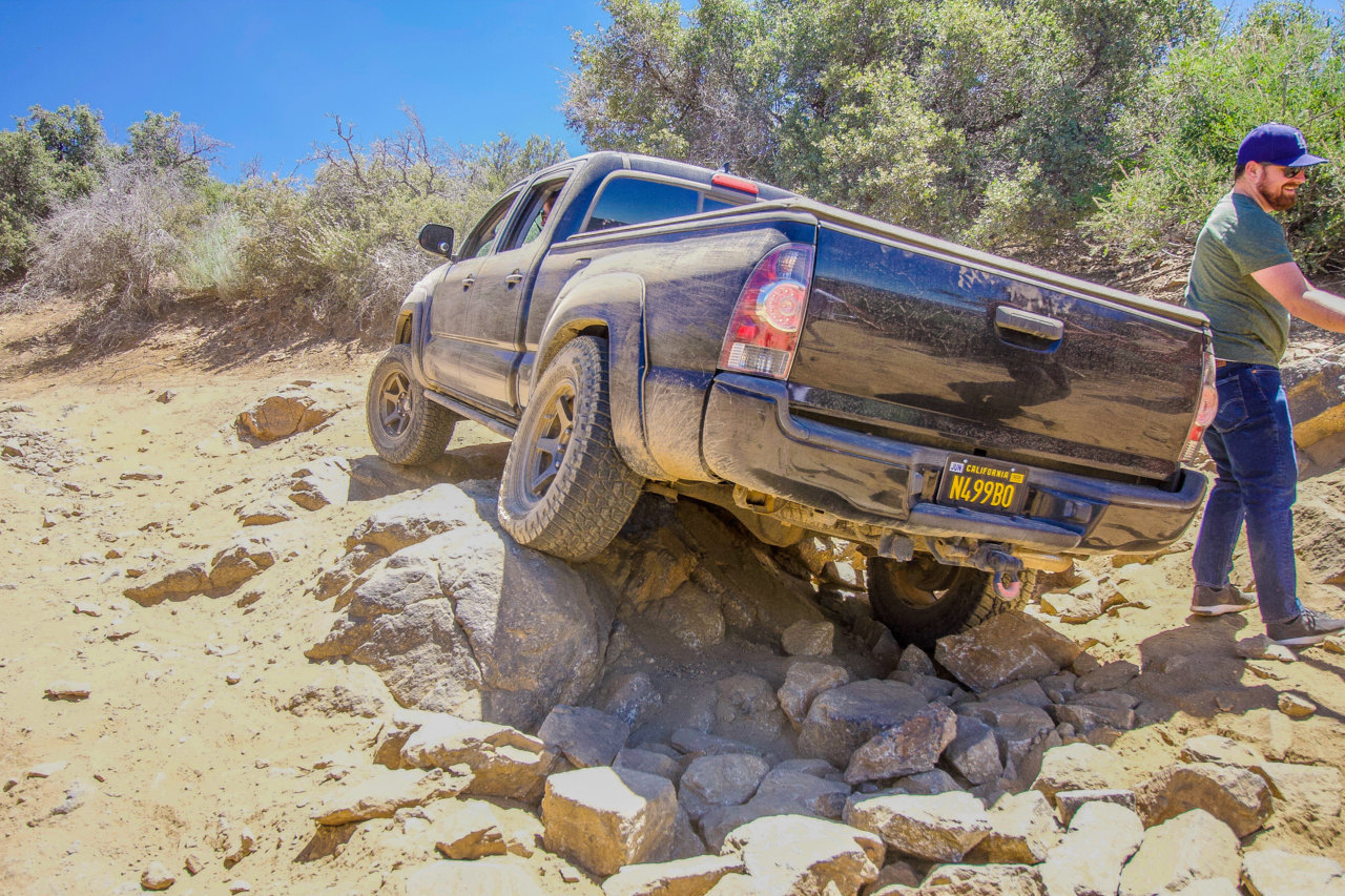

    Dang I’m never in my build thread anymore.

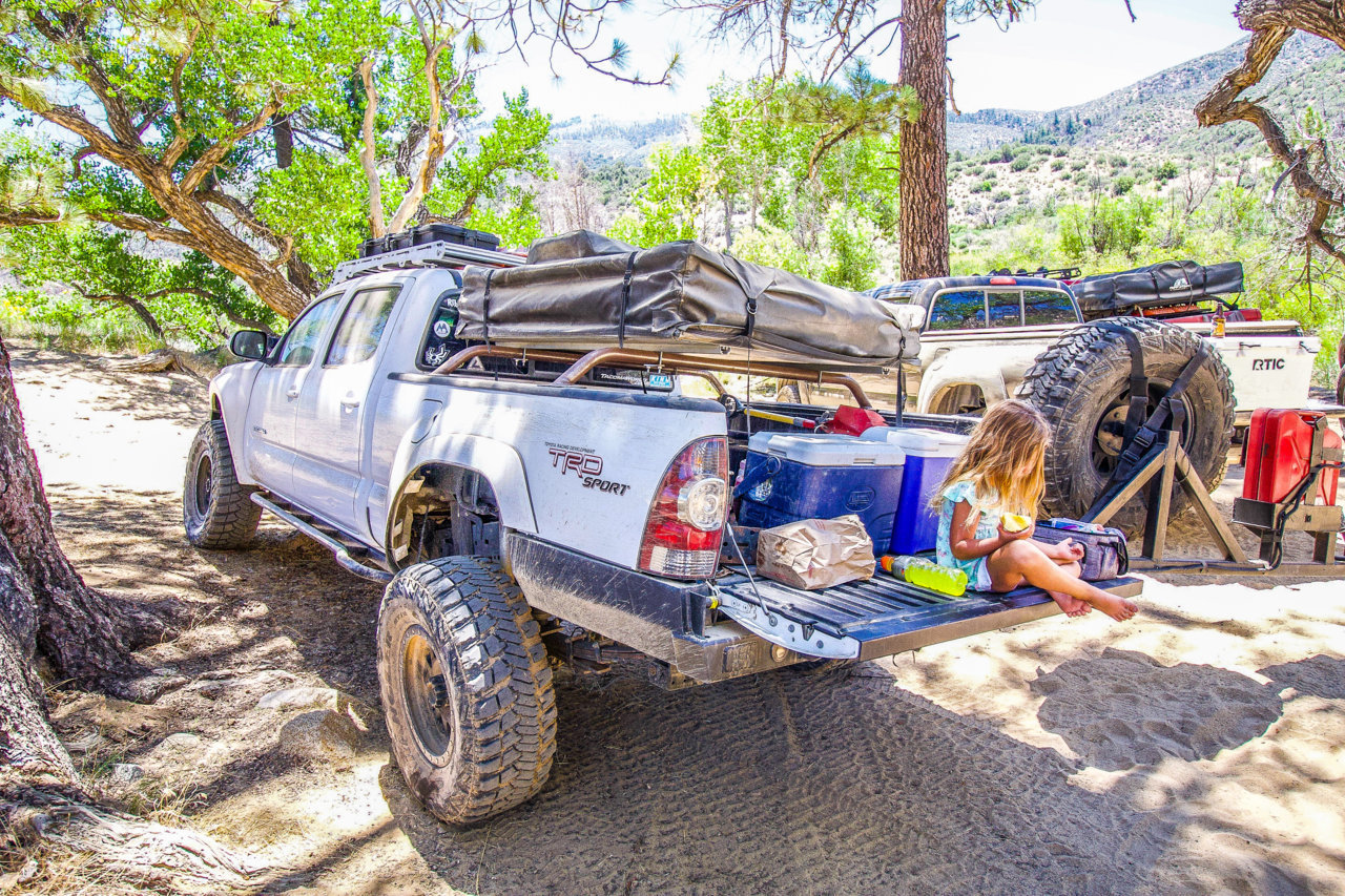

    Went camping with my daughter in the beginning of June which was a ton of fun. Caught her first fish.

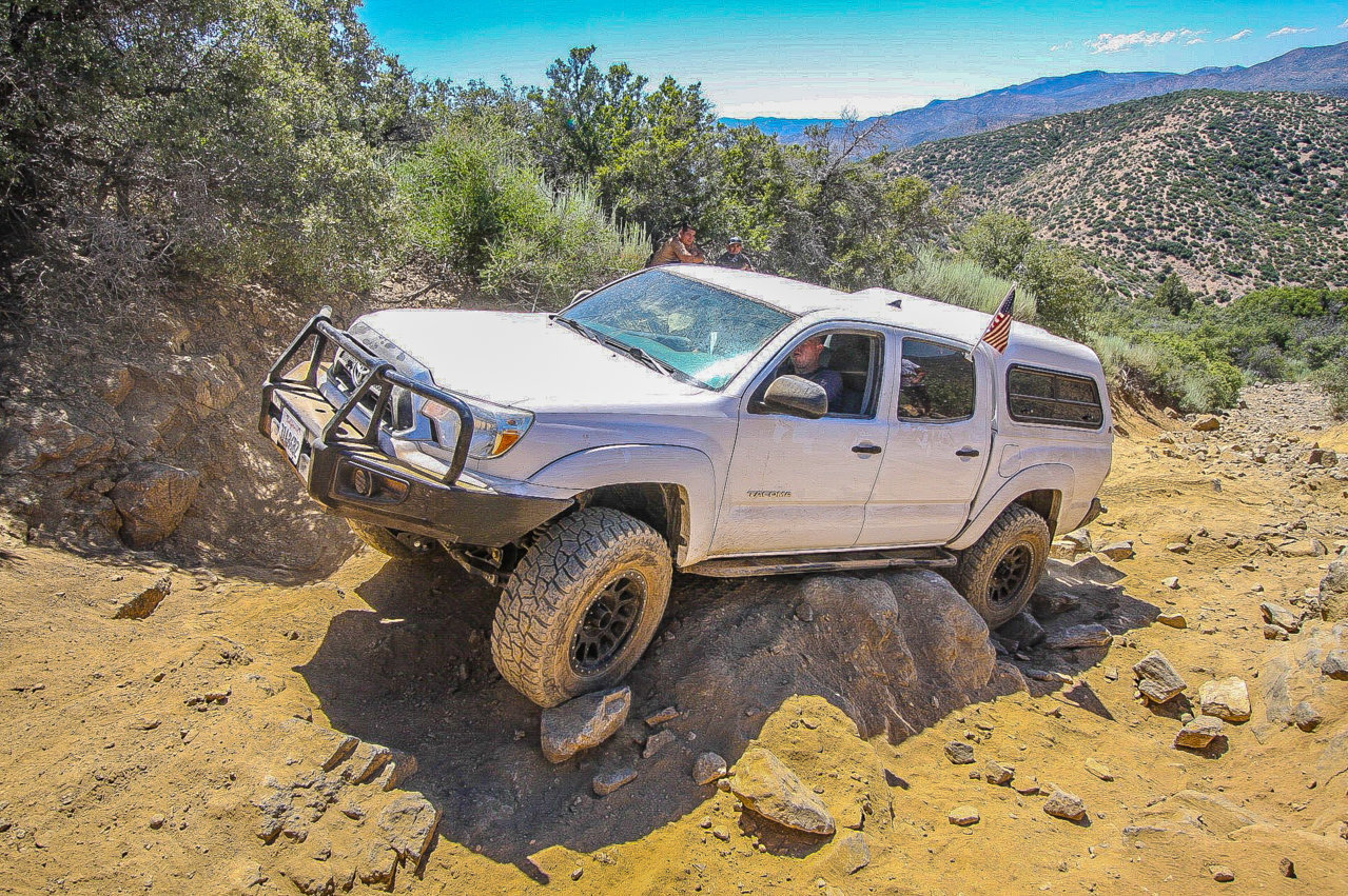

    Also went Wheeling at Miller Jeep Trail last weekend. Went with a few awesome dudes on here and it was a blast!!

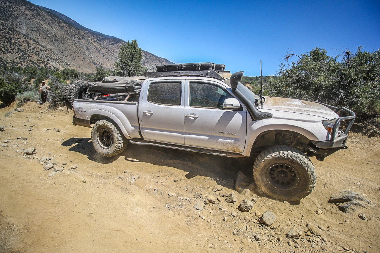

    Ryan, what size fenders are you running? I like how you fit your Airflow into your fender. What is the snorkel secured to? I was under the impression that you secure it to the fender itself.

    Hey what’s up bro. Thanks. I thought it turned out pretty cool. They’re the McNeil 4” fenders. I basically drilled a couple holes in the inside sheet metal of the engine bay and secured a large hose clamp around the base of the snorkel where it would bolt to the factory fender which allowed it to stay nice and snug inside that area. Then I took the fiberglass fender on and off multiple times and cut a little here a little there until I was happy with the fit of the fender over the snorkel. Since the fiberglass is nice and snug to the snorkel base it helps to secure it even more in that area
