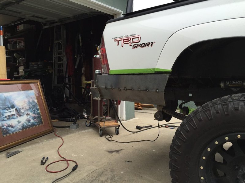

    Lomita CA
    2013 White DCLB TRD sport
    Bunch of stuff

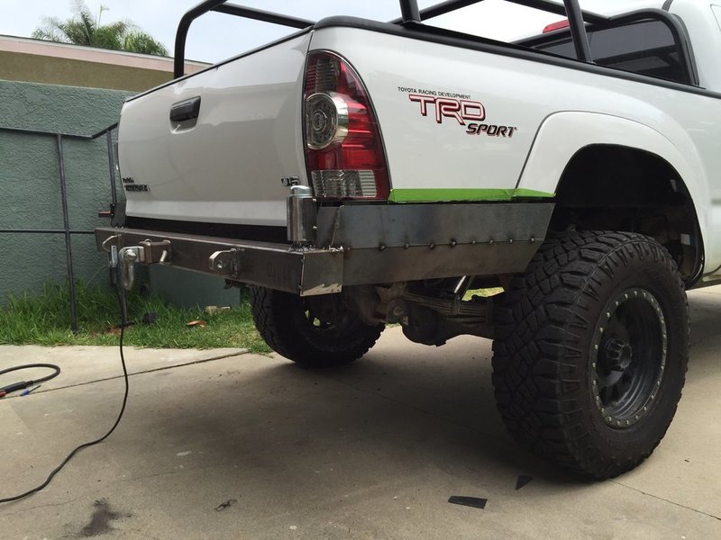

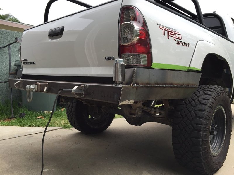

    Just a little progress report for today. Got the spindle welded in! Got the side plates tacked on and into position. Very rough right now but once I get everything fully welded and grinded down it should start looking a little prettier (hopefully!)

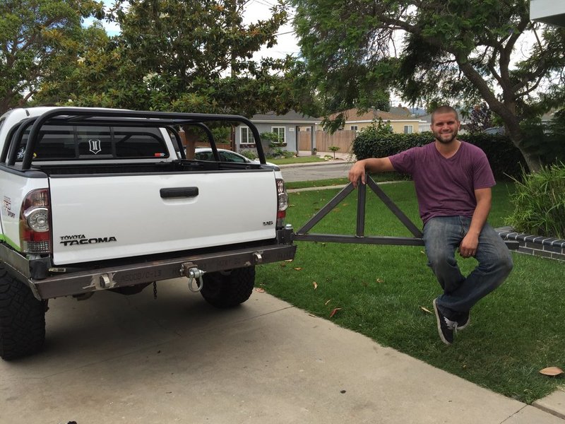

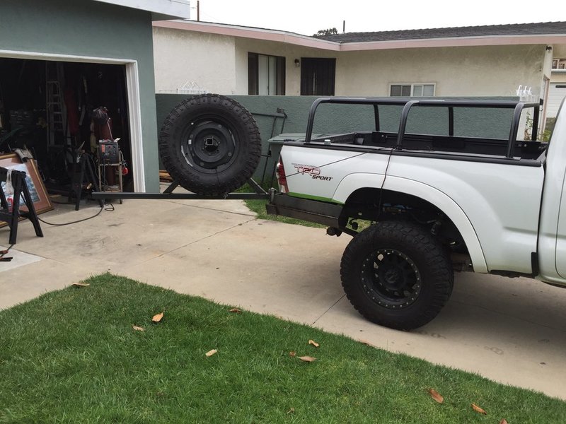

    Lomita CA
    Bunch of stuff

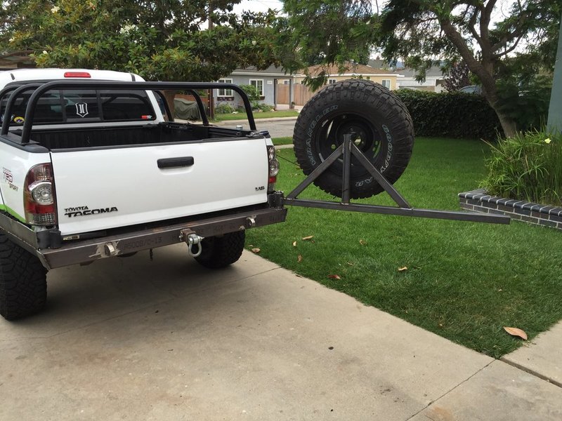

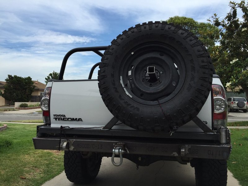

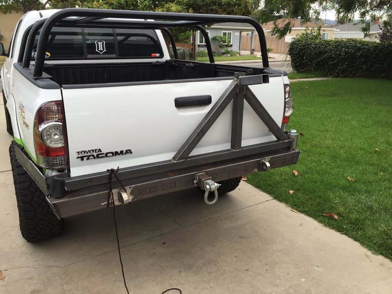

    Thanks bro!! I made some more progress on the bumper after lunch today. Built the whole swing out.

    That looks great man

    Haha naw you're good. I'm the stupid one. It was kinda obvious since that's been the topic for the last little while in my build haha. Just had to make sure. Well basically the list is:
    • Finish welding everything
    •Add mount for tire carrier so it can bolt on
    •Relocate rear view mirror tailgate back up camera to somewhere that I can see behind me
    •Add a latch to lock the swing out.
    •reinforce the side panels with a crossmember that ties into the frame plates
    •Add gussets in places where I want to beef things up
    •Build Jerry can mount
    •Build drop down table from the back of tire carrier to hold camp stove when cooking
    • Grind everything down pretty
    •PAINT!!!
    Still a pretty big to do list haha. If you or anyone else has any ideas of things to add for coolness factor or for making it better lemme know!!
