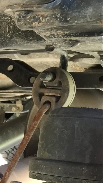

    I am not around my truck atm I can get some tomorrow for you I'm just holding it on with tie wire where it broke the mount also ripped a hole in the muffler like wtf

    Oh that's not good. Hole in your muffler isn't great. Not the end of the world but you'll probably wanna get that fixed or replaced pretty soon. So it's just your hangars that broke off the frame or something?

    Yea that's exactly what happened the hole is an easy fix just don't know how to fix the hanging muffler idk what to hang it with lol

    haha only thing I can think of is that the hangars need to be welded back on properly. Sounds like your brother may not have got proper penetration in the metal. If you weld those on well they shouldn't break off

    The whole thing broke off the frame at first and later the hanger broke off so I'm trying to come up with another way because exhaust are supposed to have movement but not too much and I don't think the way he welded it it had enough movement causing it to break so I'm trying to brain storm alternative hanging solutions

    Well the little rubber grommet things that connect the hangar from the exhaust to the hangar from the frame is what give it movement. Do you not have those?

    Took them all off when we hacked my exhaust and dumped it right underneath the back seat so it was a metal hangar from stock exhaust to frame and it was too ridgid

    You should try to find a way to get those little rubber things to give it the play it needs.

    I still have them somewhere but need to figure out a way to mount them on the exhaust and mount the exhaust to the frame

    Can't you just weld a hangar to the frame and then a hangar to the exhaust and connect the two with the rubber piece?

    I didn't think of that it's so simple it just might work I'm just like :annoyed:

    Do it! It'll totally work cuz that's how it comes stock on the truck

    Yea I know I think we were just going to weld it to the frame which we realized that doesn't work so I will give that a shot thanks man lol
