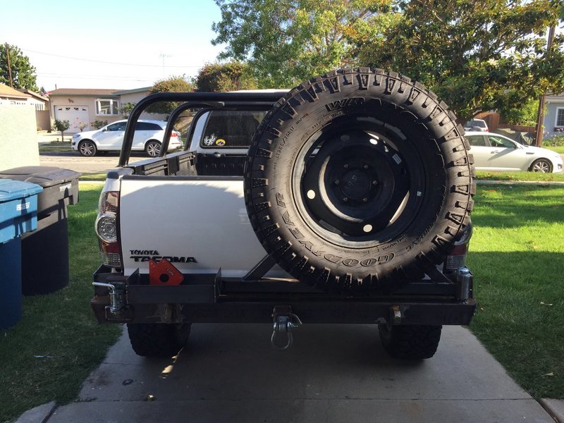

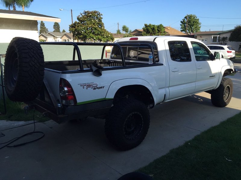

    Took a 8" round 3/8" thick plate and drilled holes to match the lug pattern for the spare and welded it on to the frame of the swing out. Worked like a charm and now I can ride with the spare on. Also welded in some 2x2 square supports between the plated sides and the frame plate. Now it's not flimsy anymore.
