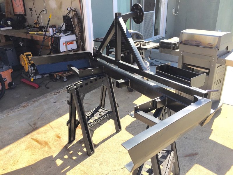

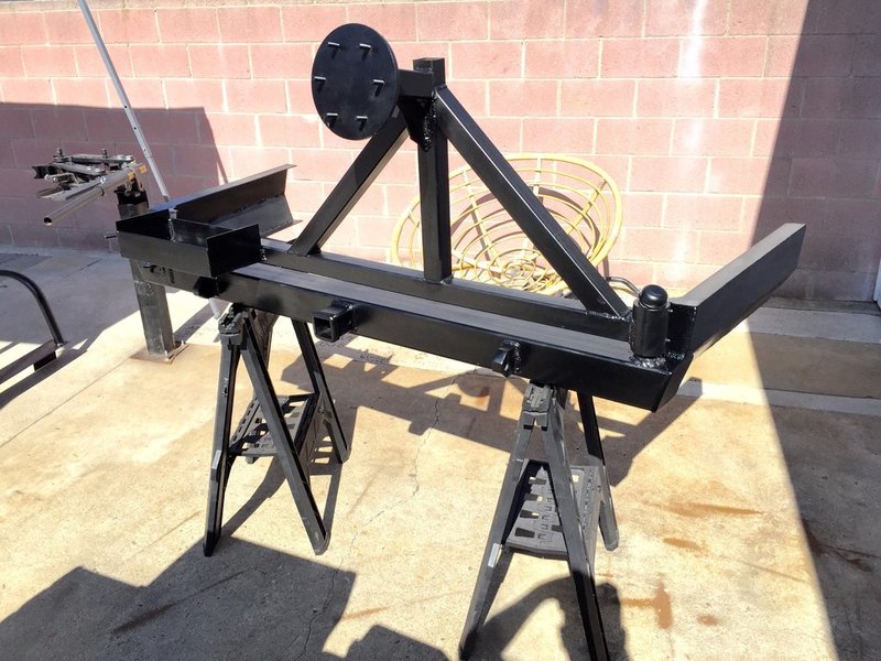

    Okay finally was able to get 98 percent finished with this thing. Couple minor things need to be added but I'm pretty much done. I had the day off today and I grinded it smooth, gusseted the tire swing out arm where the tire mounts to, and painted the whole thing. Probably will add a few more coats of paint as well. Here's a few pictures, I will get pictures of it on my truck very soon. Truck is at the dealer today getting 30k maintanence done.

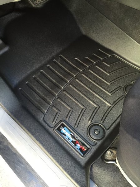

    Also picked up a set of front and rear weathertechs from the dealership. Not bad $200 for both front and rear.
