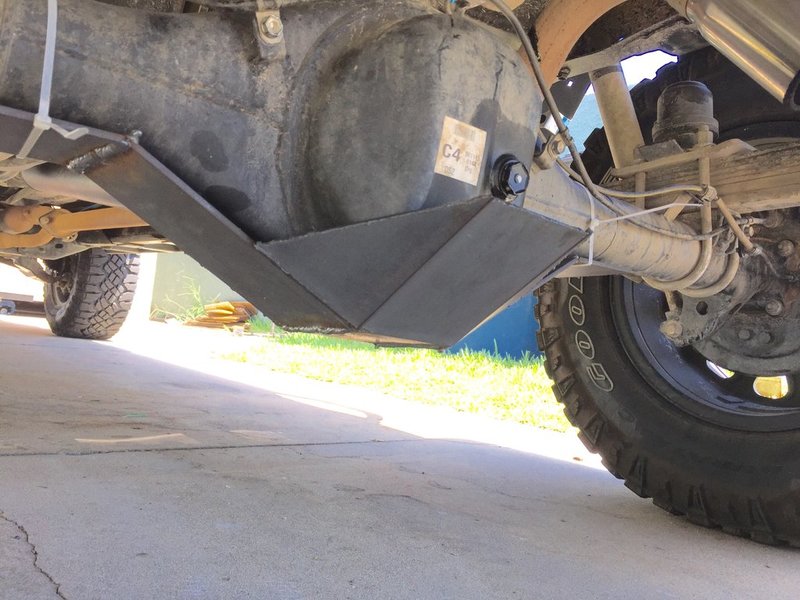

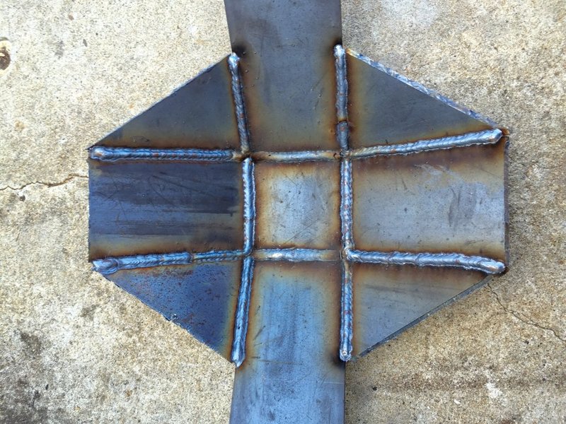

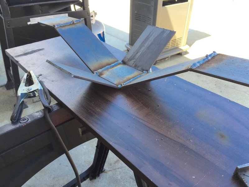

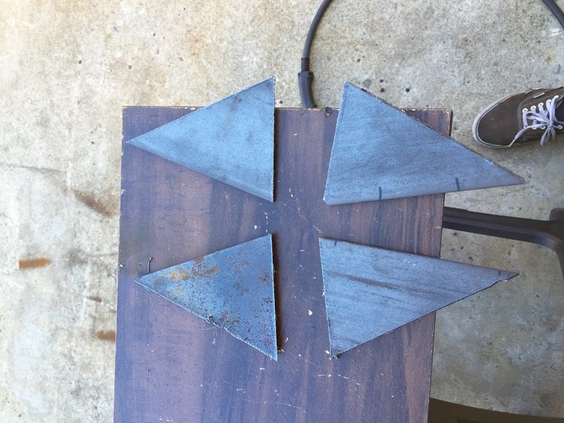

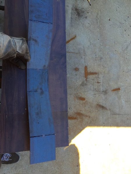

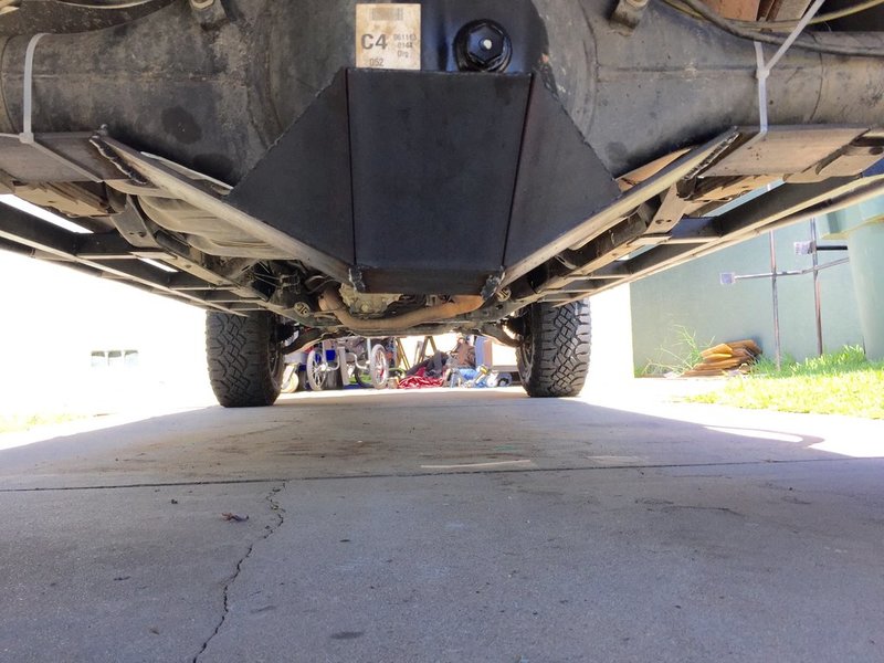

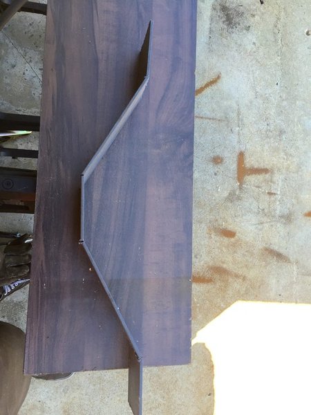

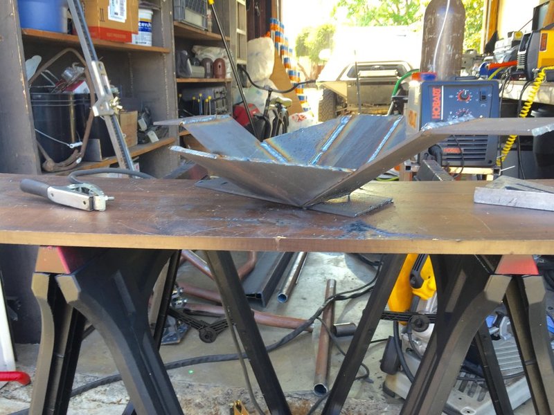

    Went out to the garage this morning and decided that I would start messing with some things. Decided to try to tackle a rear diff skid. Went and took a couple measurements in the rear and then hopped on the plasma cutter and started cutting pieces. Cut a piece wide piece about 28" long and scored the spots where they would angle up and parallel with the axle. Then re welded everything together. Then I added 6 inch long piece that would run from front to rear and welded those on. Test fit that underneath the truck and it fit pretty well. Then got back on the plasma cutter and cut triangular pieces to fill in the sides of the skid. Welded in the triangular pieces and then put it up under the truck with some zip ties to see how it looked. I think it's coming along okay. Don't mind some of the ugly welds today haha. Didn't clean the edges cuz I was lazy so a couple welds came out porous.

    #867
    stumbles
    stumbles 1 eye
    Aug 18, 2014
    #136442
    4,391
    bryan
    mesa
    2002 White Double Cab
    Very cool. :thumbsup:
