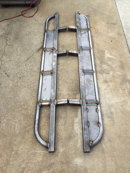

    Think the filler plates turned out pretty good

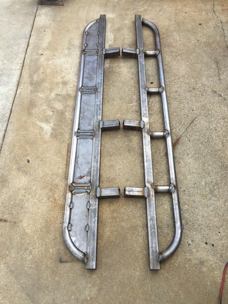

    Thanks buddy I appreciate it. Today's progress report: Legs cut and welded on and 8 of 10 filler plates cut and welded in. Frame brackets, gussets, and end caps left to cut out and weld in

    How'd u cut the filler plates? And what thickness r they, and what welder do u have?

    I used my plasma cutter to cut the filler plates. They're 1/8" thick. I have a Hobart 210 MVP. Nothing too special but it works great for me!!
