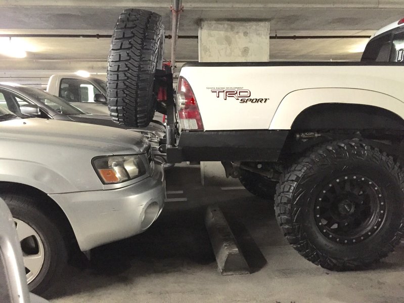

    Awesome! I too went through ECGS and I agree, they're friggin awesome. Very polite, knowledgeable, and easy to deal with. I went with 3rd and clamshell too. You plan on installing yourself? Or bringing to shop. I installed myself, saved myself about $1000 that way. Wasn't too hard either. Took about 8hrs with a few breaks in between. Haha I'm having a really hard time staying away from LT :spy:. If I ever do it'll be a while

    I got a reall good laugh from that pic Ryan. :thumbsup: Haha

    Haha it gave me a good laugh when I came out and saw that.
