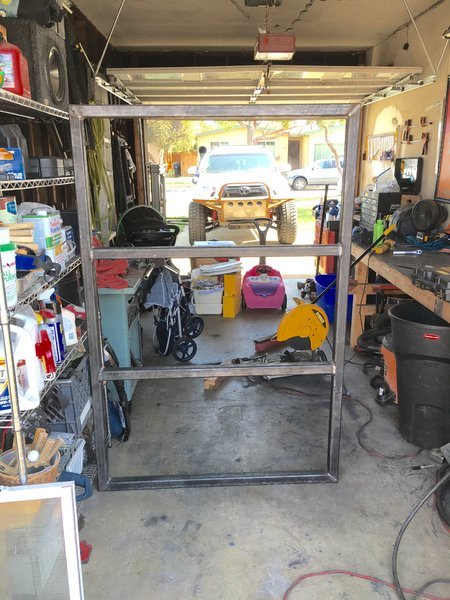

    Went and bought material to start the frame today. The frame is gonna be 2"x2" square tube 3/16" wall.

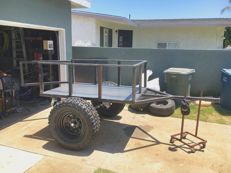

    Got home from the metal shop today and started cutting and welding together the frame. In the time that I had I got the box done. Now need to add tongue/triangulation to the front.

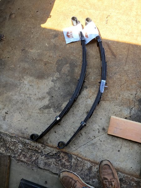

    Also my leaf springs got here already. Just ordered them yesterday!!! That was quick! o_O
