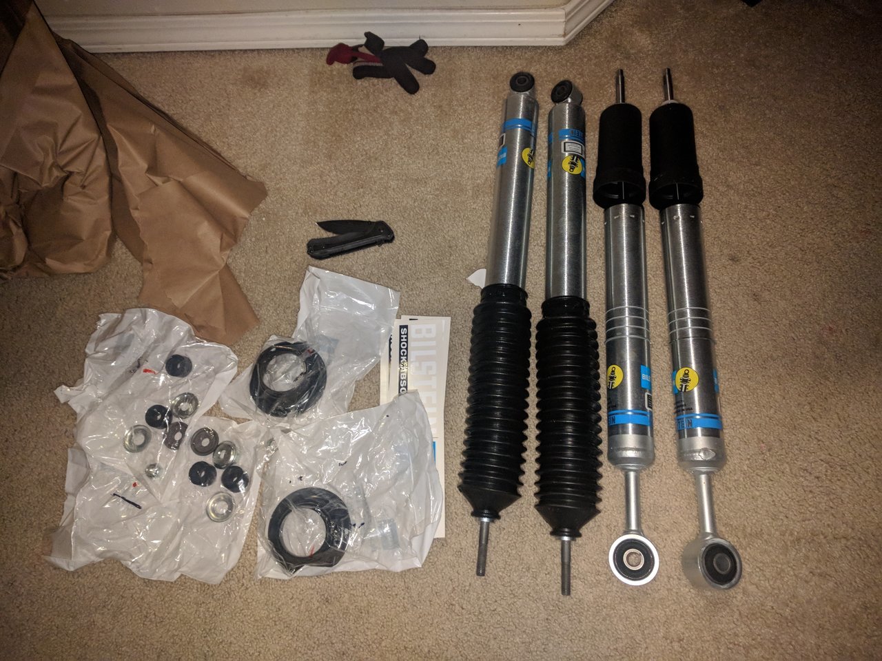

    Anyway, update on this, I found more threads that has this similar issue for anyone else looking.
    I'm wondering if my issue is similar to these, where its just the bottom piece incorrectly installed or missing.
    https://www.tacomaworld.com/threads/bilstein-5100-bushing-gap-clunk-help.291956/
    https://www.tacomaworld.com/threads/bilstein-5100s-top-nut-gap-issue.342789/
    I bought new Bilstein 5100 on eBay, and KYB shock mounts. Mine are currently set to the top level, so I'm looking to maintain the same height.

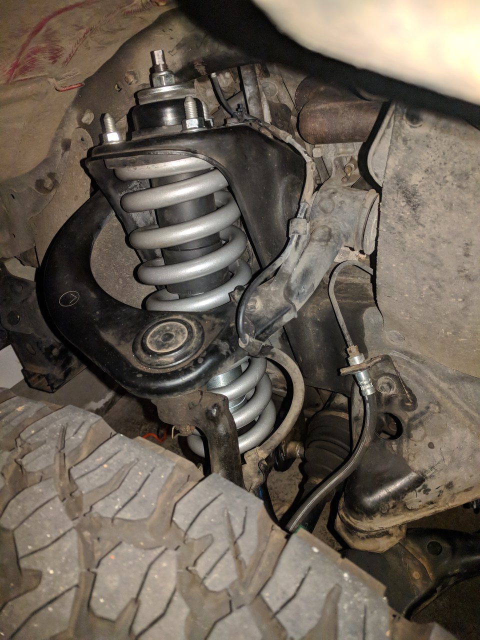

    I finally got around to fixing this, well almost. Using the instructions here and on YouTube for front shock replacements, I was partly able to complete this. Passenger side is completed.
    My passenger side's top shock mounts were TOAST. I'll attach a pic tomorrow. When I say toast, I mean :censored:. FYI, the shocks I had in the first pics are Bilstein 5100s. I also found out this truck has "spacers"? I think is what they call it. Removing it since I'm also installing Eibach coils, so the 5100s don't need to be adjusted.
    Doing the driver's side tomorrow, the top nut was stuck. I don't have a sawzall, and its only about 3-4 threads away from being off. Thinking of picking up a vicegrip tomorrow to try to get it. Then doing the rears tomorrow or the following day, and then an alignment.
    :fingerscrossed:

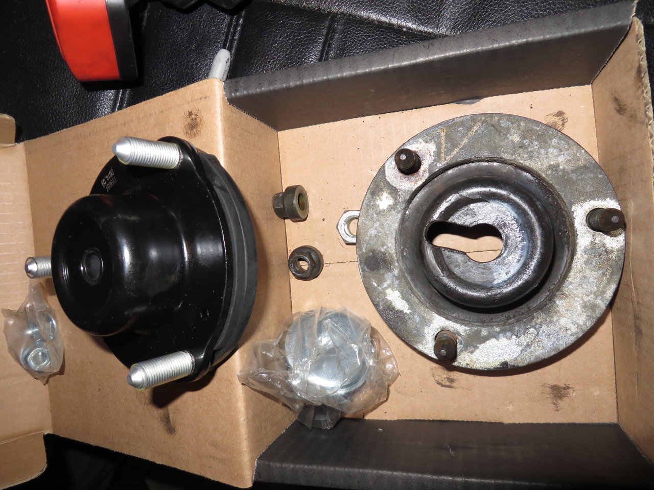

    Here is the front passenger side's top shock mount!
    Passenger side completed. If anyone sees anything weird, please let me know!
    Btw, what do you call those things attach to my rotors? I just thought those looked weird. Its used to support my wheels...
    REDdawn6 and eccracer104 like this.

    WOW those tophats were DONEZO!
    those ring spacers are for hubcentric ring spacers for your rims.
    Either way looks like you did a proper install!

    Finally installed. Had to go up instead of down and kept wiggling the LCA UP and down, and a lot more penetration spray.
    Is Firestone able to do alignment with wide wheels? Going to call tomorrow. Toyota said they'd scratch my wheels. I still need to put the front sway bars. Rushed it to Toyota and found my timing chain is leaking! (10/10 they say...)
    By the way, everything seemed to have costed under $700 and that was a full quote for all fronts without top mounts.
    I've never changed my brakes and only have done oil and differential fluid changes. This was a bit stressful but really awesome I did it and not die. I'm buying 6 ton jack stands next. When I was packing up the driver side, the other side dropped! Luckily I had the truck jack as stand by.
