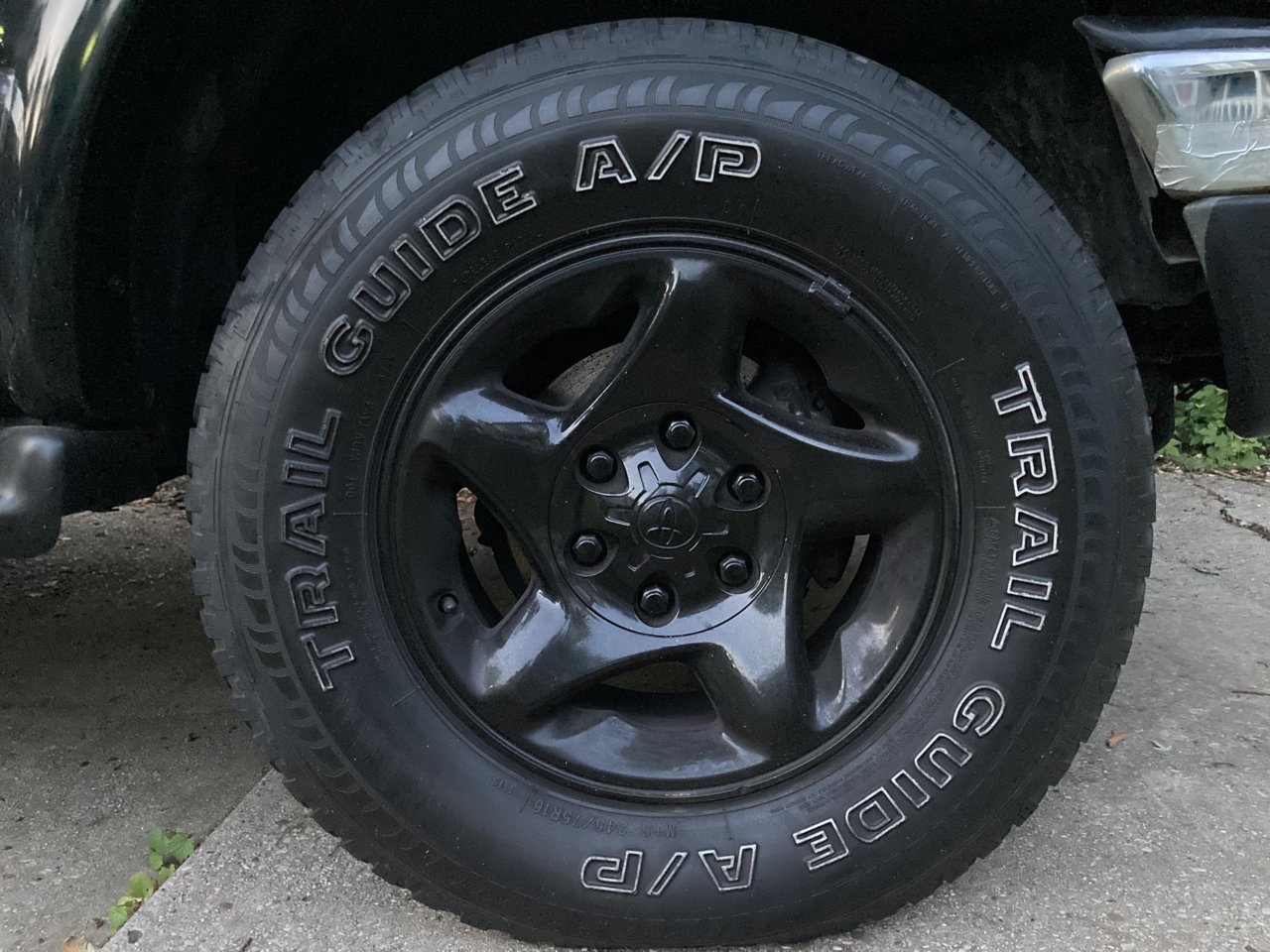

    Look at your wheels. Six lug nuts or five?

  10. Jun 6, 2023 at 3:55 PM
    Tsean
    Tsean [OP] Well-Known Member
    May 11, 2023
    #424436
    240
    Tsean
    it is 6 lugs here is the my tire pic passenger side wheel

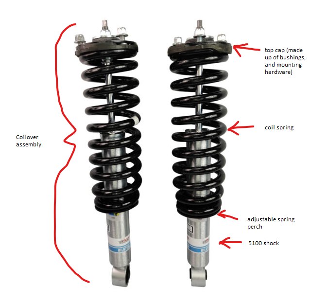

  16. Jun 7, 2023 at 8:22 AM
    #16
    Andy01DblCabTacoma
    Andy01DblCabTacoma Well-Known Member
    Mar 12, 2021
    #359086
    3,896
    Andy
    San Diego, CA
    01 Double Cab v6 4x4 TRD
    F: Kings SPC, R: 5100s+J59s. Custom armor.
    There are a few notable differences between the 4600 and 5100 series shocks. Mainly that the 5100 front shocks have three spring perch settings so you can lift the truck, and valving that is more suited to offroading. The 4600s are VERY close to what the TRD trucks rolled out of the factory with. If you're considering off roading then 5100 with OME 880s (coil springs) will give you a small lift (1.5"). Companies like Wheelers Offroad will even preassemble the coilover for you with a new top cap, so installation will be a breeze for the shop.
    You generally order brake parts in separate components. You order front rotors, front brake pads, rear drums, and rear shoes as individual parts.
